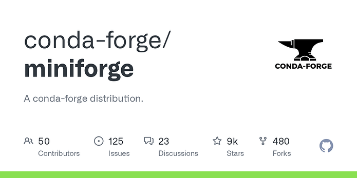

If you are using it for commercial purposes or in a business, I’d recommend miniforge. You could also use minconda, but just remember to set it to only use conda forge
I wrote a guide for how to setup miniconda a long time ago, but the instructions are the same for miniforge
