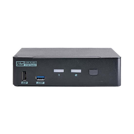

KVM Model:
USB-C KVM Switch v3 (with USB Power Delivery / 135watts
not sure, it is the usb c combiner

Oh nooo I’m so sorry you’re having trouble D:
What is the USBC switch you’re describing here? Also, do you have the spare power plugged into the combiner? Try putting the back switch into U3 mode for more bandwidth to the USBs…? Idk maybe the Presonus is a bandwidth hog…

https://www.amazon.com/gp/aw/d/B09MQ4N8KM?psc=1

systool -avm usbhid
Module = "usbhid"
  Attributes:
    uevent              = <store method only>
  Parameters:
    ignoreled           = "0"
    jspoll              = "0"
    kbpoll              = "0"
    mousepoll           = "0"
    quirks              = "(null),(null),(null),(null)"
This just has it for mouse/keyboard/joysticks
This causes my screen and USB to cut out on my mac and didn’t fix the crackling issues
I would email “wendell at level1techs dot com” for more support. I’m not sure what the issue is here.
dang even mods don’t get around the link rule. I’ll draft up a email. Can I cc you?
Oh no no we just do that so if someone scrapes the website they don’t just get wendell’s full email. Also yes of course my email is just “amber @ level1techs dot com”
@Level1_Amber it’s been a while, but after going back and forth with Wendell over email, I’m starting to suspect my 10ft USB C cable is the issue, as my USB keyboard and audio interface are disconnecting more frequently compared to my laptops (which have shorter cable runs).
https://www.amazon.com/gp/aw/d/B0874HH4ZZ?psc=1
If I were to get this cable, would it work with the USB C combiner and the KVM?
The page has the following
I would recommend a higher bandwidth option like this (it’s also cheaper for some reason?):
I think it’s cheaper because it is shorter. I wonder if the data transfer bandwidth is the source of all these issues
This can be a potential substitute, but 9.84 ft is a little tight oh wait both of my cables are 3M long, maybe it might work
@wendell @Level1_Amber based on the logs and chatgpt’s interpretation would you be able to simulate these two scenarios:
  1. 10gbs cable bandwidth (add synthetic throttle between a pc and the kvm
  2. simulate a usb device power draw > 5V
If you could do that, it would help me determine what to buy and test next to solve this issue
context for why those 2 scenarios

[    5.525638] usb 3-2.4: new high-speed USB device number 6 using xhci_hcd
[    5.637644] usb 3-2.4: New USB device found, idVendor=194f, idProduct=0109, bcdDevice= 1.17
[    5.637650] usb 3-2.4: New USB device strings: Mfr=1, Product=2, SerialNumber=3
[    5.637652] usb 3-2.4: Product: Studio 24c
[    5.637654] usb 3-2.4: Manufacturer: PreSonus
[    5.637656] usb 3-2.4: SerialNumber: SC1E21474611
[    5.676255] usb 1-5: New USB device found, idVendor=058f, idProduct=6364, bcdDevice= 1.00
[    5.676259] usb 1-5: New USB device strings: Mfr=1, Product=2, SerialNumber=3
[    5.676261] usb 1-5: Product: Mass Storage Device
[    5.676263] usb 1-5: Manufacturer: Generic
[    5.676265] usb 1-5: SerialNumber: 058F63646476
[    5.702288] usb 3-2.1.2: new full-speed USB device number 7 using xhci_hcd
[    5.811531] usb 3-2.1.2: New USB device found, idVendor=3434, idProduct=0220, bcdDevice= 1.00
[    5.811536] usb 3-2.1.2: New USB device strings: Mfr=1, Product=2, SerialNumber=0
[    5.811539] usb 3-2.1.2: Product: Keychron K2 Pro
[    5.811541] usb 3-2.1.2: Manufacturer: Keychron
[    5.863768] usb 1-8: new high-speed USB device number 5 using xhci_hcd
[    6.032308] usb 3-2.1.6: new full-speed USB device number 8 using xhci_hcd
[    6.080184] usb 1-8: New USB device found, idVendor=2109, idProduct=2822, bcdDevice= 7.83
[    6.080189] usb 1-8: New USB device strings: Mfr=1, Product=2, SerialNumber=3
[    6.080192] usb 1-8: Product: USB2.0 Hub
[    6.080194] usb 1-8: Manufacturer: VIA Labs, Inc.
[    6.080197] usb 1-8: SerialNumber: 000000001
[    6.080230] usb-storage 1-5:1.0: USB Mass Storage device detected
[    6.080406] scsi host8: usb-storage 1-5:1.0
[    6.080546] usbcore: registered new interface driver usb-storage
[    6.132518] usb 3-2.1.6: New USB device found, idVendor=09eb, idProduct=0131, bcdDevice= 0.02
[    6.132521] usb 3-2.1.6: New USB device strings: Mfr=1, Product=2, SerialNumber=3
[    6.132523] usb 3-2.1.6: Product: Virtual HID
[    6.132525] usb 3-2.1.6: Manufacturer: Generic
[    6.132526] usb 3-2.1.6: SerialNumber: 00000001
[    6.212605] usbcore: registered new interface driver usbhid
[    6.212607] usbhid: USB HID core driver
[    6.213677] input: Keychron Keychron Q1 HE as /devices/pci0000:00/0000:00:01.3/0000:03:00.0/usb1/1-1/1-1:1.0/0003:3434:0B10.0001/input/input0
[    6.226685] input: Generic Virtual HID as /devices/pci0000:00/0000:00:08.1/0000:2a:00.3/usb3/3-2/3-2.1/3-2.1.6/3-2.1.6:1.0/0003:09EB:0131.000F/input/input1
[    6.264363] hid-generic 0003:3434:0B10.0001: input,hidraw0: USB HID v1.11 Keyboard [Keychron Keychron Q1 HE] on usb-0000:03:00.0-1/input0
[    6.264498] hid-generic 0003:3434:0B10.0002: hiddev96,hidraw1: USB HID v1.11 Device [Keychron Keychron Q1 HE] on usb-0000:03:00.0-1/input1
[    6.264660] input: Keychron Keychron Q1 HE Mouse as /devices/pci0000:00/0000:00:01.3/0000:03:00.0/usb1/1-1/1-1:1.2/0003:3434:0B10.0003/input/input2
[    6.315349] hid-generic 0003:09EB:0131.000F: input,hidraw2: USB HID v1.10 Keyboard [Generic Virtual HID] on usb-0000:2a:00.3-2.1.6/input0
[    6.315366] input: Keychron Keychron Q1 HE as /devices/pci0000:00/0000:00:01.3/0000:03:00.0/usb1/1-1/1-1:1.2/0003:3434:0B10.0003/input/input3
[    6.315421] input: Keychron Keychron Q1 HE System Control as /devices/pci0000:00/0000:00:01.3/0000:03:00.0/usb1/1-1/1-1:1.2/0003:3434:0B10.0003/input/input4
[    6.323725] input: Generic Virtual HID Mouse as /devices/pci0000:00/0000:00:08.1/0000:2a:00.3/usb3/3-2/3-2.1/3-2.1.6/3-2.1.6:1.1/0003:09EB:0131.0010/input/input7
[    6.341299] usb 1-9: new full-speed USB device number 6 using xhci_hcd
[    6.366364] input: Keychron Keychron Q1 HE Consumer Control as /devices/pci0000:00/0000:00:01.3/0000:03:00.0/usb1/1-1/1-1:1.2/0003:3434:0B10.0003/input/input5
[    6.366391] input: Generic Virtual HID System Control as /devices/pci0000:00/0000:00:08.1/0000:2a:00.3/usb3/3-2/3-2.1/3-2.1.6/3-2.1.6:1.1/0003:09EB:0131.0010/input/input8
[    6.366411] input: Keychron Keychron Q1 HE Keyboard as /devices/pci0000:00/0000:00:01.3/0000:03:00.0/usb1/1-1/1-1:1.2/0003:3434:0B10.0003/input/input6
[    6.418565] input: Generic Virtual HID Consumer Control as /devices/pci0000:00/0000:00:08.1/0000:2a:00.3/usb3/3-2/3-2.1/3-2.1.6/3-2.1.6:1.1/0003:09EB:0131.0010/input/input9
[    6.418610] hid-generic 0003:3434:0B10.0003: input,hidraw3: USB HID v1.11 Mouse [Keychron Keychron Q1 HE] on usb-0000:03:00.0-1/input2
[    6.418631] hid-generic 0003:09EB:0131.0010: input,hidraw4: USB HID v1.10 Mouse [Generic Virtual HID] on usb-0000:2a:00.3-2.1.6/input1
[    6.418736] input: Logitech USB Receiver as /devices/pci0000:00/0000:00:01.3/0000:03:00.0/usb1/1-4/1-4:1.0/0003:046D:C52B.0004/input/input10
[    6.469345] hid-generic 0003:046D:C52B.0004: input,hidraw5: USB HID v1.11 Keyboard [Logitech USB Receiver] on usb-0000:03:00.0-4/input0
[    6.469500] input: Logitech USB Receiver Mouse as /devices/pci0000:00/0000:00:01.3/0000:03:00.0/usb1/1-4/1-4:1.1/0003:046D:C52B.0005/input/input11
[    6.469562] input: Logitech USB Receiver Consumer Control as /devices/pci0000:00/0000:00:01.3/0000:03:00.0/usb1/1-4/1-4:1.1/0003:046D:C52B.0005/input/input12
[    6.521327] input: Logitech USB Receiver System Control as /devices/pci0000:00/0000:00:01.3/0000:03:00.0/usb1/1-4/1-4:1.1/0003:046D:C52B.0005/input/input13
[    6.521404] hid-generic 0003:046D:C52B.0005: input,hiddev97,hidraw6: USB HID v1.11 Mouse [Logitech USB Receiver] on usb-0000:03:00.0-4/input1
[    6.521530] hid-generic 0003:046D:C52B.0006: hiddev98,hidraw7: USB HID v1.11 Device [Logitech USB Receiver] on usb-0000:03:00.0-4/input2
[    6.521644] input: Logitech USB Receiver as /devices/pci0000:00/0000:00:08.1/0000:2a:00.3/usb3/3-2/3-2.2/3-2.2:1.0/0003:046D:C52B.0007/input/input15
[    6.573331] hid-generic 0003:046D:C52B.0007: input,hidraw8: USB HID v1.11 Keyboard [Logitech USB Receiver] on usb-0000:2a:00.3-2.2/input0
[    6.573481] input: Logitech USB Receiver Mouse as /devices/pci0000:00/0000:00:08.1/0000:2a:00.3/usb3/3-2/3-2.2/3-2.2:1.1/0003:046D:C52B.0008/input/input16
[    6.573539] input: Logitech USB Receiver Consumer Control as /devices/pci0000:00/0000:00:08.1/0000:2a:00.3/usb3/3-2/3-2.2/3-2.2:1.1/0003:046D:C52B.0008/input/input17
[    6.624740] input: Logitech USB Receiver System Control as /devices/pci0000:00/0000:00:08.1/0000:2a:00.3/usb3/3-2/3-2.2/3-2.2:1.1/0003:046D:C52B.0008/input/input18
[    6.624880] hid-generic 0003:046D:C52B.0008: input,hiddev99,hidraw9: USB HID v1.11 Mouse [Logitech USB Receiver] on usb-0000:2a:00.3-2.2/input1
[    6.625068] hid-generic 0003:046D:C52B.0009: hiddev100,hidraw10: USB HID v1.11 Device [Logitech USB Receiver] on usb-0000:2a:00.3-2.2/input2
[    6.625165] input: C-Media Electronics Inc. USB Audio Device as /devices/pci0000:00/0000:00:08.1/0000:2a:00.3/usb3/3-2/3-2.1/3-2.1.1/3-2.1.1:1.3/0003:0D8C:0016.000A/input/input20
[    6.675757] hid-generic 0003:0D8C:0016.000A: input,hidraw11: USB HID v1.00 Device [C-Media Electronics Inc. USB Audio Device] on usb-0000:2a:00.3-2.1.1/input3
[    6.675911] hid-generic 0003:058F:6364.000B: hiddev101,hidraw12: USB HID v1.10 Device [Generic Mass Storage Device] on usb-0000:03:00.0-5/input1
[    6.676067] input: Keychron Keychron K2 Pro as /devices/pci0000:00/0000:00:08.1/0000:2a:00.3/usb3/3-2/3-2.1/3-2.1.2/3-2.1.2:1.0/0003:3434:0220.000C/input/input21
[    6.726533] hid-generic 0003:3434:0220.000C: input,hidraw13: USB HID v1.11 Keyboard [Keychron Keychron K2 Pro] on usb-0000:2a:00.3-2.1.2/input0
[    6.726693] hid-generic 0003:3434:0220.000D: hiddev102,hidraw14: USB HID v1.11 Device [Keychron Keychron K2 Pro] on usb-0000:2a:00.3-2.1.2/input1
[    6.726859] input: Keychron Keychron K2 Pro Mouse as /devices/pci0000:00/0000:00:08.1/0000:2a:00.3/usb3/3-2/3-2.1/3-2.1.2/3-2.1.2:1.2/0003:3434:0220.000E/input/input22
[    6.726899] input: Keychron Keychron K2 Pro System Control as /devices/pci0000:00/0000:00:08.1/0000:2a:00.3/usb3/3-2/3-2.1/3-2.1.2/3-2.1.2:1.2/0003:3434:0220.000E/input/input23
[    6.775638] usb 1-8.2: new high-speed USB device number 7 using xhci_hcd
[    6.777463] input: Keychron Keychron K2 Pro Consumer Control as /devices/pci0000:00/0000:00:08.1/0000:2a:00.3/usb3/3-2/3-2.1/3-2.1.2/3-2.1.2:1.2/0003:3434:0220.000E/input/input24
[    6.777513] input: Keychron Keychron K2 Pro Keyboard as /devices/pci0000:00/0000:00:08.1/0000:2a:00.3/usb3/3-2/3-2.1/3-2.1.2/3-2.1.2:1.2/0003:3434:0220.000E/input/input25
[    6.777639] hid-generic 0003:3434:0220.000E: input,hidraw15: USB HID v1.11 Mouse [Keychron Keychron K2 Pro] on usb-0000:2a:00.3-2.1.2/input2
[    6.818687] logitech-djreceiver 0003:046D:C52B.0006: hiddev97,hidraw5: USB HID v1.11 Device [Logitech USB Receiver] on usb-0000:03:00.0-4/input2
[    6.925239] input: Logitech Wireless Device PID:404d Keyboard as /devices/pci0000:00/0000:00:01.3/0000:03:00.0/usb1/1-4/1-4:1.2/0003:046D:C52B.0006/0003:046D:404D.0011/input/input26
[    6.940371] input: Logitech Wireless Device PID:404d Mouse as /devices/pci0000:00/0000:00:01.3/0000:03:00.0/usb1/1-4/1-4:1.2/0003:046D:C52B.0006/0003:046D:404D.0011/input/input27
[    6.940479] hid-generic 0003:046D:404D.0011: input,hidraw6: USB HID v1.11 Keyboard [Logitech Wireless Device PID:404d] on usb-0000:03:00.0-4/input2:1
[    6.944097] usb 1-9: New USB device found, idVendor=041e, idProduct=323b, bcdDevice=10.04
[    6.944102] usb 1-9: New USB device strings: Mfr=1, Product=2, SerialNumber=3
[    6.944104] usb 1-9: Product: Sound Blaster E1
[    6.944106] usb 1-9: Manufacturer: Creative Technology Ltd
[    6.944108] usb 1-9: SerialNumber: 0000022171
[    6.947275] usb 1-8.2: New USB device found, idVendor=04b4, idProduct=6506, bcdDevice=50.00
[    6.947286] usb 1-8.2: New USB device strings: Mfr=1, Product=2, SerialNumber=3
[    6.947288] usb 1-8.2: Product: HP Windows Mixed Reality
[    6.947290] usb 1-8.2: Manufacturer: HP Inc.
[    6.947291] usb 1-8.2: SerialNumber: 3267AFFA77EE5478B7398E5FE3E3BA9D
[    6.966697] logitech-djreceiver 0003:046D:C52B.0009: hiddev98,hidraw7: USB HID v1.11 Device [Logitech USB Receiver] on usb-0000:2a:00.3-2.2/input2
[    7.021063] input: Creative Technology Ltd Sound Blaster E1 as /devices/pci0000:00/0000:00:01.3/0000:03:00.0/usb1/1-9/1-9:1.3/0003:041E:323B.0012/input/input32
[    7.071469] hid-generic 0003:041E:323B.0012: input,hiddev99,hidraw8: USB HID v1.00 Device [Creative Technology Ltd Sound Blaster E1] on usb-0000:03:00.0-9/input3
[    7.072029] input: Logitech Wireless Device PID:407b Keyboard as /devices/pci0000:00/0000:00:08.1/0000:2a:00.3/usb3/3-2/3-2.2/3-2.2:1.2/0003:046D:C52B.0009/0003:046D:407B.0013/input/input33
[    7.072068] input: Logitech Wireless Device PID:407b Mouse as /devices/pci0000:00/0000:00:08.1/0000:2a:00.3/usb3/3-2/3-2.2/3-2.2:1.2/0003:046D:C52B.0009/0003:046D:407B.0013/input/input34
[    7.072115] hid-generic 0003:046D:407B.0013: input,hidraw9: USB HID v1.11 Keyboard [Logitech Wireless Device PID:407b] on usb-0000:2a:00.3-2.2/input2:1
[    7.096945] input: Logitech K400 Plus as /devices/pci0000:00/0000:00:01.3/0000:03:00.0/usb1/1-4/1-4:1.2/0003:046D:C52B.0006/0003:046D:404D.0011/input/input38
[    7.096991] logitech-hidpp-device 0003:046D:404D.0011: input,hidraw6: USB HID v1.11 Keyboard [Logitech K400 Plus] on usb-0000:03:00.0-4/input2:1
[    7.117885] input: Logitech MX Vertical as /devices/pci0000:00/0000:00:08.1/0000:2a:00.3/usb3/3-2/3-2.2/3-2.2:1.2/0003:046D:C52B.0009/0003:046D:407B.0013/input/input39
[    7.117924] logitech-hidpp-device 0003:046D:407B.0013: input,hidraw9: USB HID v1.11 Keyboard [Logitech MX Vertical] on usb-0000:2a:00.3-2.2/input2:1
[    7.246284] usb 1-10: new full-speed USB device number 8 using xhci_hcd
[    7.582287] usb 1-8.2.1: new high-speed USB device number 9 using xhci_hcd
[    7.608857] usb 1-10: New USB device found, idVendor=8087, idProduct=0a2b, bcdDevice= 0.01
[    7.608861] usb 1-10: New USB device strings: Mfr=0, Product=0, SerialNumber=0
[    7.753350] usb 1-8.2.1: config 1 has an invalid interface number: 3 but max is 2
[    7.753354] usb 1-8.2.1: config 1 has an invalid interface number: 4 but max is 2
[    7.753356] usb 1-8.2.1: config 1 has no interface number 0
[    7.753358] usb 1-8.2.1: config 1 has no interface number 1
[    7.802370] usb 1-8.2.1: New USB device found, idVendor=045e, idProduct=0659, bcdDevice= 0.0b
[    7.802374] usb 1-8.2.1: New USB device strings: Mfr=1, Product=2, SerialNumber=3
[    7.802377] usb 1-8.2.1: Product: HoloLens Sensors
[    7.802379] usb 1-8.2.1: Manufacturer: Microsoft
[    7.802381] usb 1-8.2.1: SerialNumber: adb06517-300e-478b-9d5d-e528d65a34c9
[    7.893161] hid-generic 0003:045E:0659.0014: hiddev100,hidraw10: USB HID v11.10 Device [Microsoft HoloLens Sensors] on usb-0000:03:00.0-8.2.1/input2
[    7.964296] usb 1-8.2.2: new high-speed USB device number 10 using xhci_hcd
[    8.331272] usbcore: registered new interface driver uas
[    8.423422] usbcore: registered new device driver onboard-usb-dev
[    8.841843] usb 3-2.4: Quirk or no altset; falling back to MIDI 1.0
[    8.860461] usbcore: registered new interface driver btusb
[    9.203261] usbcore: registered new interface driver snd-usb-audio
[    9.638570] usb 1-8.2.2: New USB device found, idVendor=0bda, idProduct=4c15, bcdDevice= 0.15
[    9.638574] usb 1-8.2.2: New USB device strings: Mfr=3, Product=1, SerialNumber=0
[    9.638576] usb 1-8.2.2: Product: USB Audio
[    9.638577] usb 1-8.2.2: Manufacturer: Generic
[    9.938593] usb 1-8.2.2: Warning! Unlikely big volume range (=799), cval->res is probably wrong.
[    9.938597] usb 1-8.2.2: [22] FU [PCM Playback Volume] ch = 2, val = -25600/-1/32
[    9.954816] input: Generic USB Audio Consumer Control as /devices/pci0000:00/0000:00:01.3/0000:03:00.0/usb1/1-8/1-8.2/1-8.2.2/1-8.2.2:1.3/0003:0BDA:4C15.0015/input/input54
[   10.005377] input: Generic USB Audio as /devices/pci0000:00/0000:00:01.3/0000:03:00.0/usb1/1-8/1-8.2/1-8.2.2/1-8.2.2:1.3/0003:0BDA:4C15.0015/input/input55
[   10.005470] hid-generic 0003:0BDA:4C15.0015: input,hiddev103,hidraw16: USB HID v1.11 Device [Generic USB Audio] on usb-0000:03:00.0-8.2.2/input3
[   10.075289] usb 1-8.2.3: new full-speed USB device number 11 using xhci_hcd
[   10.372640] usb 1-8.2.3: New USB device found, idVendor=03f0, idProduct=0580, bcdDevice= 2.00
[   10.372645] usb 1-8.2.3: New USB device strings: Mfr=1, Product=2, SerialNumber=3
[   10.372648] usb 1-8.2.3: Product: QHMD A85V
[   10.372650] usb 1-8.2.3: Manufacturer: Quanta Inc.
[   10.372652] usb 1-8.2.3: SerialNumber: 8CC220Z054
[   10.422928] hid-generic 0003:03F0:0580.0016: hiddev104,hidraw17: USB HID v1.11 Device [Quanta Inc. QHMD A85V] on usb-0000:03:00.0-8.2.3/input0
[ 2867.018931] usb usb1: root hub lost power or was reset
[ 2867.018933] usb usb2: root hub lost power or was reset
[ 2867.396667] usb 1-5: reset high-speed USB device number 4 using xhci_hcd
[ 2867.435716] usb 3-2.1.6: reset full-speed USB device number 8 using xhci_hcd
[ 2867.586435] usb 1-10: WARN: invalid context state for evaluate context command.
[ 2867.758830] usb 1-10: reset full-speed USB device number 8 using xhci_hcd
[ 2868.028663] usb 1-4: WARN: invalid context state for evaluate context command.
[ 2868.202120] usb 1-4: reset full-speed USB device number 3 using xhci_hcd
[ 2868.471742] usb 1-1: WARN: invalid context state for evaluate context command.
[ 2868.645144] usb 1-1: reset full-speed USB device number 2 using xhci_hcd
[ 2868.914777] usb 1-9: WARN: invalid context state for evaluate context command.
[ 2869.088083] usb 1-9: reset full-speed USB device number 6 using xhci_hcd
[ 2869.549149] usb 1-8: reset high-speed USB device number 5 using xhci_hcd
[ 2870.434189] usb 1-8.2: reset high-speed USB device number 7 using xhci_hcd
[ 2870.912159] usb 1-8.2.1: reset high-speed USB device number 9 using xhci_hcd
[ 2871.043229] usb 1-8.2.3: WARN: invalid context state for evaluate context command.
[ 2871.139177] usb 1-8.2.3: reset full-speed USB device number 11 using xhci_hcd
[ 2871.399232] usb 1-8.2.2: reset high-speed USB device number 10 using xhci_hcd
[ 2873.077767] usb 3-2.2: USB disconnect, device number 4
[ 2873.196010] usb 3-2.4: USB disconnect, device number 6
[ 2895.992894] usb 3-2.2: new full-speed USB device number 9 using xhci_hcd
[ 2896.113034] usb 3-2.2: New USB device found, idVendor=046d, idProduct=c52b, bcdDevice=24.11
[ 2896.113038] usb 3-2.2: New USB device strings: Mfr=1, Product=2, SerialNumber=0
[ 2896.113041] usb 3-2.2: Product: USB Receiver
[ 2896.113043] usb 3-2.2: Manufacturer: Logitech
[ 2896.254238] logitech-djreceiver 0003:046D:C52B.0019: hiddev98,hidraw7: USB HID v1.11 Device [Logitech USB Receiver] on usb-0000:2a:00.3-2.2/input2
[ 2896.367422] input: Logitech MX Vertical as /devices/pci0000:00/0000:00:08.1/0000:2a:00.3/usb3/3-2/3-2.2/3-2.2:1.2/0003:046D:C52B.0019/0003:046D:407B.001A/input/input56
[ 2896.407960] logitech-hidpp-device 0003:046D:407B.001A: input,hidraw9: USB HID v1.11 Keyboard [Logitech MX Vertical] on usb-0000:2a:00.3-2.2/input2:1
[ 2896.559918] usb 3-2.4: new high-speed USB device number 10 using xhci_hcd
[ 2896.659396] usb 3-2.4: New USB device found, idVendor=194f, idProduct=0109, bcdDevice= 1.17
[ 2896.659401] usb 3-2.4: New USB device strings: Mfr=1, Product=2, SerialNumber=3
[ 2896.659403] usb 3-2.4: Product: Studio 24c
[ 2896.659405] usb 3-2.4: Manufacturer: PreSonus
[ 2896.659407] usb 3-2.4: SerialNumber: SC1E21474611
[ 2896.780298] usb 3-2.4: Quirk or no altset; falling back to MIDI 1.0
chatgpt thinks it’s either the logitech mx vertical or the presonus. I think it might be the cable because while I am in desktop, my usb devices disconnect but the display doesn’t cut out.
To debug further, chatgpt suggested inspecting the output of lsusb -t

hypothesis #1 it’s a cable bandwidth issue
I asked chatgpt to give me the commands to parse the logs if I could trace it back to the cable being rated for USB C 3.1 Gen 2 10Gbps Data Transfer.
It suggested I run sudo dmesg -T | grep -E "usb|xhci|hub|SuperSpeed|link"

hypothesis #2 the presonus is drawing more than the kvm can deliver
chatgpt suggested I run the following commands
sudo grep . /sys/bus/usb/devices/3-2.4/{bMaxPower,bConfigurationValue,bNumConfigurations,power/*}
sudo grep -H . /sys/bus/usb/devices/*/bMaxPower
sudo grep . /sys/bus/usb/devices/3-2.4/power/*
kernel view of presonus

@Level1_Amber, I tried with the club3d cable
Club 3D CAC-1579 USB4 Gen3x2 Type C to Type C Bi-Directional Cable with 240W Charging, 40Gbps Data Transmission and Supports 8K60Hz Video with Retimer IC 3m-9.84ft
I can’t get a shorter higher bandwidth cable because my desktop is physically 9ft from my kvm :frowning: .
I tried it in all configurations between the Combiner:KVM (U3:U3, U2:U2, U3:U2, U2:U3). The crackling still occurred in all configurations
I don’t think the usb switch is the issue as when I connected my laptop to the switch and interface in this config:
laptop → usb switch → presonus 24c
there was no crackling in the audio.
Is L1 going to make a new higher bandwidth usb c combiner that can do U3 with display and usb?
Sorry you’re having so much trouble here, I’m not sure what alls going on. Were you wanting an RMA, etc…?
The combiner should be U3? Weird. We do not have any new combiners coming up that I know about.
I just realized I didn’t reply back to Wendell’s email, let me email him logs from today’s tests.
I meant U3 full display and USB 3 speeds. Right now lsusb -t reports that the kvm is running at usb 2

When I view usbtop and look at bus id3 (the kvm), device 16 (Logitech, Inc. Unifying Receiver), has the slowest followed by device 17 ( Keychron Keychron K2 Pro)
lsusb
Bus 003 Device 001: ID 1d6b:0002 Linux Foundation 2.0 root hub
Bus 003 Device 003: ID 05e3:0610 Genesys Logic, Inc. Hub
Bus 003 Device 006: ID 09ea:0130 Generic Virtual HUB
Bus 003 Device 010: ID 0d8c:0016 C-Media Electronics, Inc. USB Audio Device
Bus 003 Device 011: ID 194f:0109 PreSonus Audio Electronics, Inc. Studio 24c
Bus 003 Device 014: ID 09eb:0131 IM Networks, Inc. Virtual HID
Bus 003 Device 016: ID 046d:c52b Logitech, Inc. Unifying Receiver
Bus 003 Device 017: ID 3434:0220 Keychron Keychron K2 Pro
Bus 004 Device 001: ID 1d6b:0003 Linux Foundation 3.0 root hub
usbtop
Bus ID 3 (Raw USB traffic, bus number 3)	To device	From device
  Device ID 11 :			722.92 kb/s	1005.96 kb/s
  Device ID 14 :			0.00 kb/s	0.00 kb/s
  Device ID 16 :			6.38 kb/s	7.87 kb/s
  Device ID 17 :			0.00 kb/s	0.00 kb/s
full usb top output
full usb top
