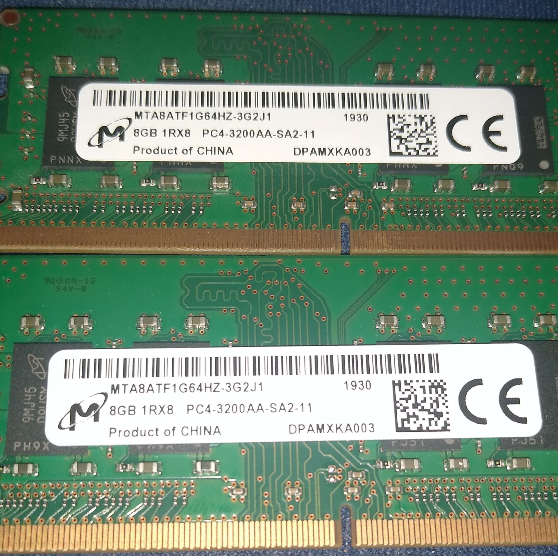

Unfortunately a decade old motherboard of DDR3 era Desktop in my family died, and needs to be rebuilt or replaced, on a budget of “as little as possible”.
I got disused a 2x8gig kit of laptop DDr4 3200 and a SATA SSD, that I think could be used to to cut costs dramatically. I also have a Zen 1 1600 AM4 processer, but not supported in 5XX chispets. I’ve got disused cases and power supplies too. Basically I need a motherboard , some form of GPU, or barebones system.
So here is my ideas
1st, buy a bare bones system to put the existing SSD and RAM into, I really like the AYANEO AM01 mini since it has space for both a SATA and NVME storage and the processor looks great. I like it so much that I’m capping the cost of the project to to not exceed the cost of the AM01. But I’m open for suggestions for a barebones system.
2nd buy a (probably used/refurbished) motherboard compatible with a Zen 1 cpu, a GPU (RX6400? Intel? ), and 260pin to 288 pin adapters for the RAM. If anyone has first hand experience with ddr4 260 pin to 288 pin adapters? I’d like to hear about it. I’m think this path could become a money pit, and even low end GPU are getting scalped now.
3rd, buy a motherboard with an embedded processor/gpu. This would solve the GPU/CPU problem, I just don’t want a pentium/celercon/N nas/router board.
Constructive suggestions or comments are welcome.

No personal experience with sodimm adapters but "The greatest technician that ever lived” on YouTube has and it basically was fine for him

Long story short, the cost of things has become major issue for me and especially my extended family member who needs their computer fixed. An Ayano AM01 barebones mini system has an 5825U APU and had DDR4 sodimm slots (sorry not allowed to post a link) iss about $320 (on amazon) and it does everything I need, so if the cost of motherboard/cpu/gpu exceeds $320, I’ll just get the AM01 instead.
I agree that the most recent architecture is the best path over all. But I’ve already got anexisting SATA SSD (upgraded in 2025 when prices were down) AND this existing kit of DDR4 on my shelf
and it the users just needs to pay bills and read email.

I will assume that you can flip that R5 1600 for $30. This will make your budget $350, a nice round number. You’re not saying if this system will be used for anything like gaming, but from your posts it seems to me that performance is not that important.
Getting a CPU with integrated graphics is a good idea. Ryzen 5 5500GT/5600GT are still available (between $150-$200). You can buy a new AM4 board with A520 or B550 chipset for $100 or so. 520’s cost generally less than $100. Check their features before buying of course. So for around $275 you have your processor, cooler, graphics and mainboard settled. You can now use adapters to use your so-dimms with the new board. They generally work, but that’s not a guarantee.If they don’t work, you should still have around $100 plus what you can get for the so-dimms. You should be able to get a 2x8 DDR4 kit for that if it comes to that.

yeah, I already own a 2x8gig kit of ram. It’s why I started this thread :laughing:
Yes and you’ve said they were so-dimms (laptop type dimms). That’s why I wrote that if the adapters don’t work, you will still have a budget left to get 288-pin DDR4 dimms.
Good luck with your project
Sorry, That is actually the big worry that had me start this thread. I really don’t want to be in the situation where I have to buy more ram.
