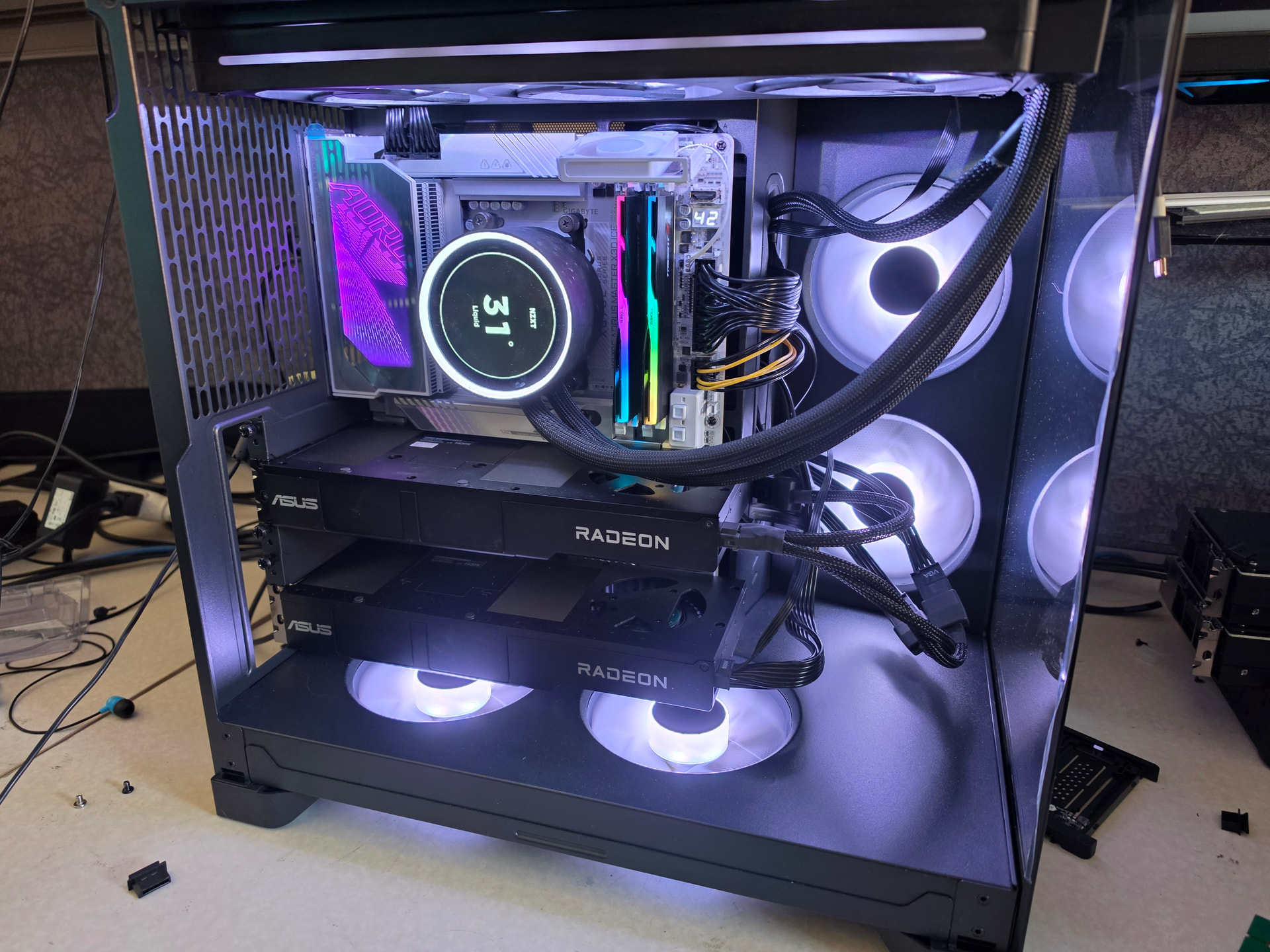

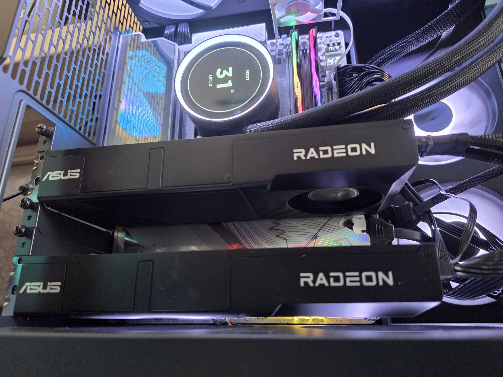

This is a step-by-step for a two-card AMD Radeon AI PRO R9700 host. By the end you will have a local OpenAI-compatible server running Qwen3.8-27B dense in MXFP4 with speculative decoding, and you will have run a real end-to-end coding benchmark (a Breakout clone from a 4,500-word spec) to prove it works. Everything here was run twice: once on my main box and once on a second, freshly set up 2x R9700 machine to make sure the steps actually replicate.
The short version of why this stack is fast: the R9700 has more compute than it can feed from its 32 GB of GDDR6, so the whole game is shrinking the bytes that move per token and getting more tokens out of each pass. MXFP4 quantization halves the weight bytes, a DFlash2 drafter gets ~3-4 accepted tokens per forward pass, and the radiance kernel stack keeps everything on the card’s own memory bus instead of crossing PCIe. Same model on llama.cpp or stock FP8 runs 17-23 tok/s single-stream; this config runs 150-200-280.
What you need
  • 2x AMD Radeon AI PRO R9700 (32 GB, gfx1201/RDNA4). One card works too (TP1, smaller context);
