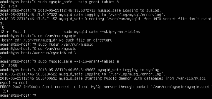

I (a linux newb) have installed a ubuntu server 18.04 LTS. I installed LAMP-Stack (with this guide) and vsftpd (with this guide). FTP, apache and PHP work perfectly. I have executed mysql_secure_installation But I want to import a .sql file (located in /www/html because I uploaded it via FTP) but I cannot import it because I don’t have the root pw. I wan’t to reset the root pw but when i start the mysql service with # mysqld --skip-grant-tables & or # mysqld_safe --skip-grant-tables & i get the following error:
It appears to be some error with sockets…? Output of # service mysql status:
Is anyone able to help me here? I can provide logs, but please instruct how to get them as I am noob

It looks like the path doesn’t exist.
Try creating it and restarting the service.
Also, if this is your Ubuntu instance you can do sudo passwd to set the root password after entering your users password.
Thanks for the quick reply. By ‘the path’ do you mean the one cited in the error: /var/run/mysqld? I created the path with # mkdir /var/run/mysqld/ and ran # mysqld_safe --skip-grant-tables & again but it stays at this line:
sudo chown mysql.mysql /var/run/mysqld
If that doesn’t work check the errorlog.

Now it doens’t go past this line:
That means it’s working, dude. Log-in and change the root password.
