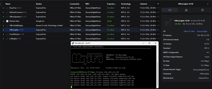

I’m about as far back as i can go and still facing issues, after a hard reboot the below is the outcome.
At this point I’m questioning if i have a dud access point

Wild update, when i set the channel to 6 all of the issues went away, but this leaves more questions then answers, i cant see anything saying that ESP32 does not support channel 11
I have 50+ ESP32/ESP8266 devices on my MiktoTik running channel 11. If they had an issue with channel 11, I am sure I would see it.
I noticed a note that says many wifi 4 IoT devices dont like other channels besides 6. IDK why, it is what it is. Maybe it is something specific to the Qualcomm chipsets inside the U7 access points?
