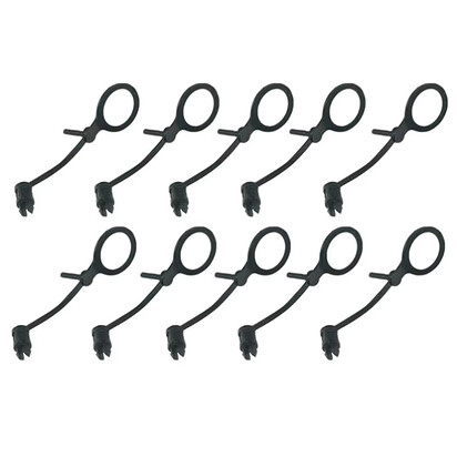

I have a Tyan S8030GM2NE motherboard that I got from Ebay. The mounting hardware for the M.2 drives appears to not be what came with the motherboard from the factory. The mounting hardware I received barely holds the M.2 drives and they are now falling out if anything bumps the server. They look like flimsy dark plastic pushpin holders. These do not stay firm inside the mounting holes on the motherboard. Does anyone know where I can buy the original mounting hardware for this motherboard to hold in the M.2 drives? Thanks in advance for any assistance.
Curious, do they look like this?
This is a picture of what they look like:
Oh, yeah those are Asus M.2 anchors I think. Or a knockoff of said.

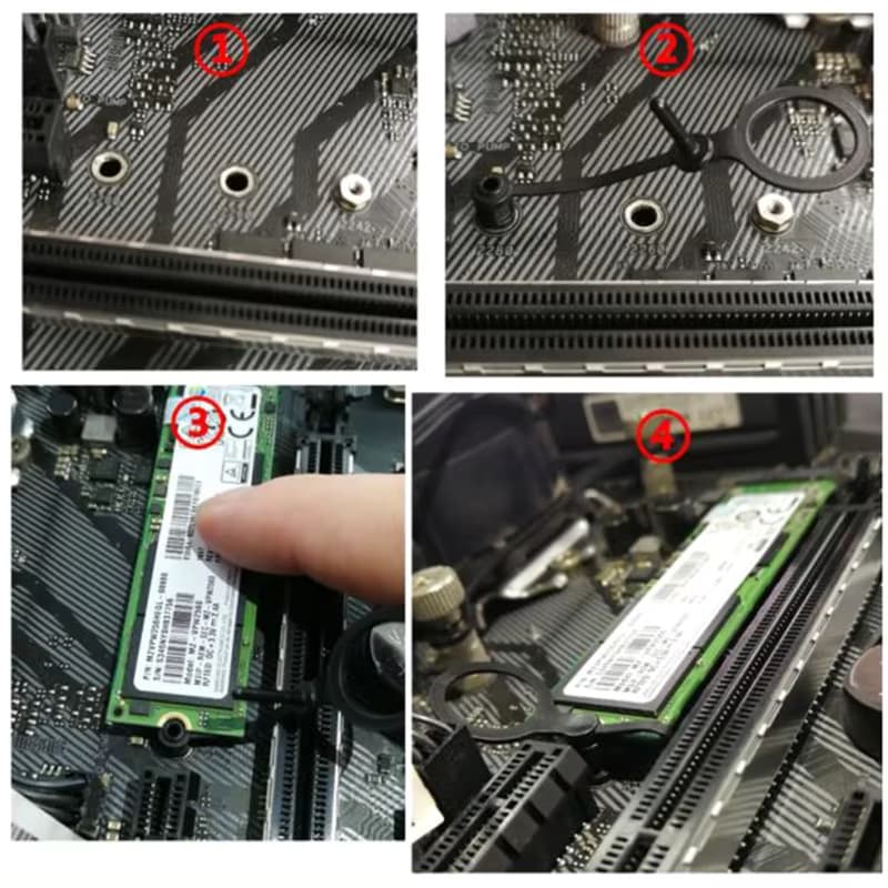

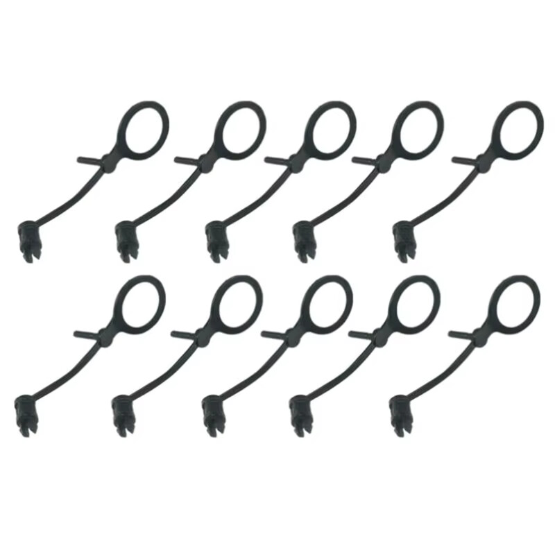

I found this topic searching for the same answer. After a bit of search, I ordered these from AliExpress.
/item/3256803160638969.html
It was the perfect fit.
The name of the product, in case it’s url changes
10Pcs M.2 Nylon fastener Anchor for -Asus H310 B360 B365 H410 Motherboard Hand Tool
These ones?
