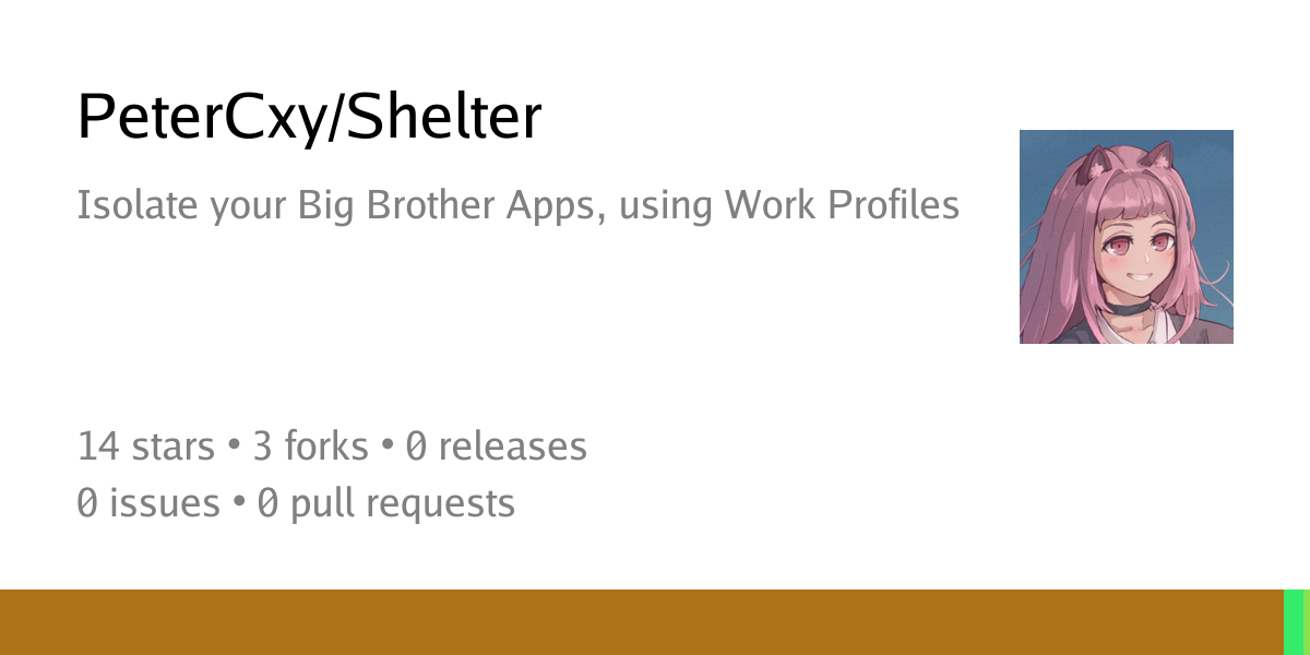

I switched to aurora store. To reduce the amount apps track, I use shelter (work profile sandbox for gmail and gmaps) and netguard (firewall)
Do the profiles require like the equivalent of logging out from a desktop and relogging to the sandboxed account? I have seen something like this but even though the switch is reasonably quick, will I get notifications from the default profile? Can you run the sandbox concurrent with your default profile?
Work profile doesn’t require relogin
