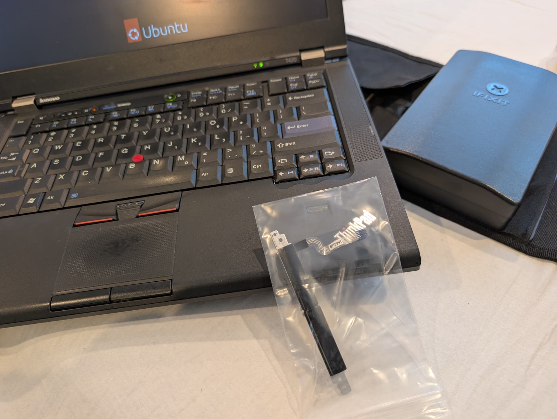

Did some surgery on the ole T420. Now my left button under the track pad works again.
Only using the t420 for openxcom extended with FMP (final mod pack) and FMP extended lately.

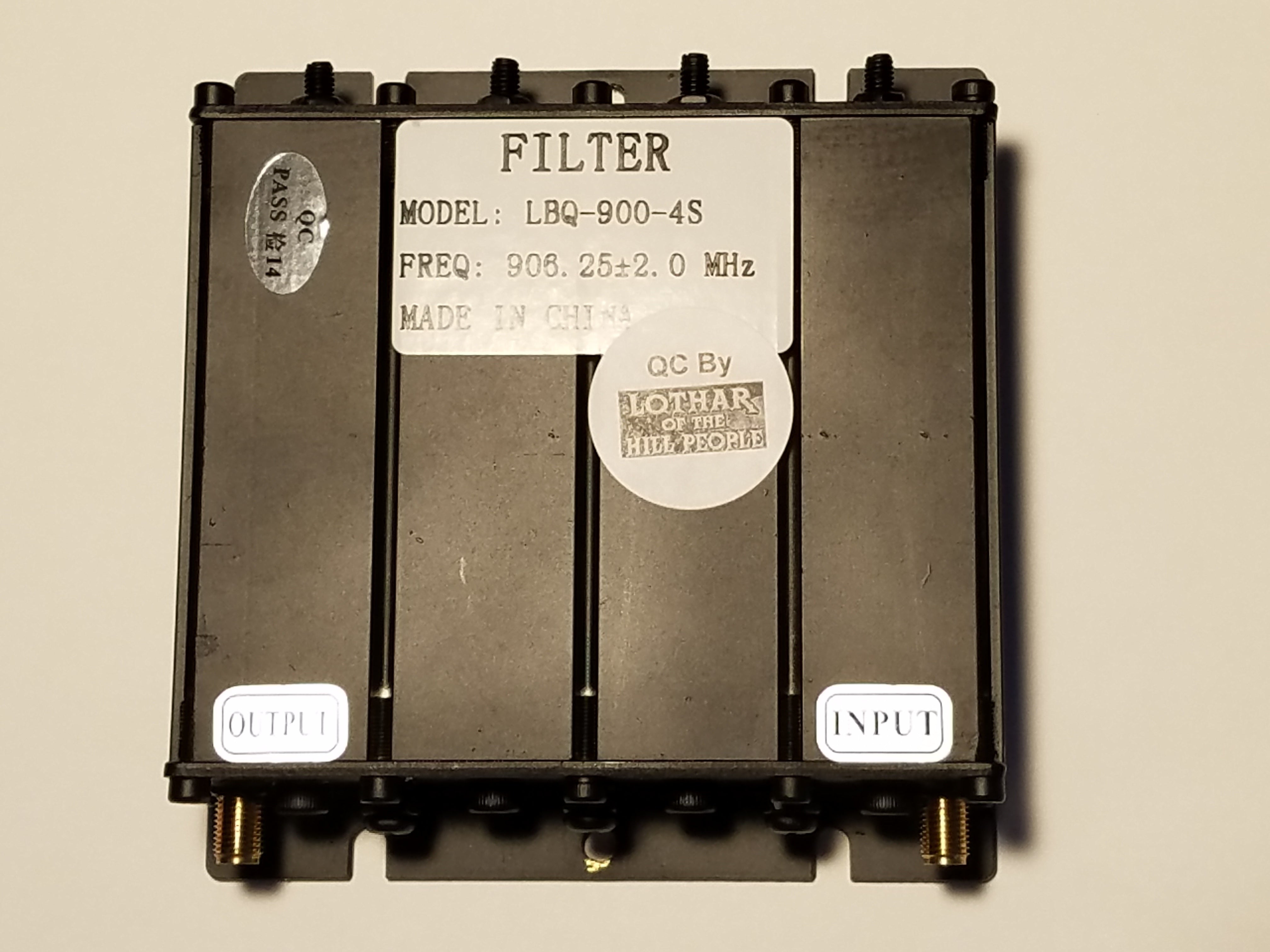

AirFrames has expanded their Cavity Filter options with a drop down to support more frequencies.

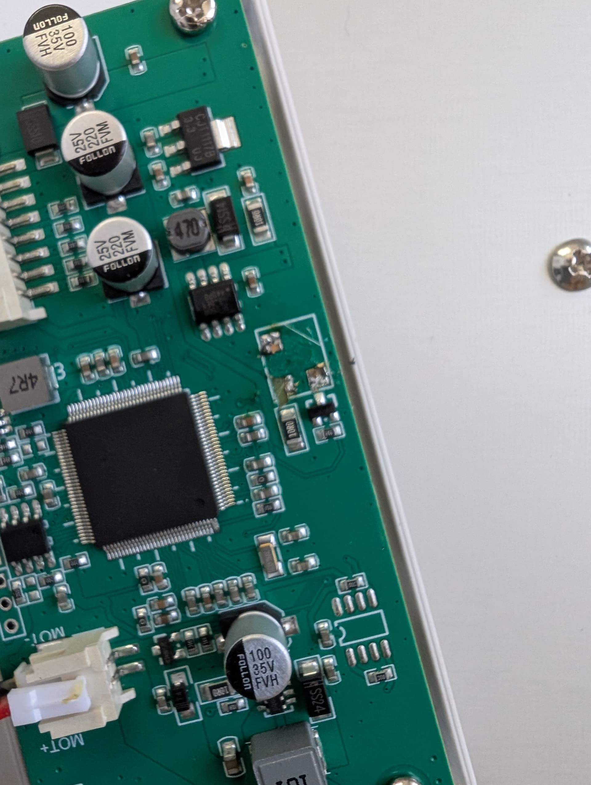

I have a component at home that when used (BT from phone to turn it on/off) it makes a beep.
I have a dog that freaks out and hides hearing things of that frequency (YouTube vids of the ‘bing’ sound effect, gun tubers shot timers etc).
So i cracked it open expecting to find an obvious little beep component (they look like smaller wired cmos batteries) but nope.
Looks like it’s this surface mount thing
Im perplexed why it has three leads.
Its looks intensive to remove plus I wouldn’t want to mess up some kind of circuit dependency. Can a big blob of hot glue all over it mute it down a lot?

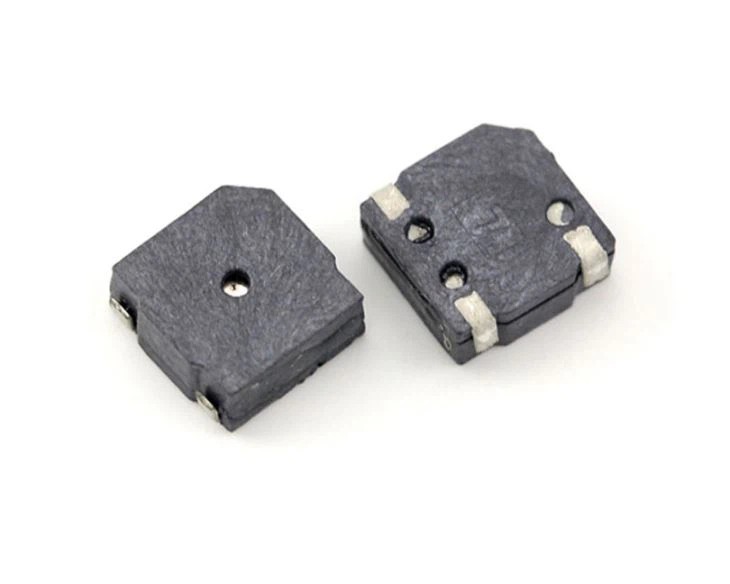

I believe that would be a self drive type piezo buzzer. Pretty much has them produce the loudest sound they possible can… assuming I remember this from college correctly, but that’s been a long while.
I would check this write up on them here: Wayback Machine
Probably wouldn’t hurt, but I doubt removing it would cause any issues unless the engineer decided to get weird with the design of the device to make everyone’s life more complicated.
If you have hot air, it shouldn’t be a problem, or you can use a pair of hot tweezers.
The pads look quite large, and the component’s legs are quite large, extending upwards, allowing for direct heating.
A regular soldering iron will also work, just pour in some flux and use a wick to remove the solder. If there’s room underneath, place something thin to provide leverage.
In the worst-case scenario, if it’s magnetically reactive, you can use a strong magnet hanging above it. It will also lift the component once the solder heats up, and it probably won’t rip out the pads. :slight_smile:

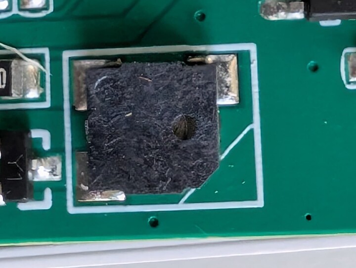

So hot glue didn’t work so started to use flux and a whick to no avail so just man handled it off.
Success.

I have a smd workstation on my Amazon list that includes hot air but ive been too cheep to get it.
I really really lucked out. Cranking the thing off took a pad with it, very lucky its not like a mech keyboard and took out functionality elsewhere. If i had the schematic that pad is either parallel off of a trace and not a critical part of the trace or maybe its a pad to the ground plane of the pcb. I freaked out for a minute.
Solid pads… :slight_smile: Last time I tried to desolder something by brute force, I took all the pads from the PCB with me. :slight_smile:
