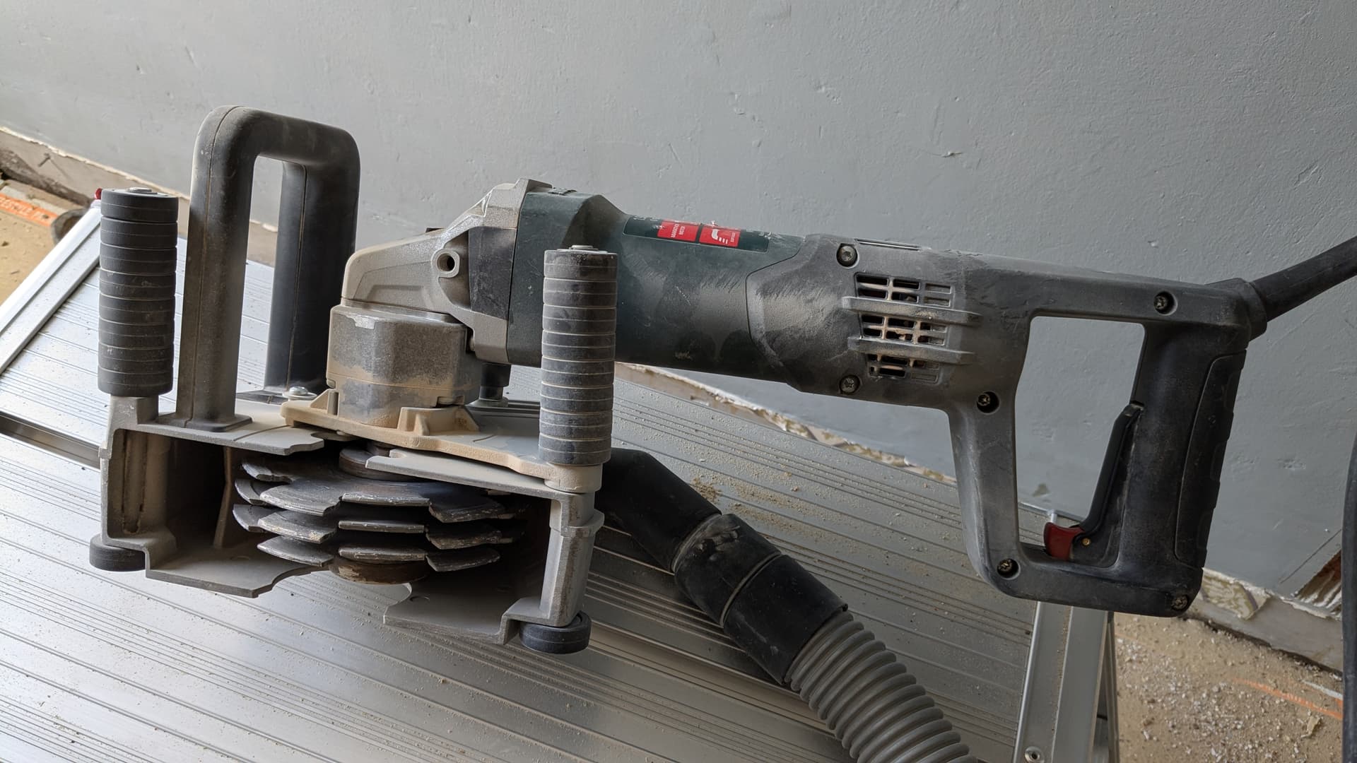

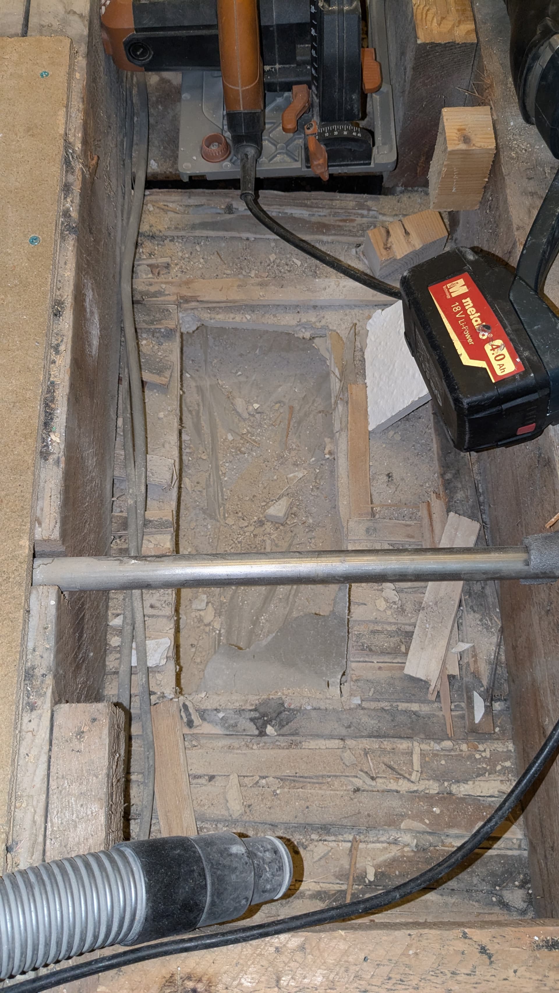

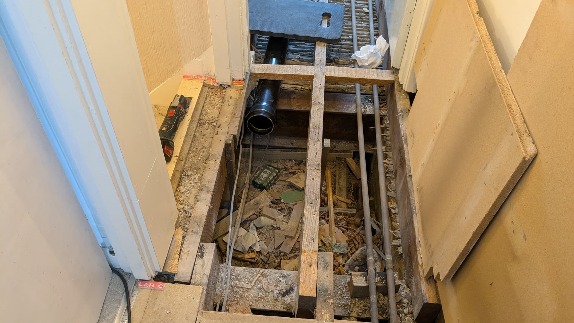

Started the chase for this timber
using my wall chaser again to make quicker and less messy work at it. Has a vacuum attachment connected to a vacuum that starts up when the tool does.
It doesn’t get to the top and bottom, so I do that with multitool
don’t take long for the vacuum to get filled up
the tedious bit (cleaning up), to get it ready for habitation again. I try to do the work when stepdaughter isn’t in, and it’s not often that’s the case, but it means that with every session there’s a good few hours of putting everything back. At least now the rooms are separate, it’s a lot less work to put things back.

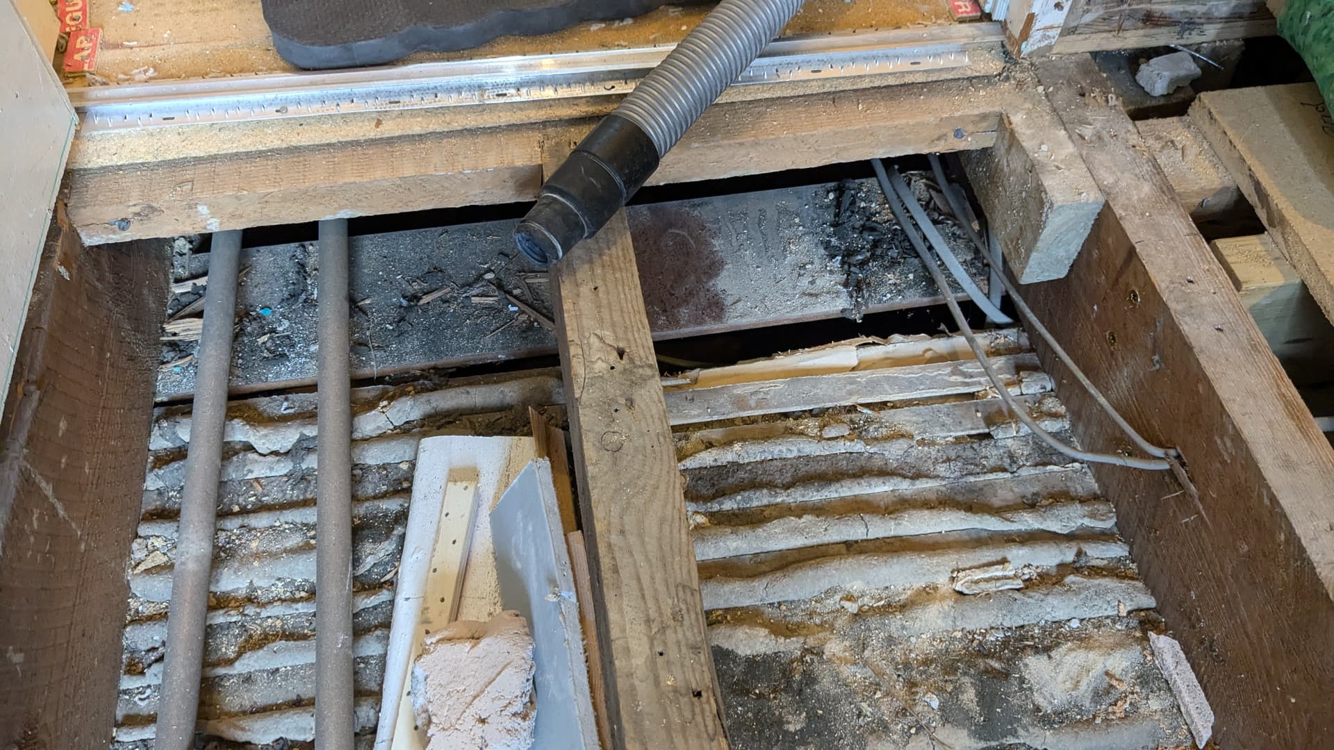

here’s the steel I need to go over, there’s another one after that
lube up

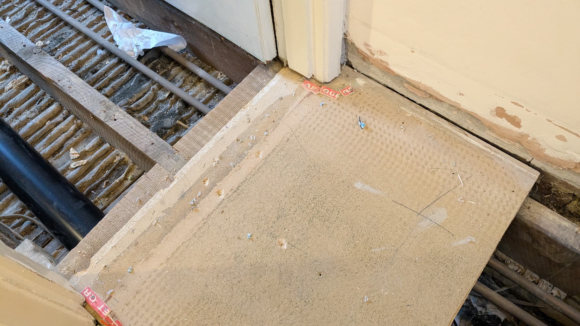

this board went under the stud
so before taking it completely out, I’ve marked it where I’ll cut it out with a jigsaw

on with the next stretch (cleaning out the old materials is tedious, but the more I do, the less will fall down into the room below.

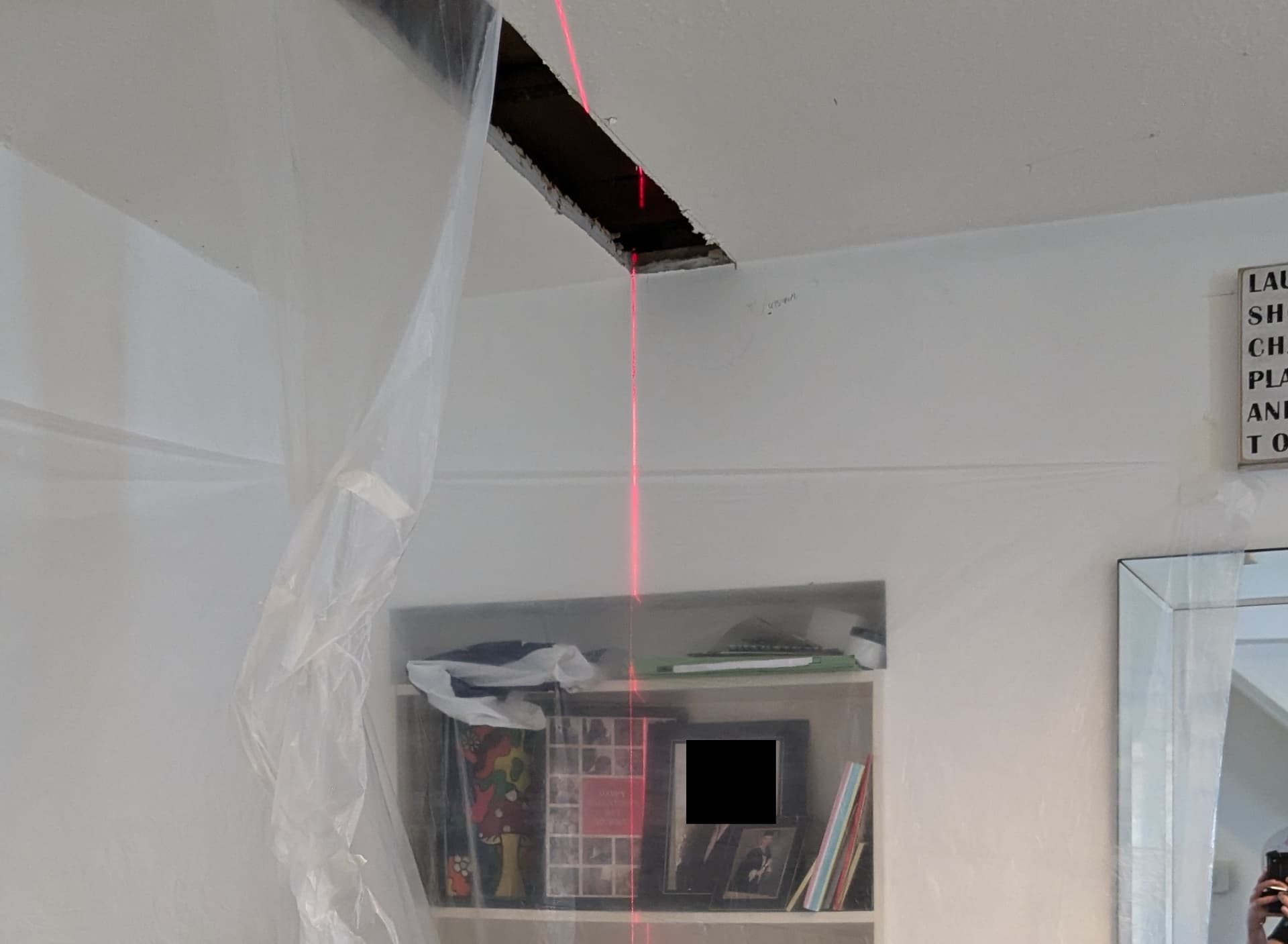

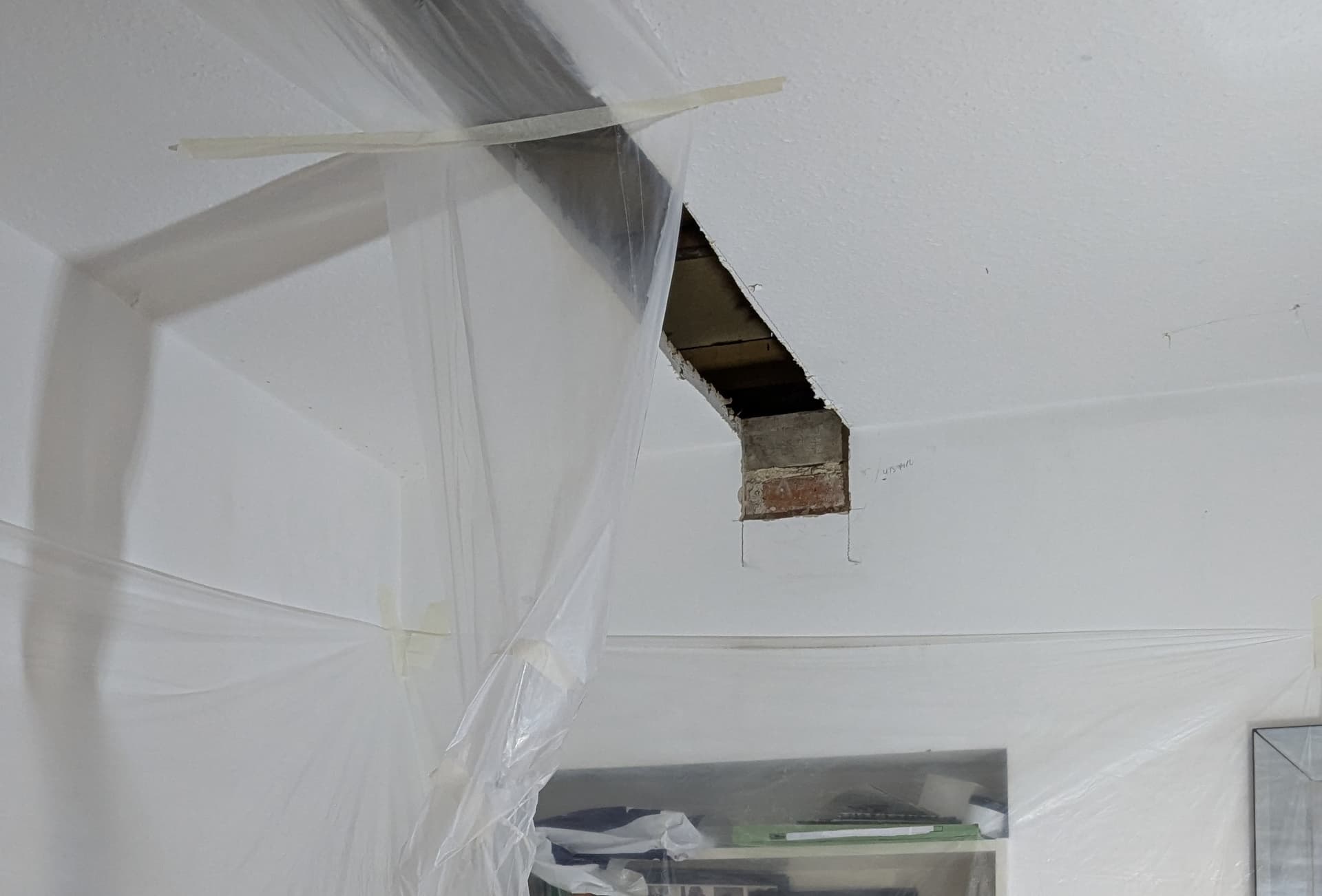

Here’s the room below, marking out the rough area
masking taped some sheet to catch dust and small debris - easier to work on knees upstairs than on steps and working from above downstairs.
sealed up as best as reasonable, wooden block is only there cos the camera can’t focus on white walls
starting the cut (used a circular to start, then moving to the recip saw
cutting out and you can see the sheet that’s stuck to the underside of the ceiling below
decided to tack those electric cables, fast moving saw blade and electric don’t mix, it’s only a 10min job after all.
checked that I hadn’t ripped through sheet, gave it a good 3" of sag so I had some room with the recip blade

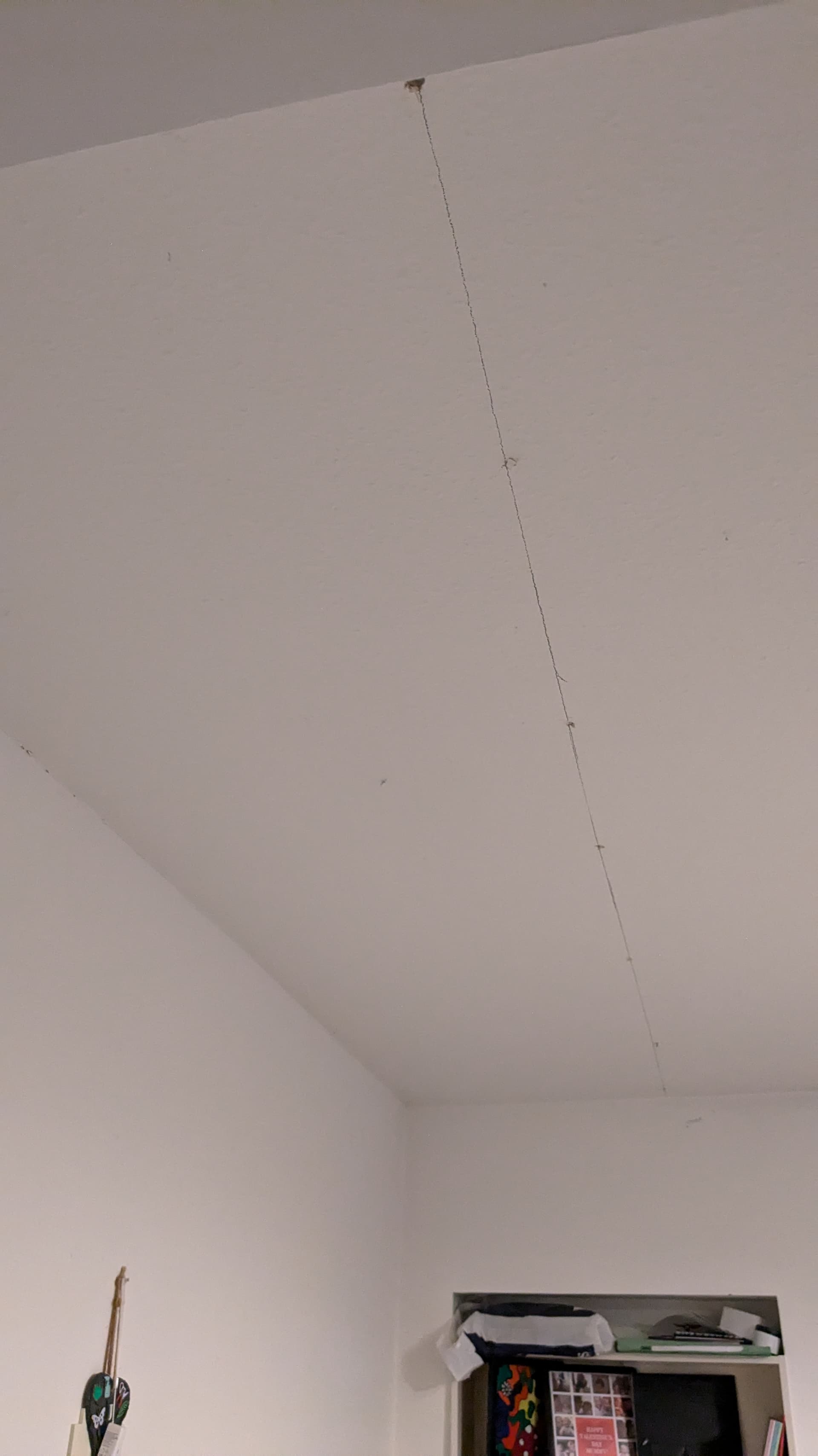

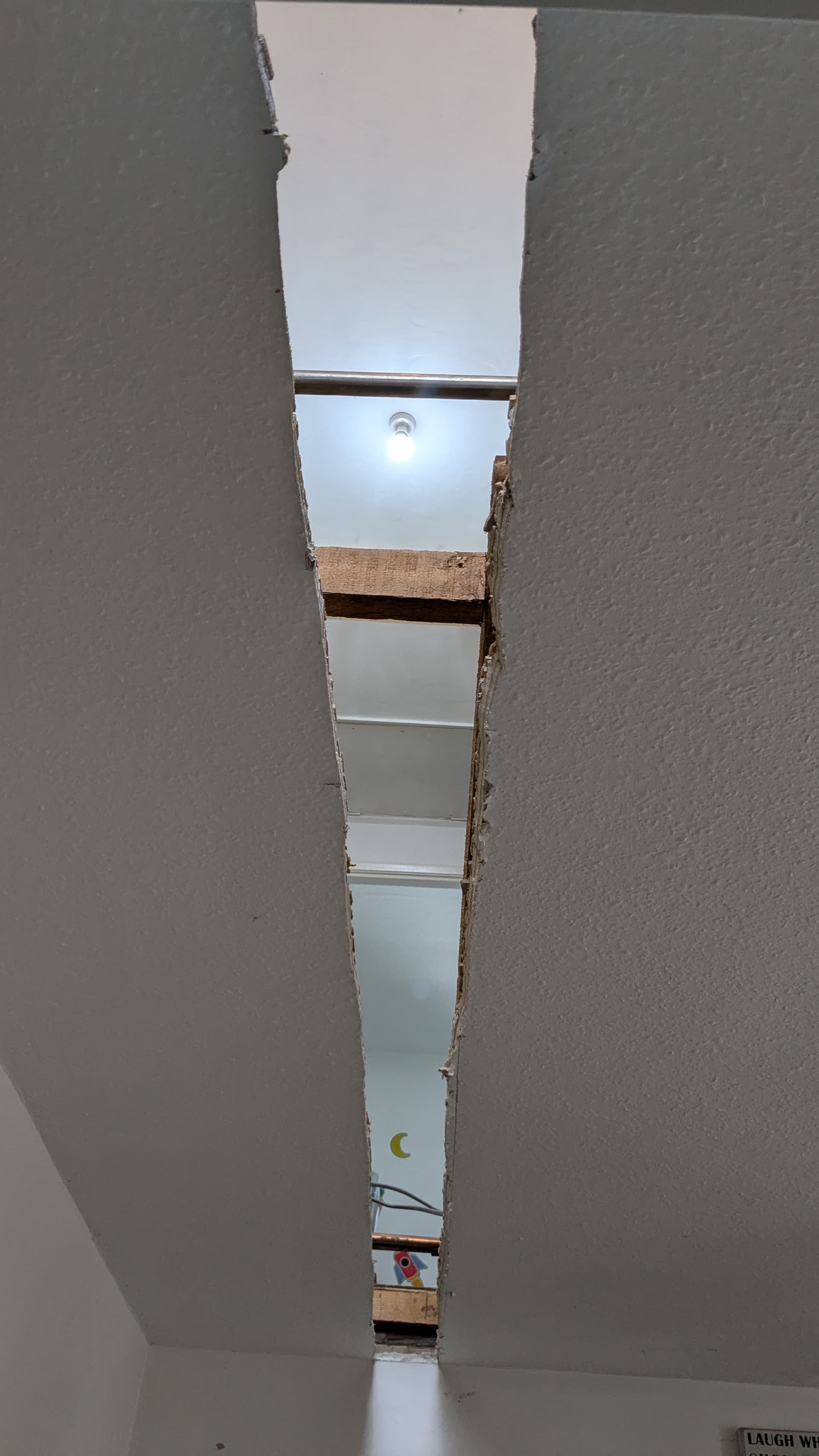

Done the ceiling above that room now
had to stop early, but here 's the uncovered cut in the plasterboard if interested
looking up at the upstairs ceiling

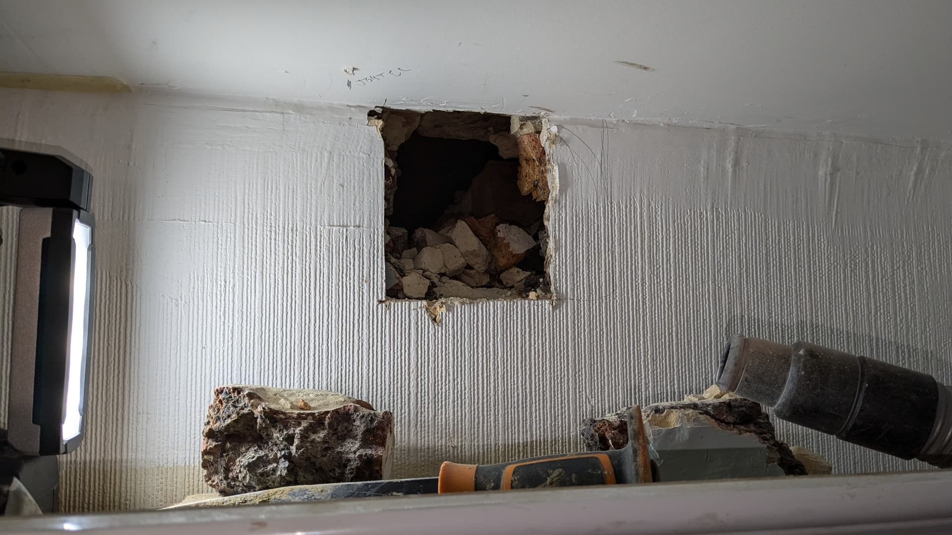

time to cut through the wall into the kitchen (after that it turns right)
carefully cut away plasterboard (to avoid grief from other parties later, haha)

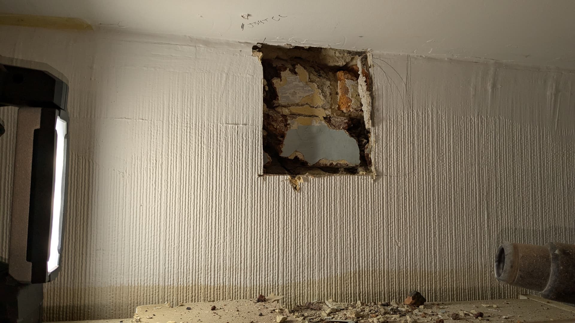

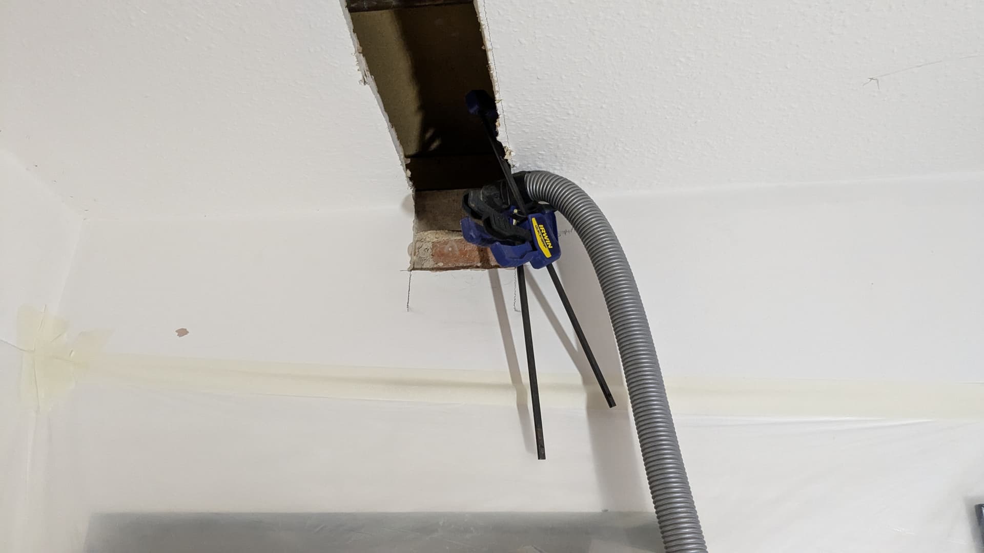

So now I’ve got to go through timber (the “wall plate”), then masonry, set up a friend to hold the vacuum
timbers out

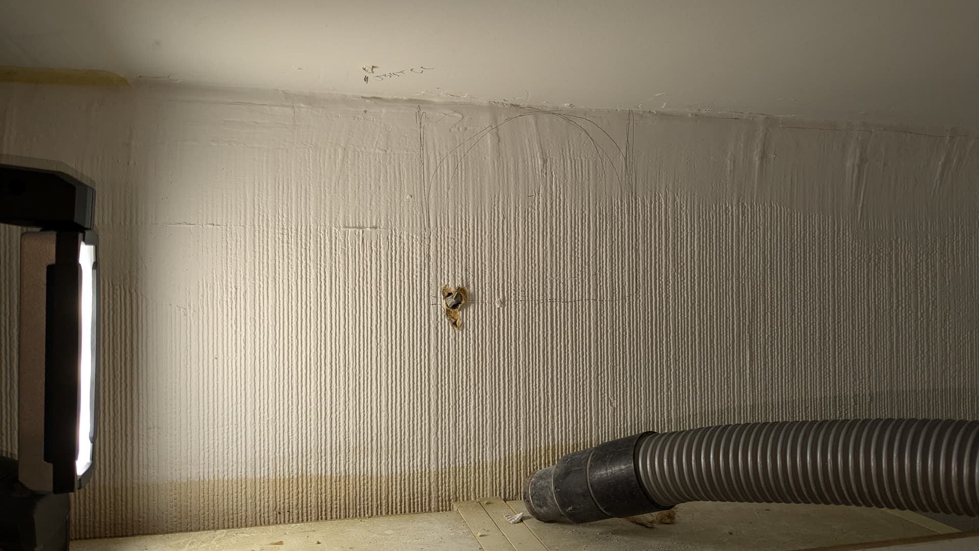

masonry out too, it’s a cavity wall, so you can see the other wall. I’ve drilled a hole all the way through as a reference on the other side

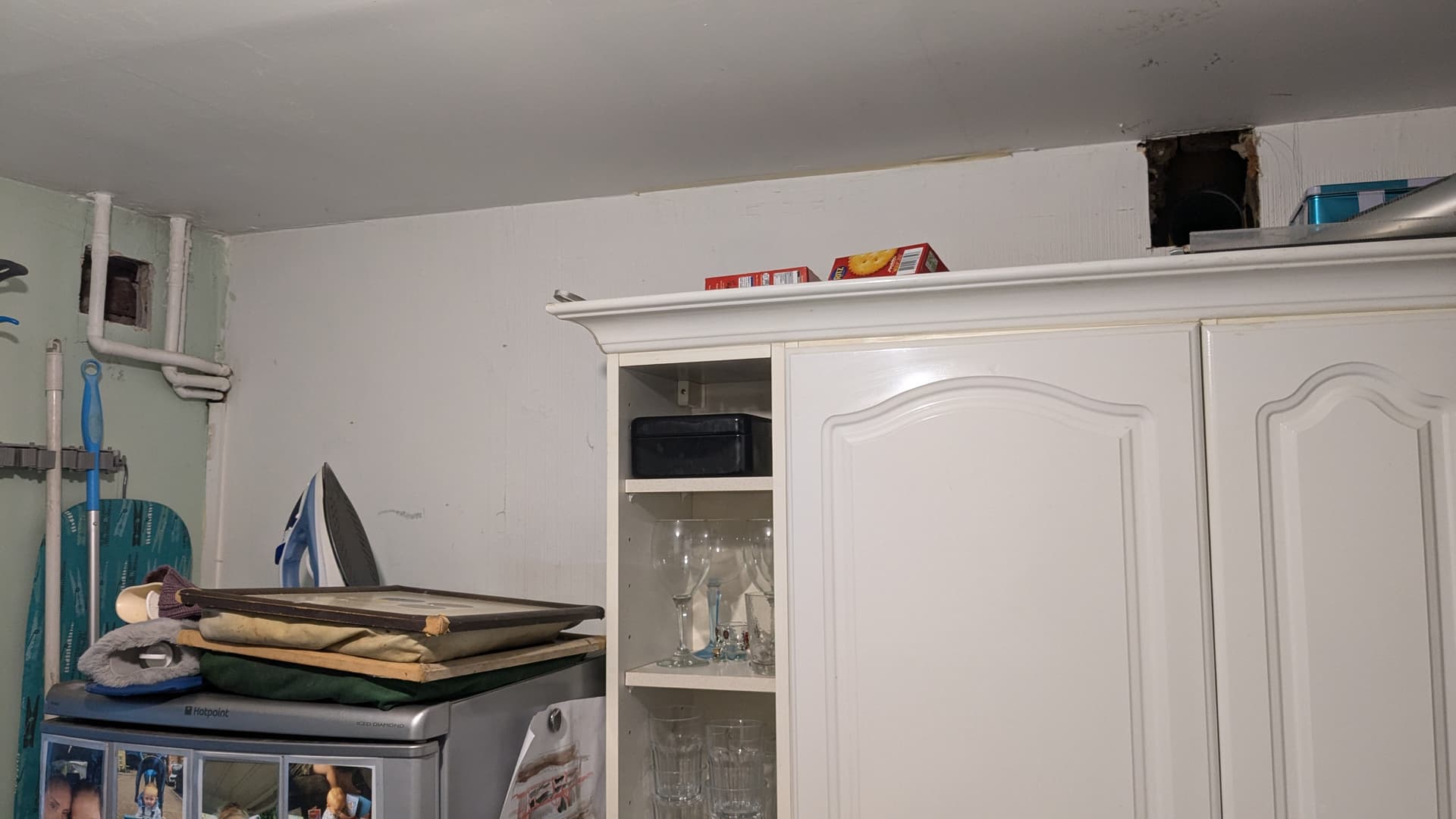

now we’re in the kitchen at high level and you can see the drill poking through
it’s plasterboard on batten, so cut through that
This was a bit fiddly and awkward over a wall mounted cabinet

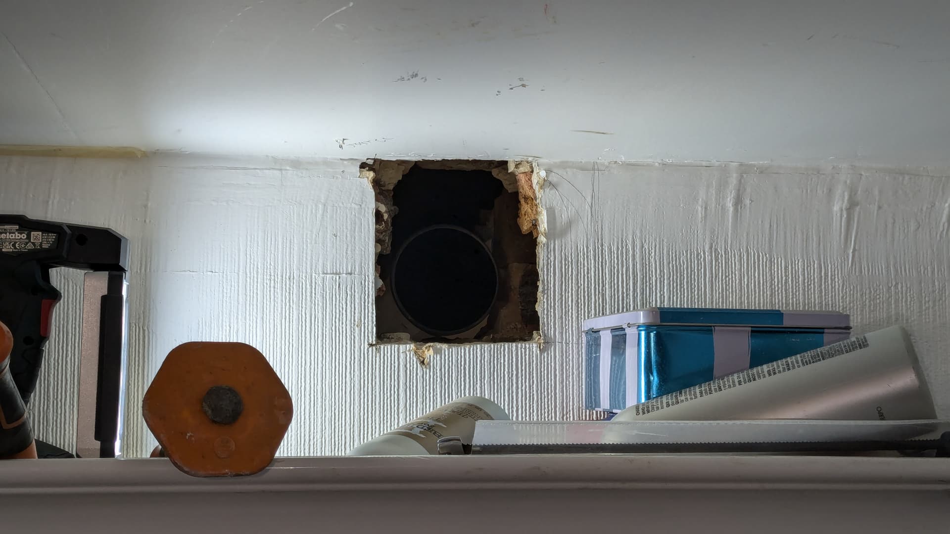

Now we can look through to the dining room

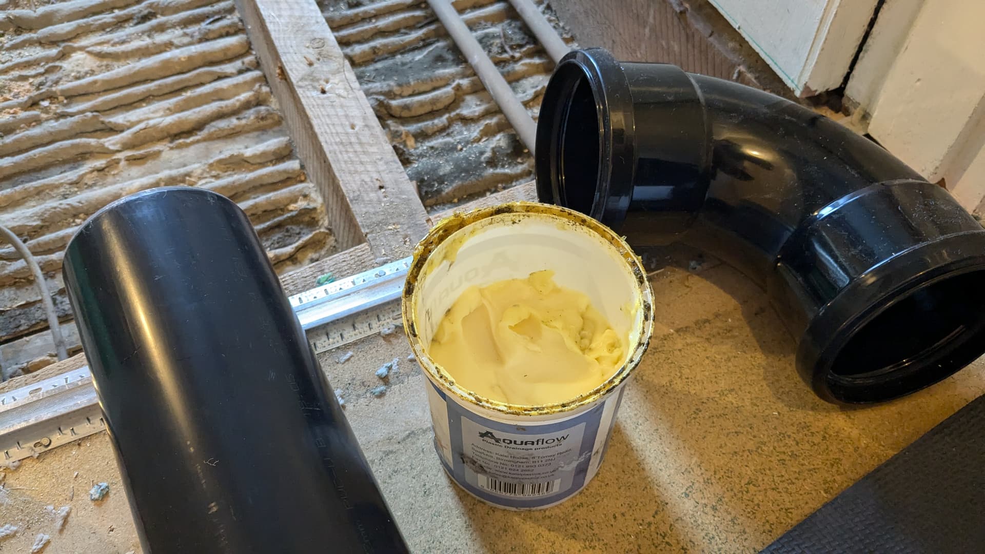

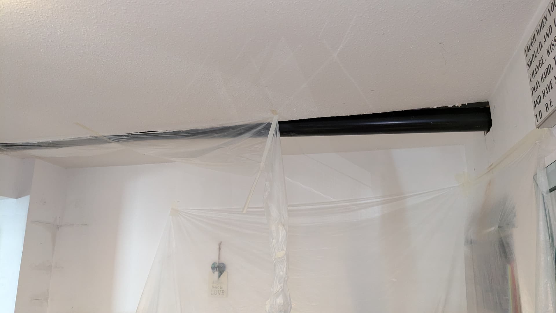

pipe in rough position in dining room
here it is poking through the kitchen, from here (in this view) a 90 deg bend will turn it left
Well, people arrived before I could continue further, but I did break through the other wall (to left, between pipes) - disturbingly easily, so I’ll have to investigate that at some point as it’s a load bearing wall.
