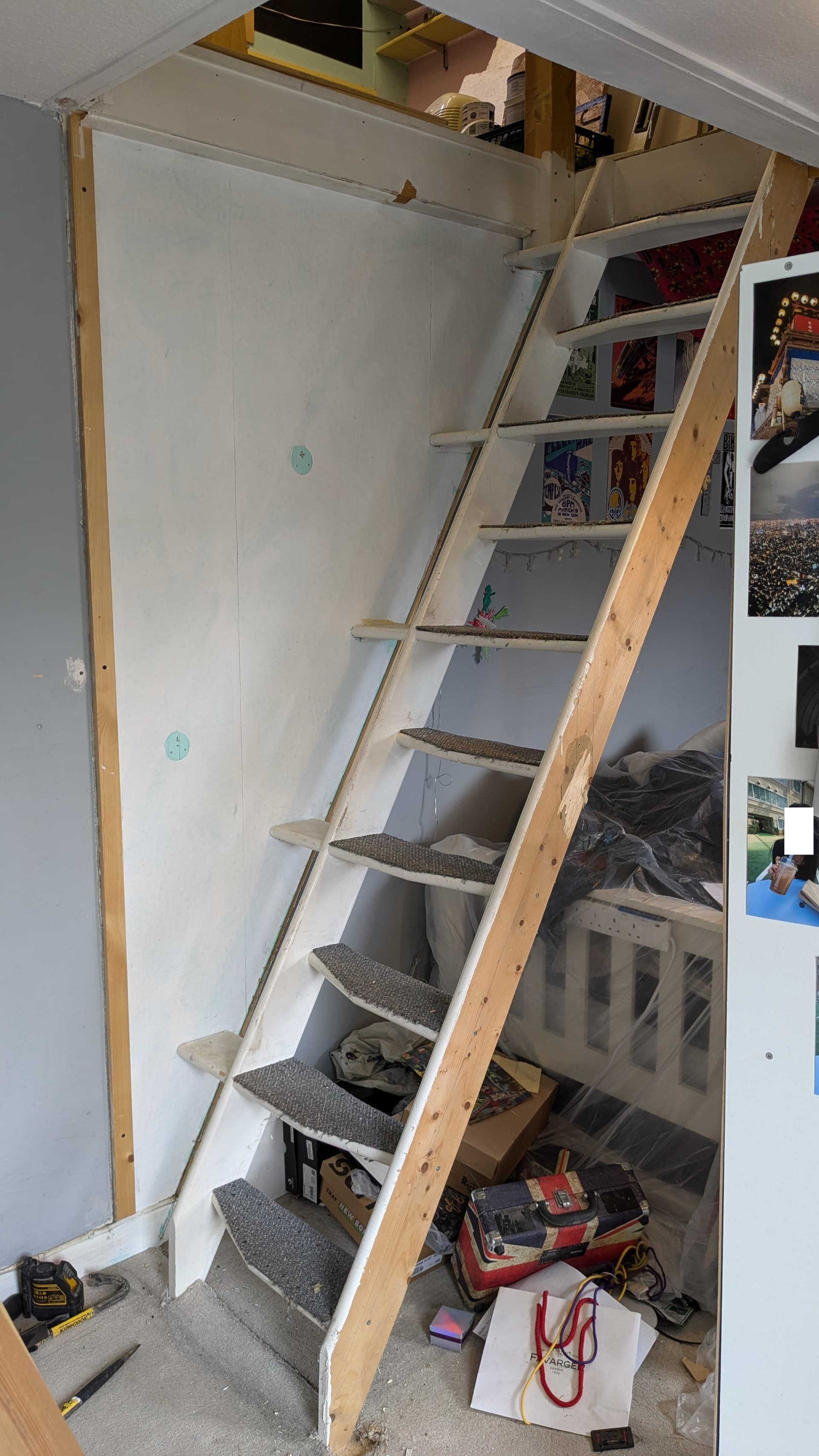

Had to get rid of the crappy loft stairs (it was enclosed, but that went before I remembered to take a pic)

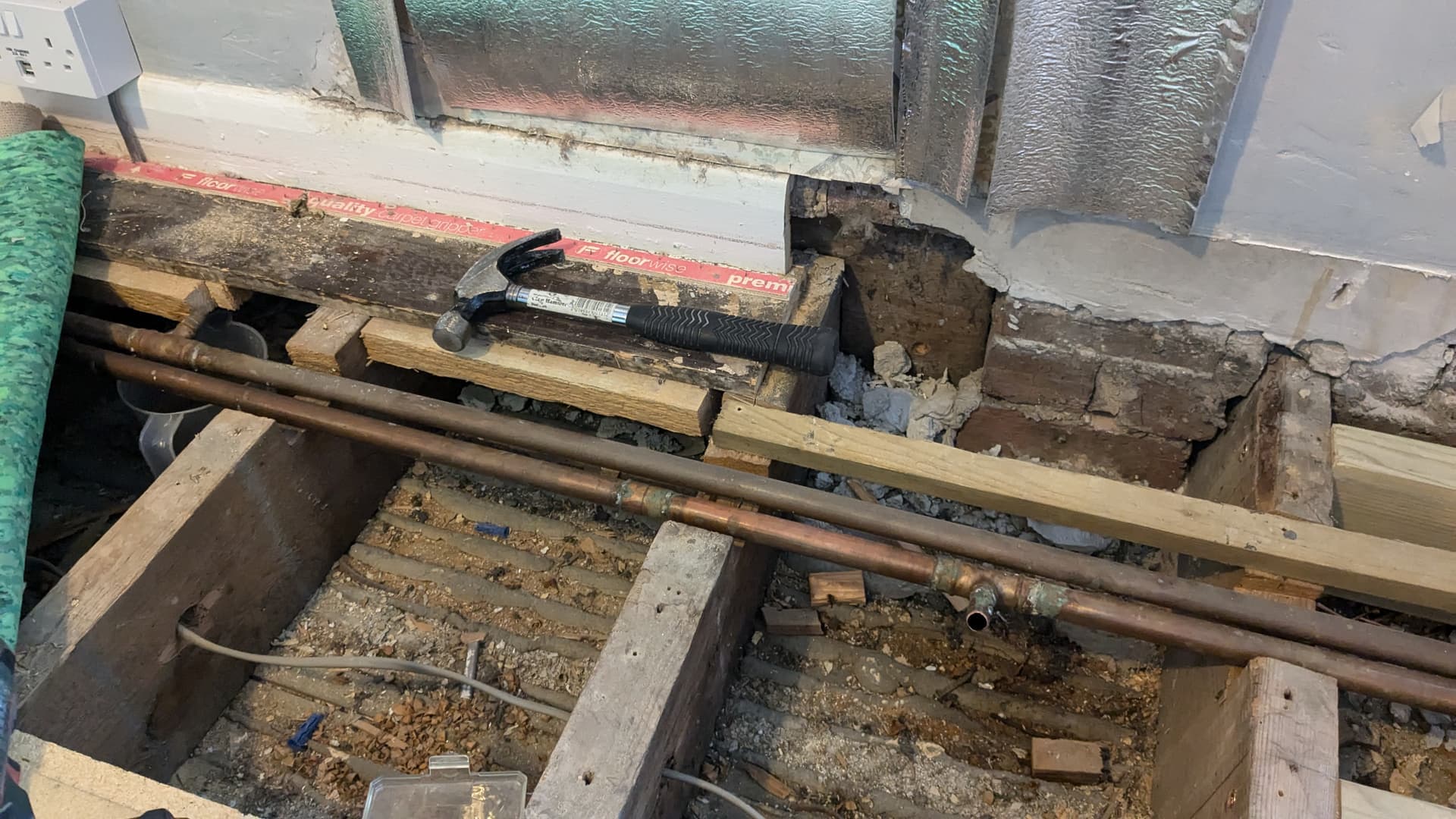

First had to disconnect a radiator feed that was in the way

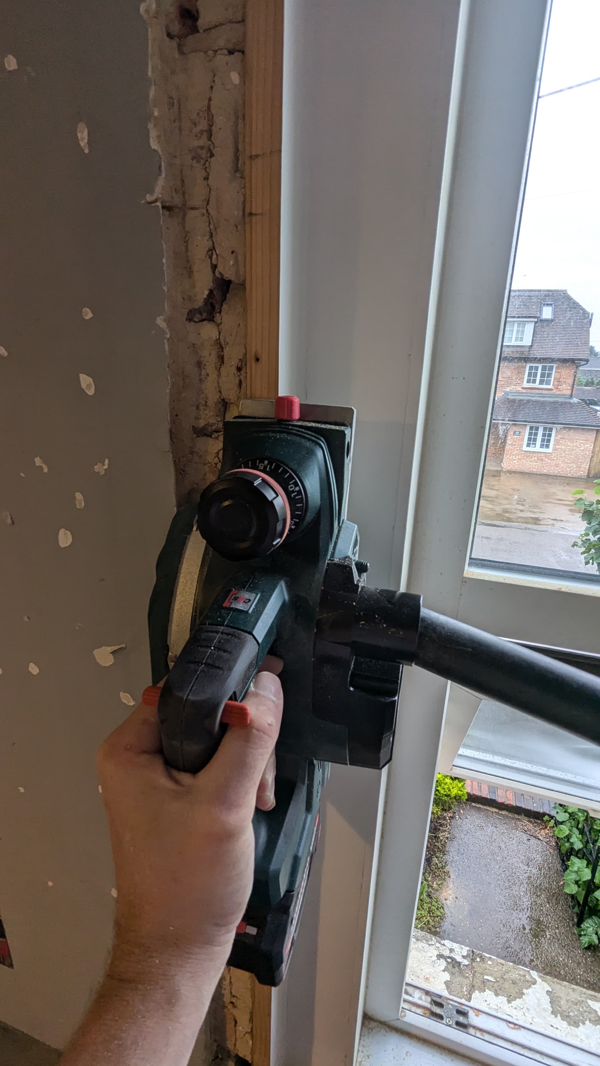

Chasing out this side of the wall next

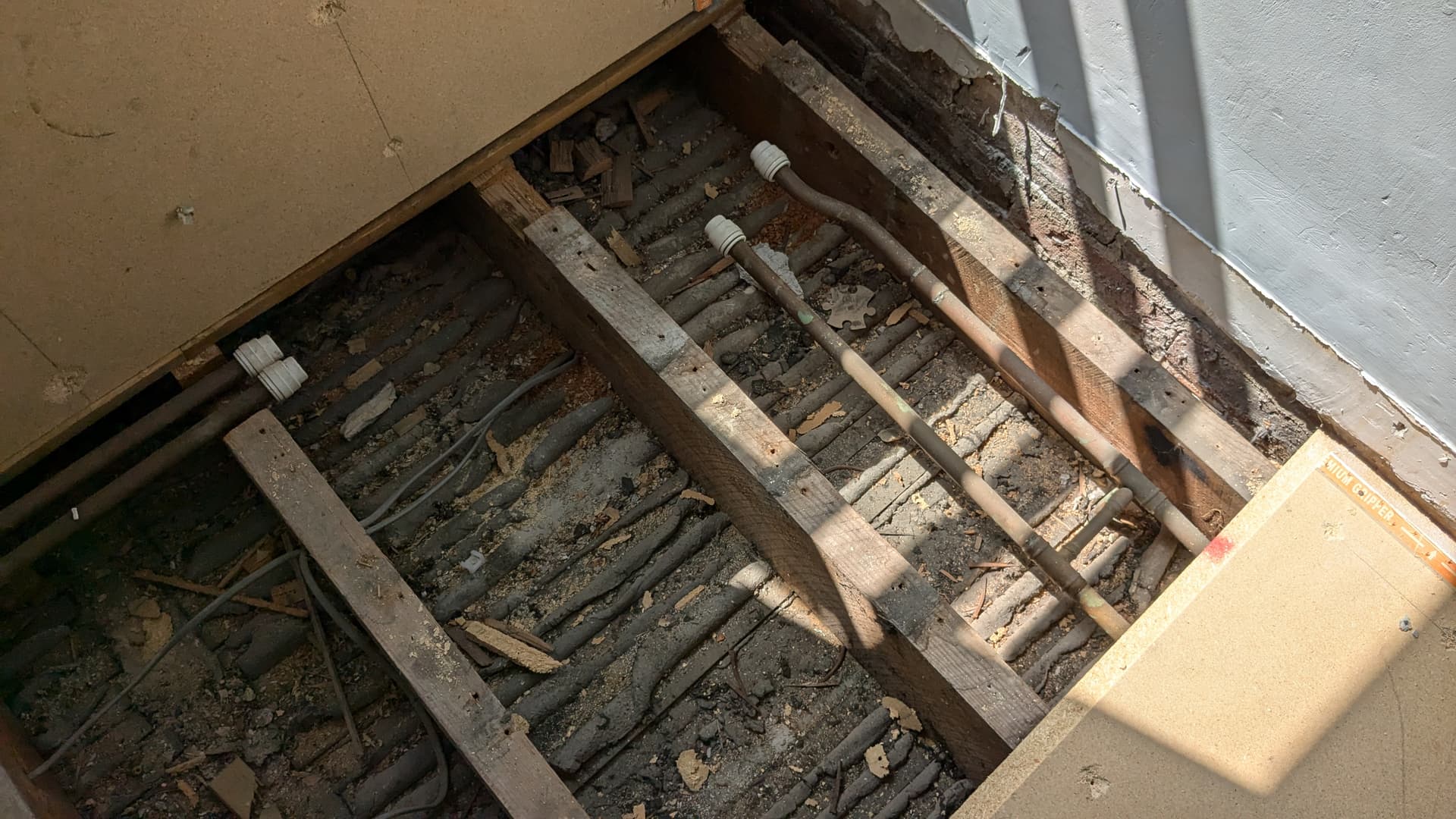

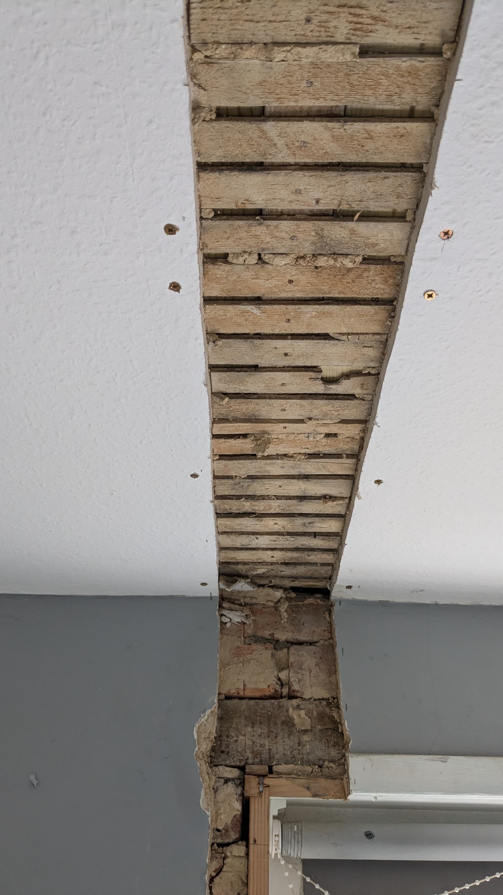

chased out wall
pipes were still in the way, so cut them back a bit more

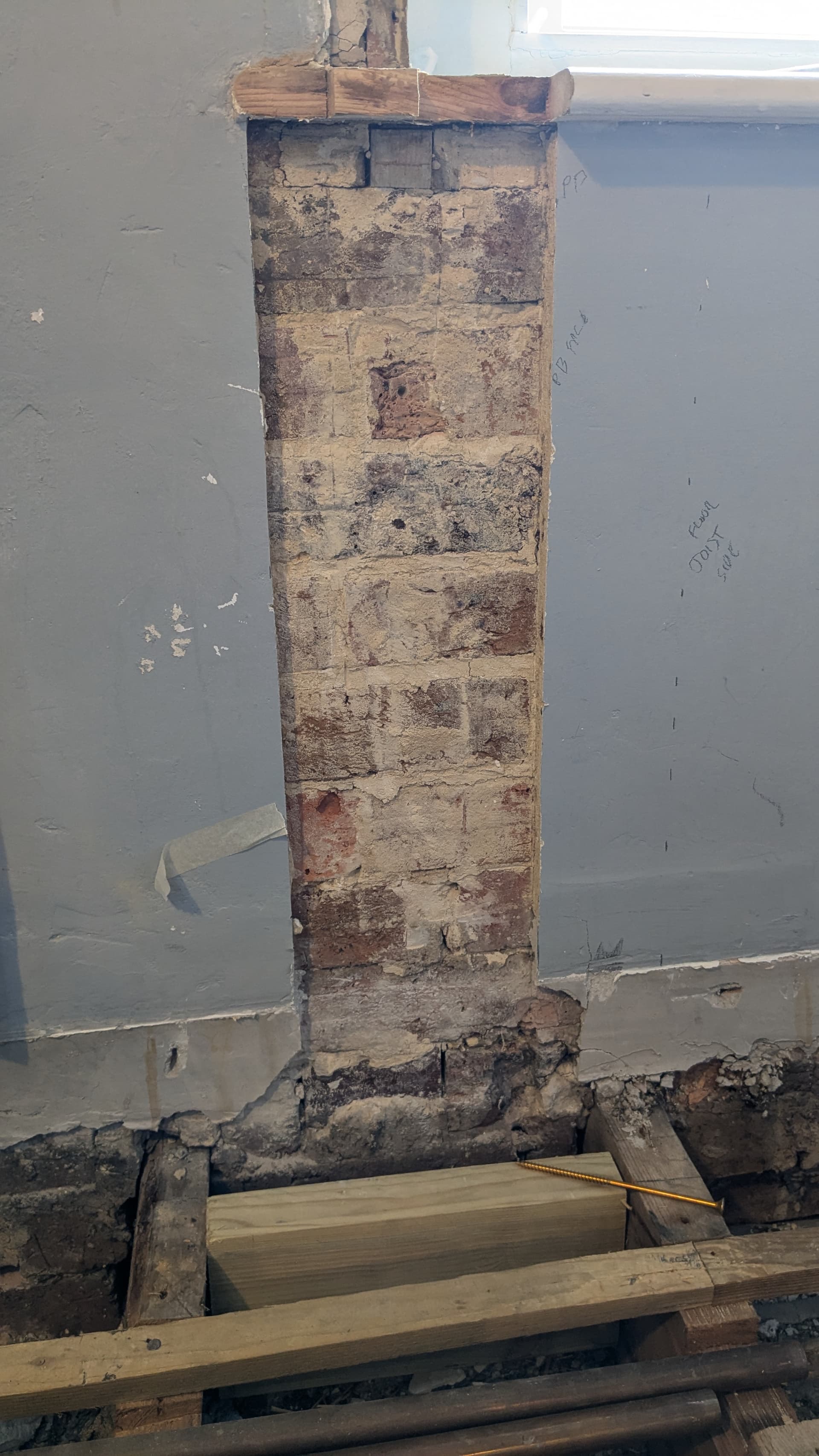

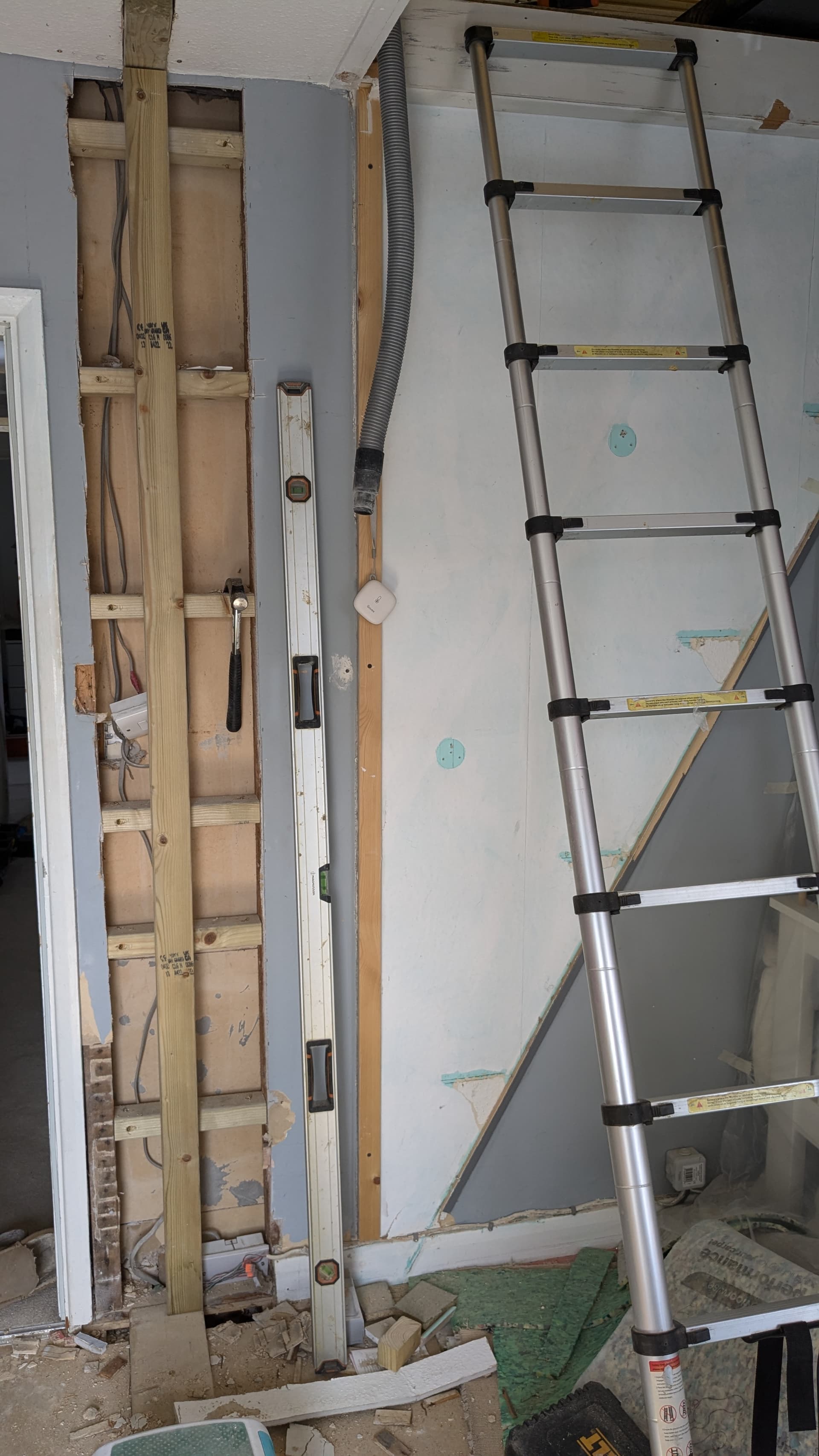

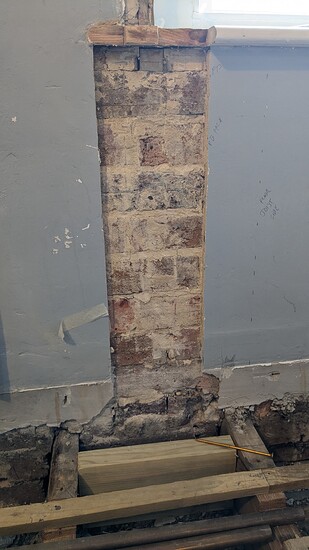

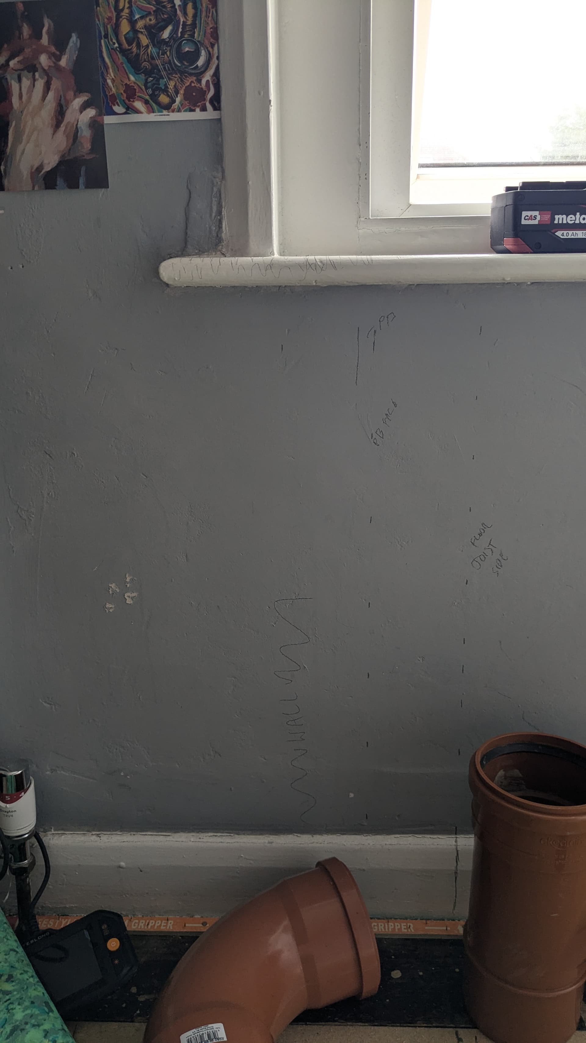

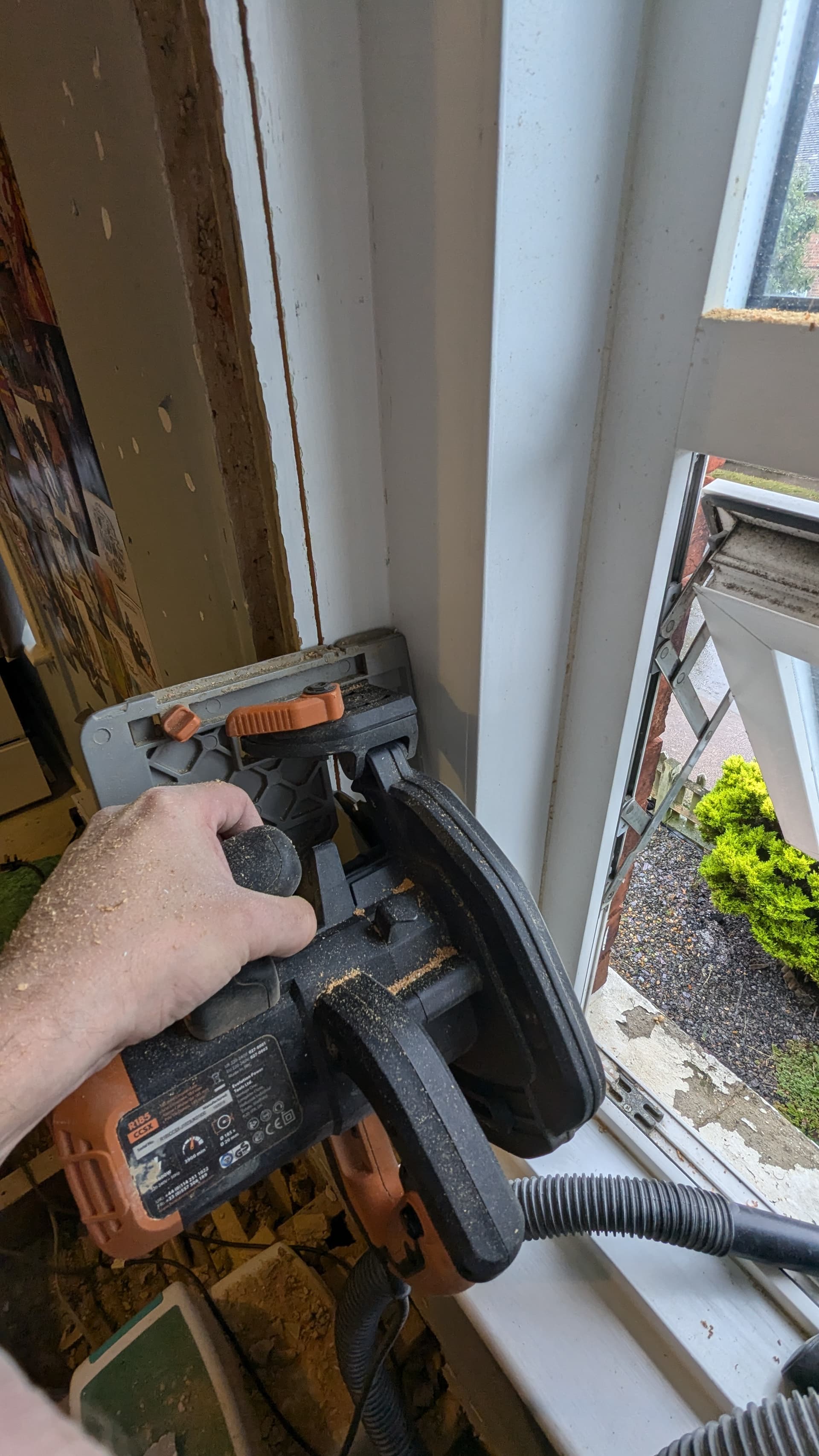

chased up wall for first stud

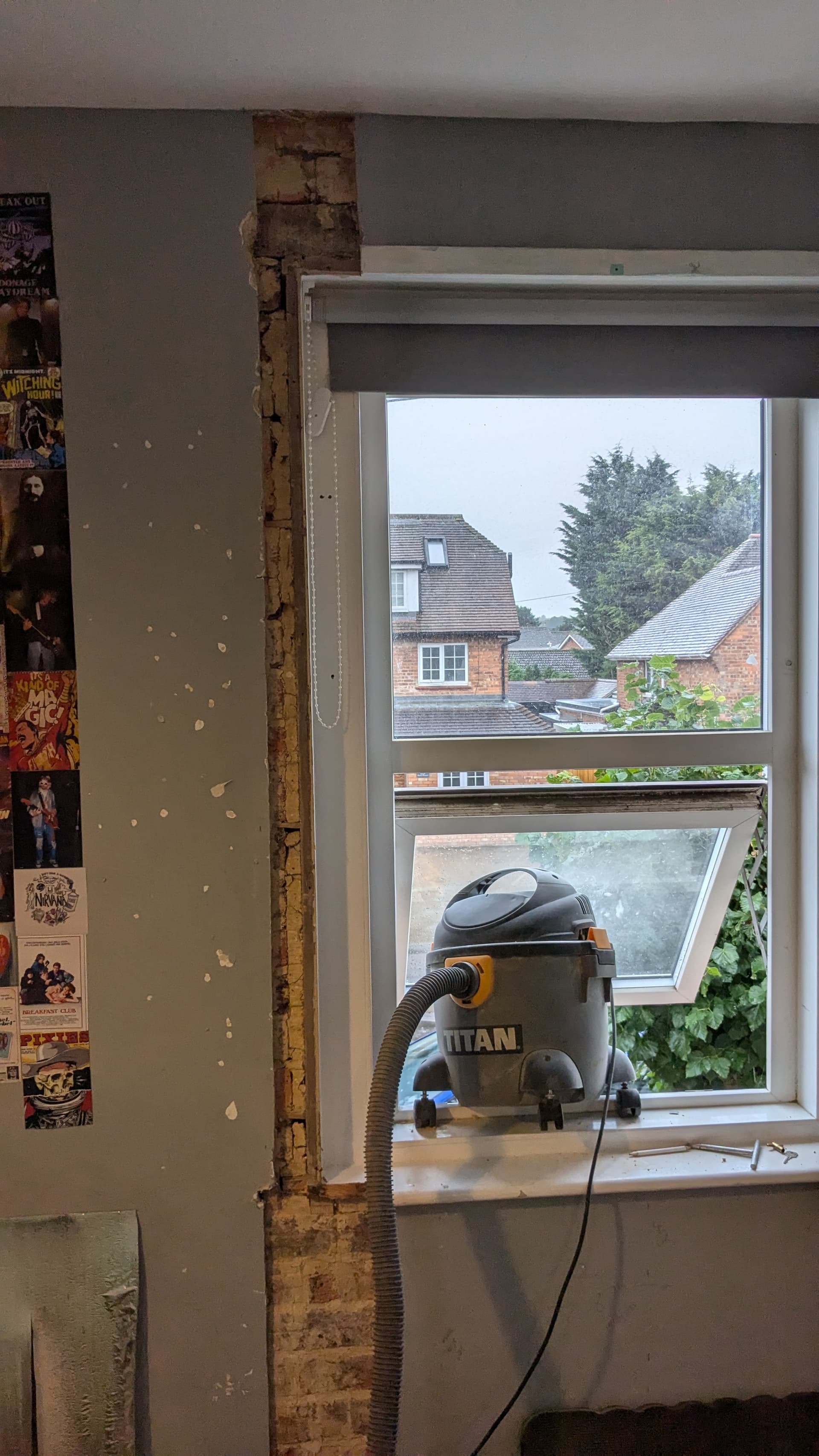

had to cut away the window lining a bit

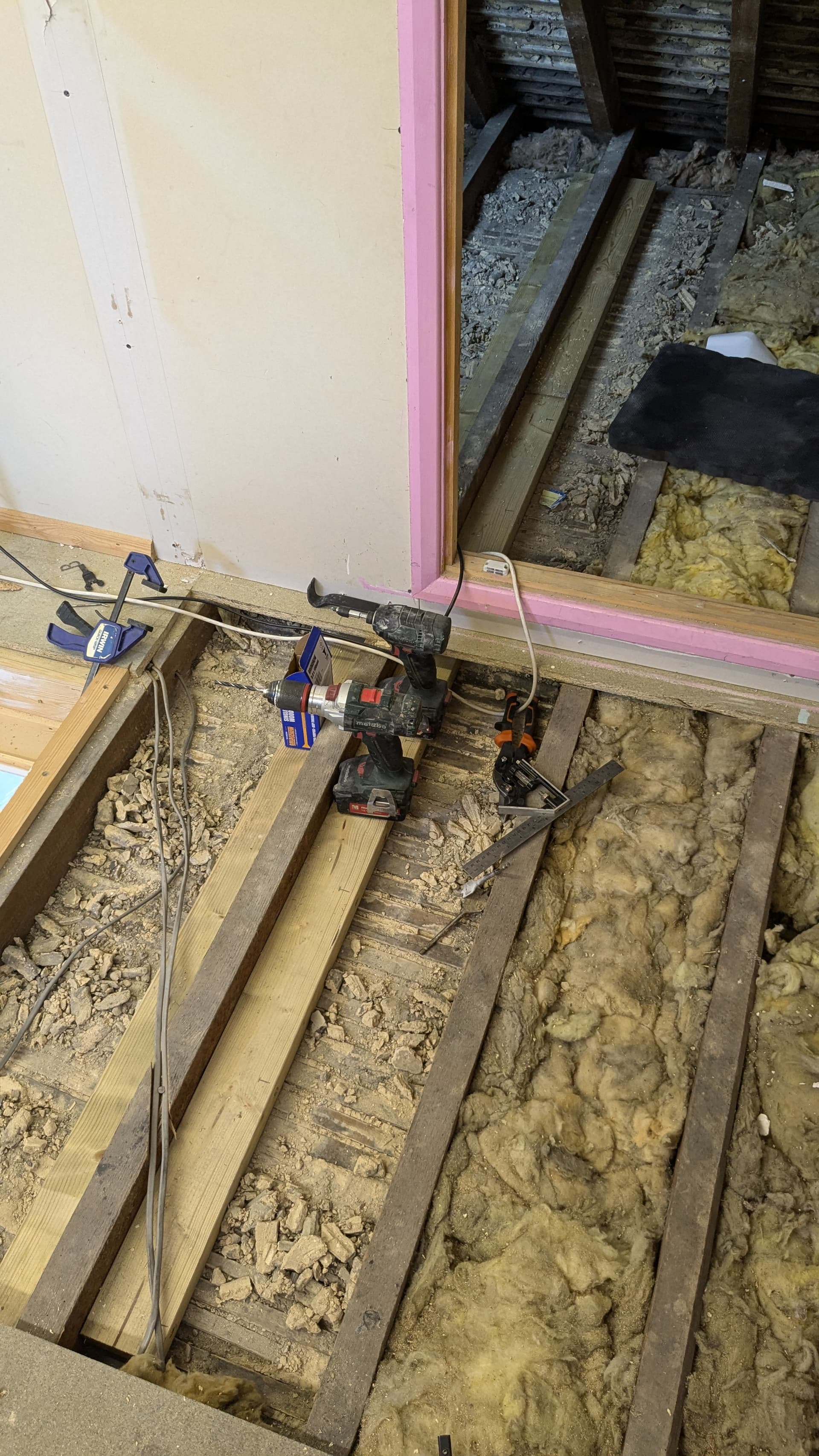

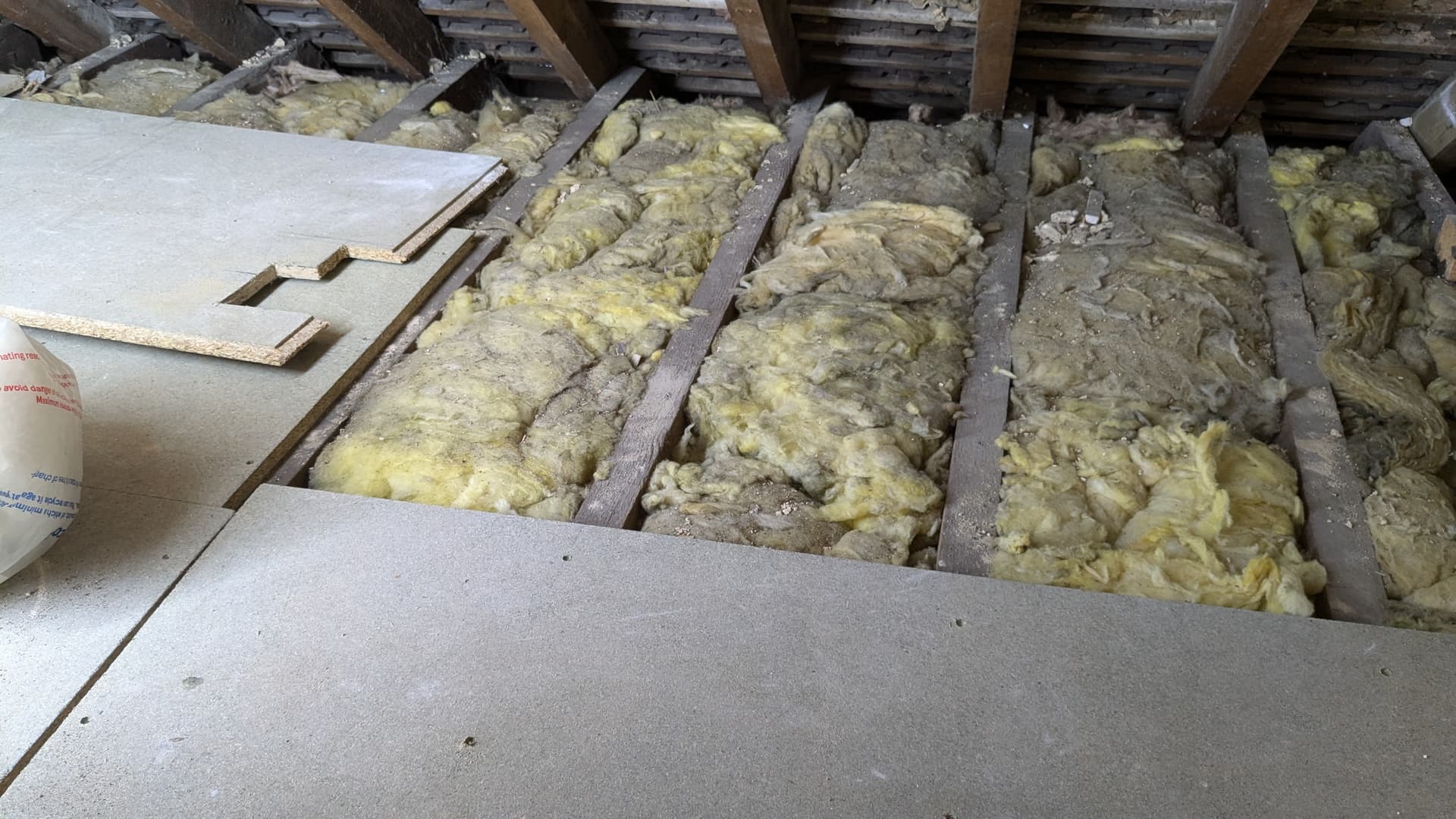

now into the loft space, more noggins needed between joists
time to get the respirator as I need to remove some of that old insulation to make way for noggins

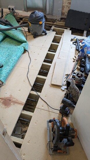

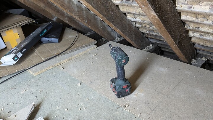

Finally got other boards up, I see it a lot where people board over joists, then mount studs, instead of fixing studs directly to joists.

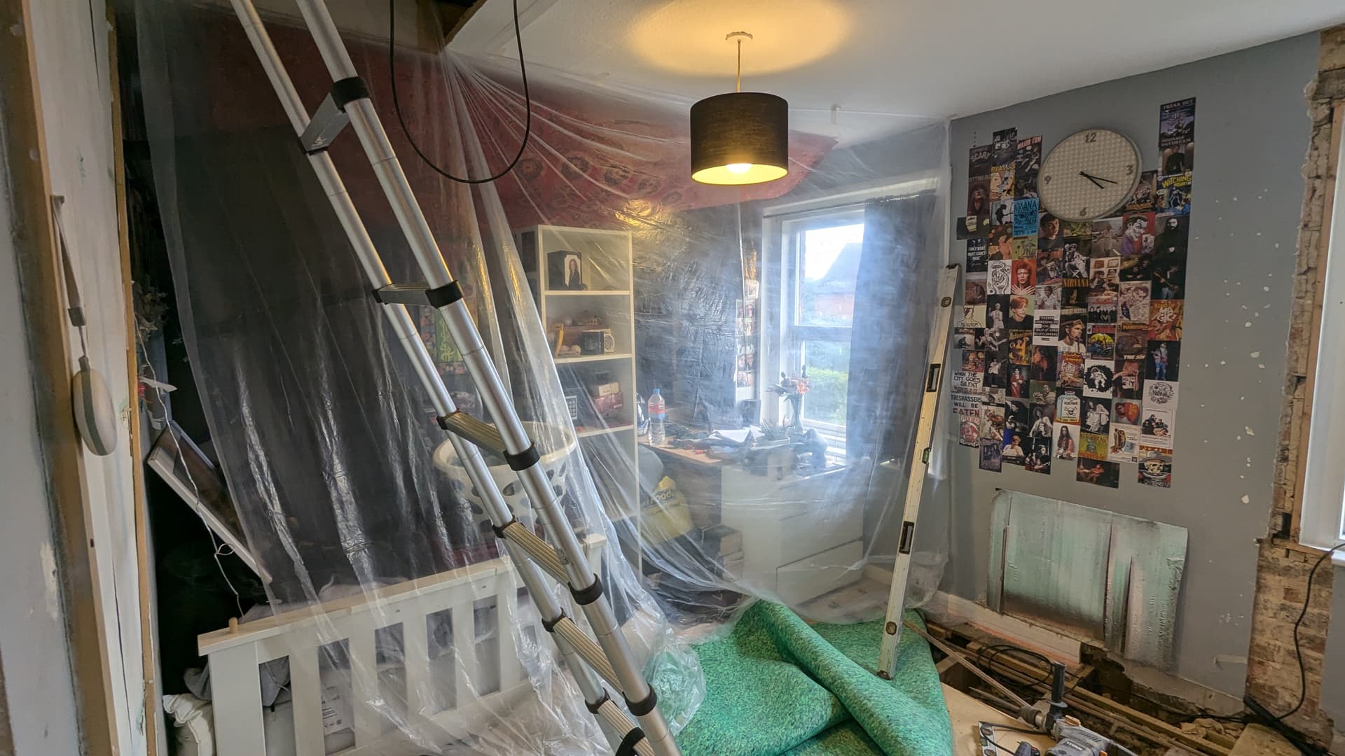

masked up remaining room, as some saws make a lot of mess (and yes I did close it off properly after pic!)

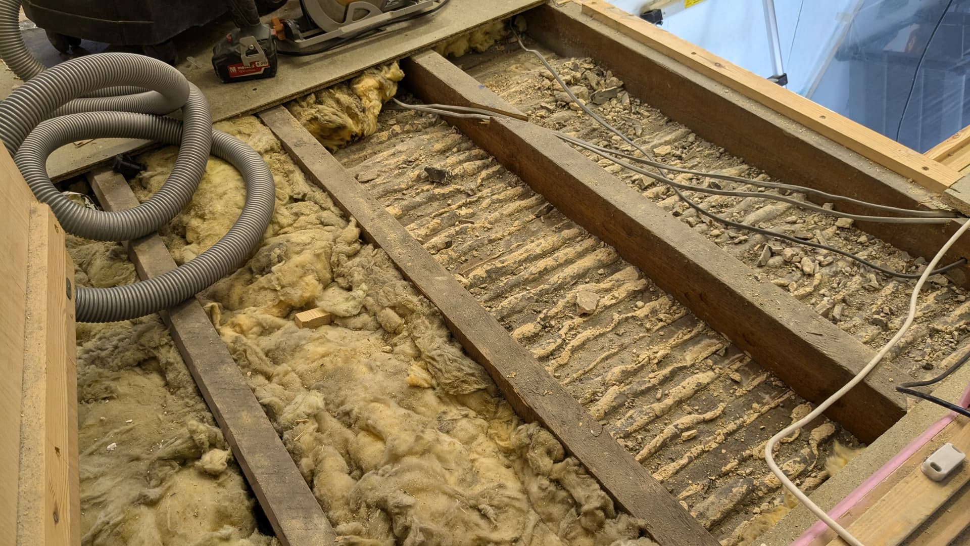

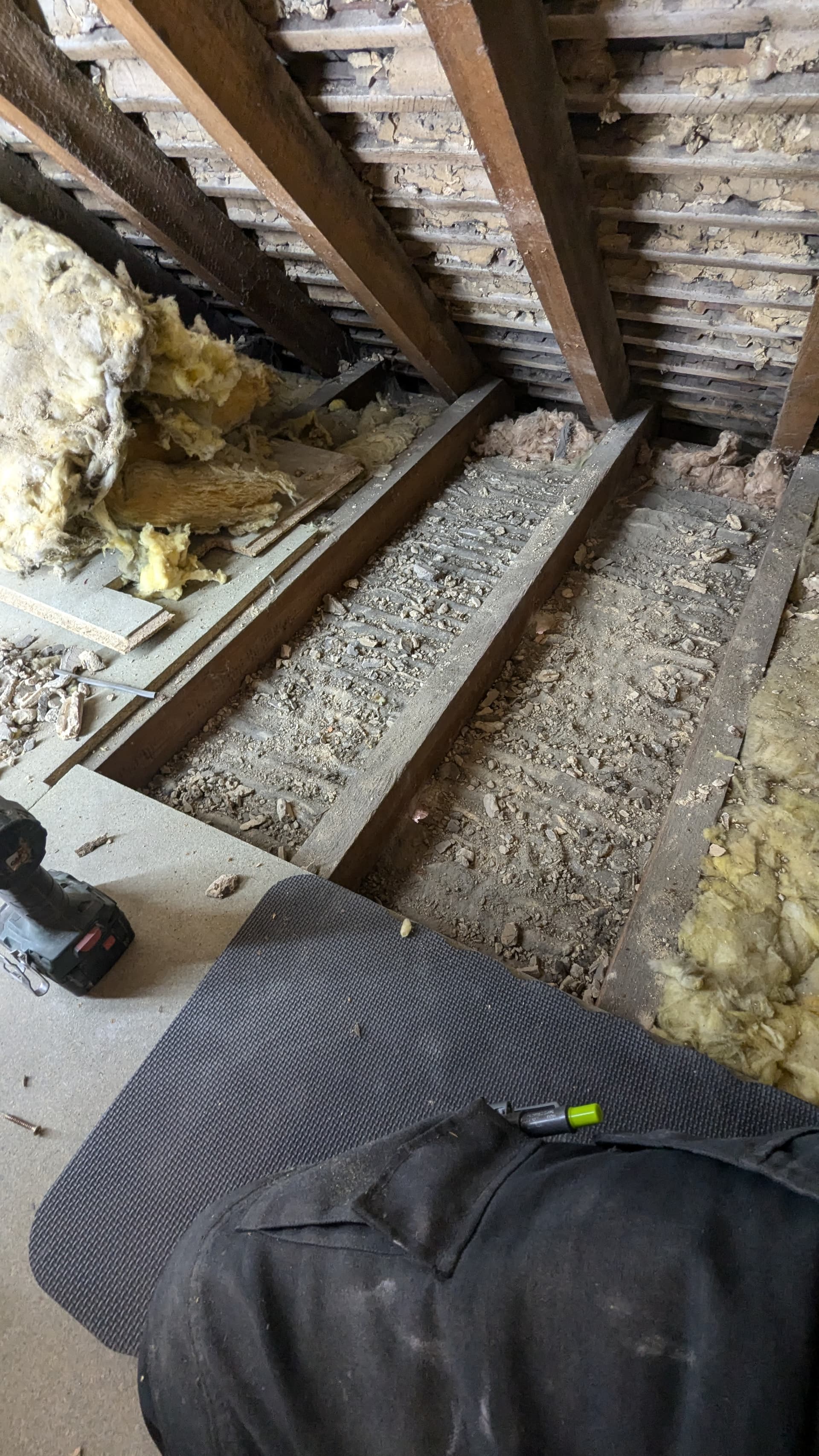

Not very interesting but got the insulation out the way

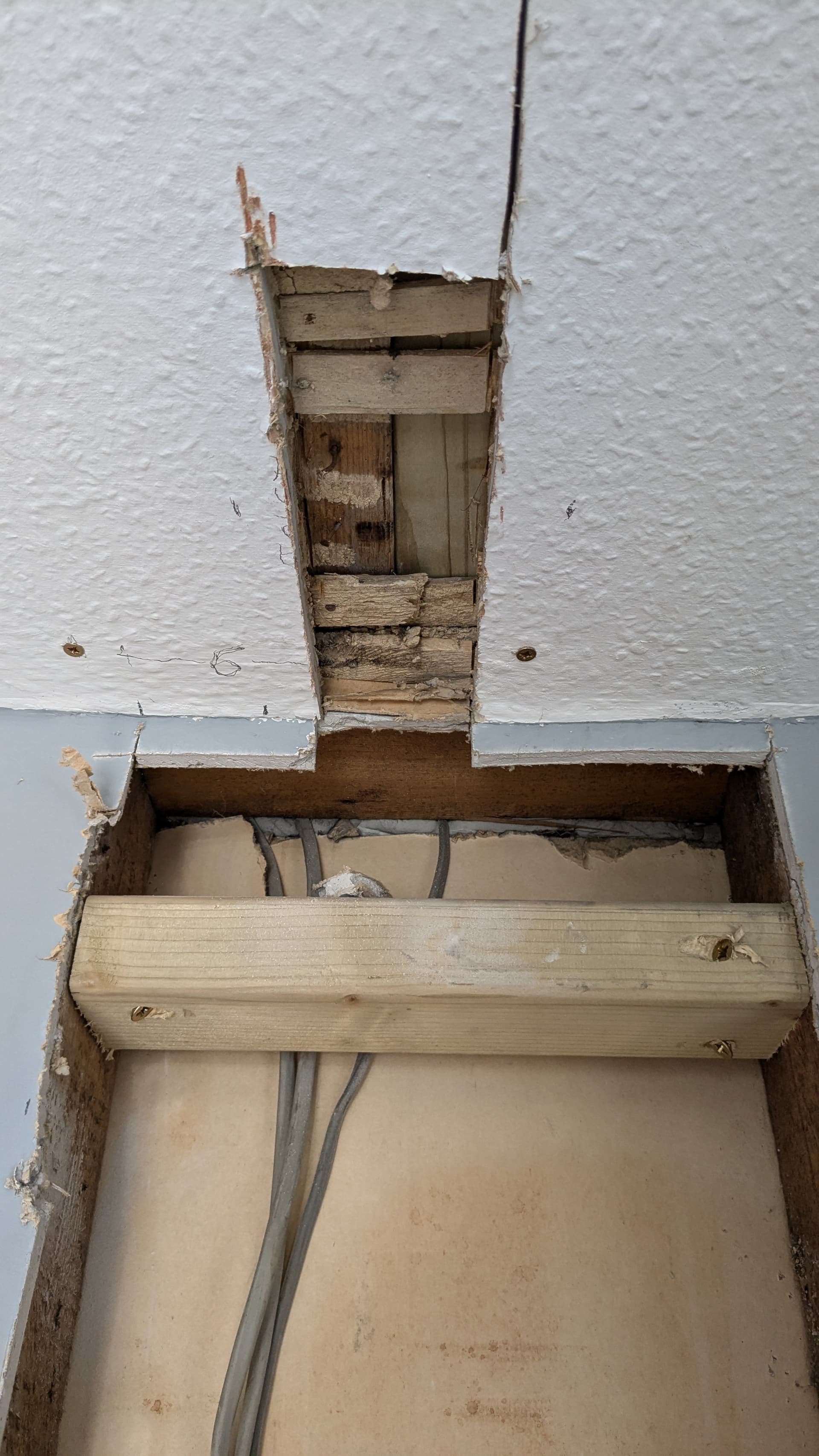

10

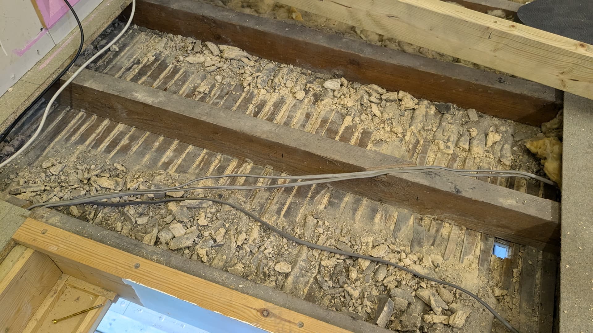

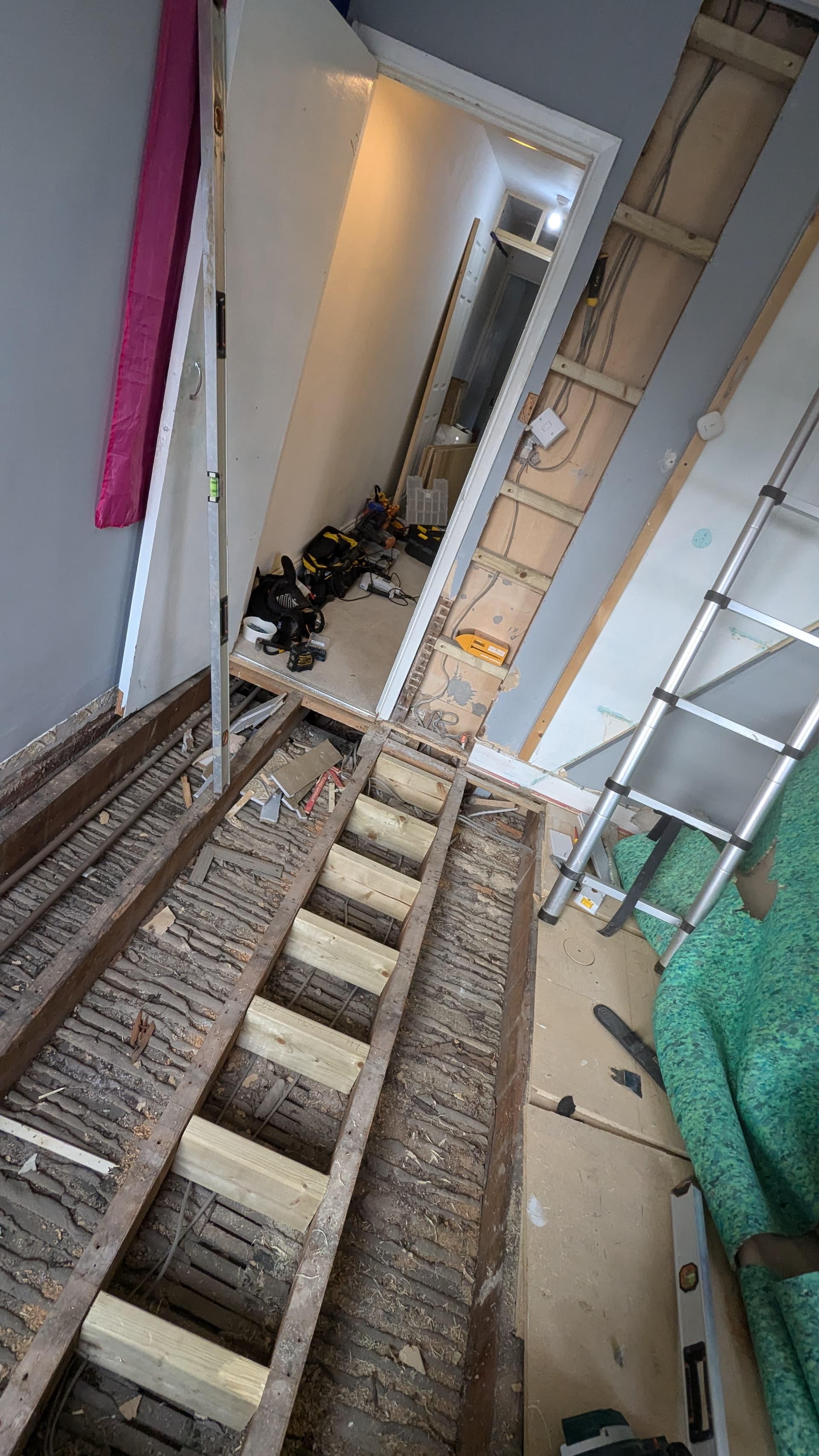

cleared down both sides of the joist
So I could lay a length of 3x2 and a length of 4x2. This gives me more to fix the new head plate to and something to refix the ceiling board, which would fall down if I didn’t.
started cutting through after I’d put some screws in to hold the board up, going through to the new timbers
trial fit of the first stud

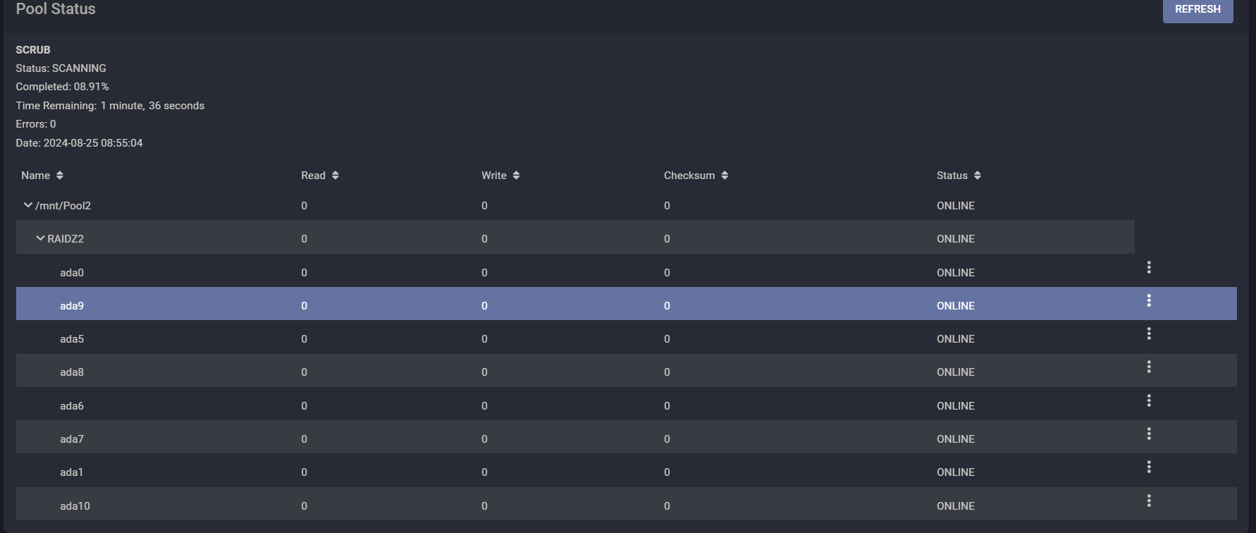

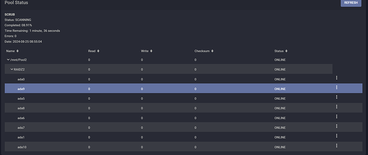

Of course while doing this, always good to do a ZFS scrub as it’s been a month since the last one (took around 6 hours)
This is on a machine that’s only turned on once a week/fortnight to access cold storage, it’s around 70% full (discs are 4TB).

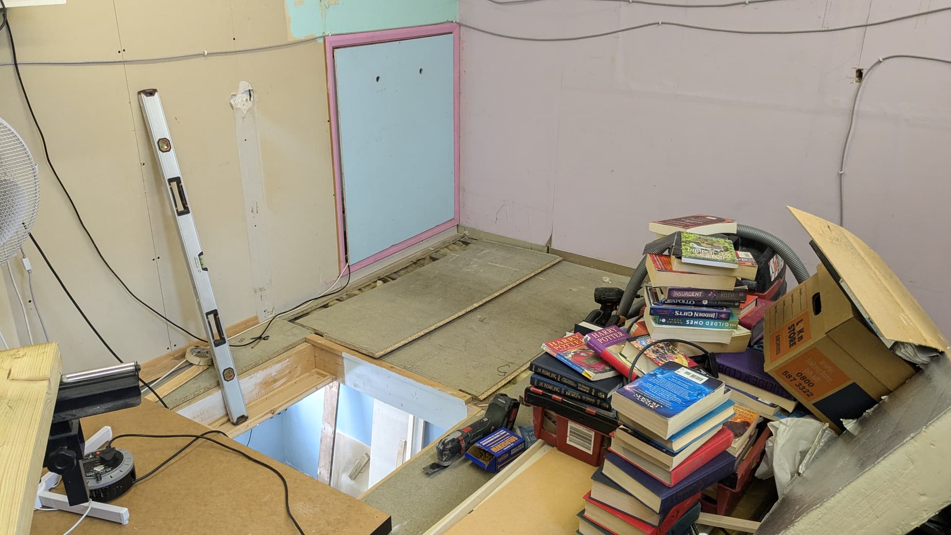

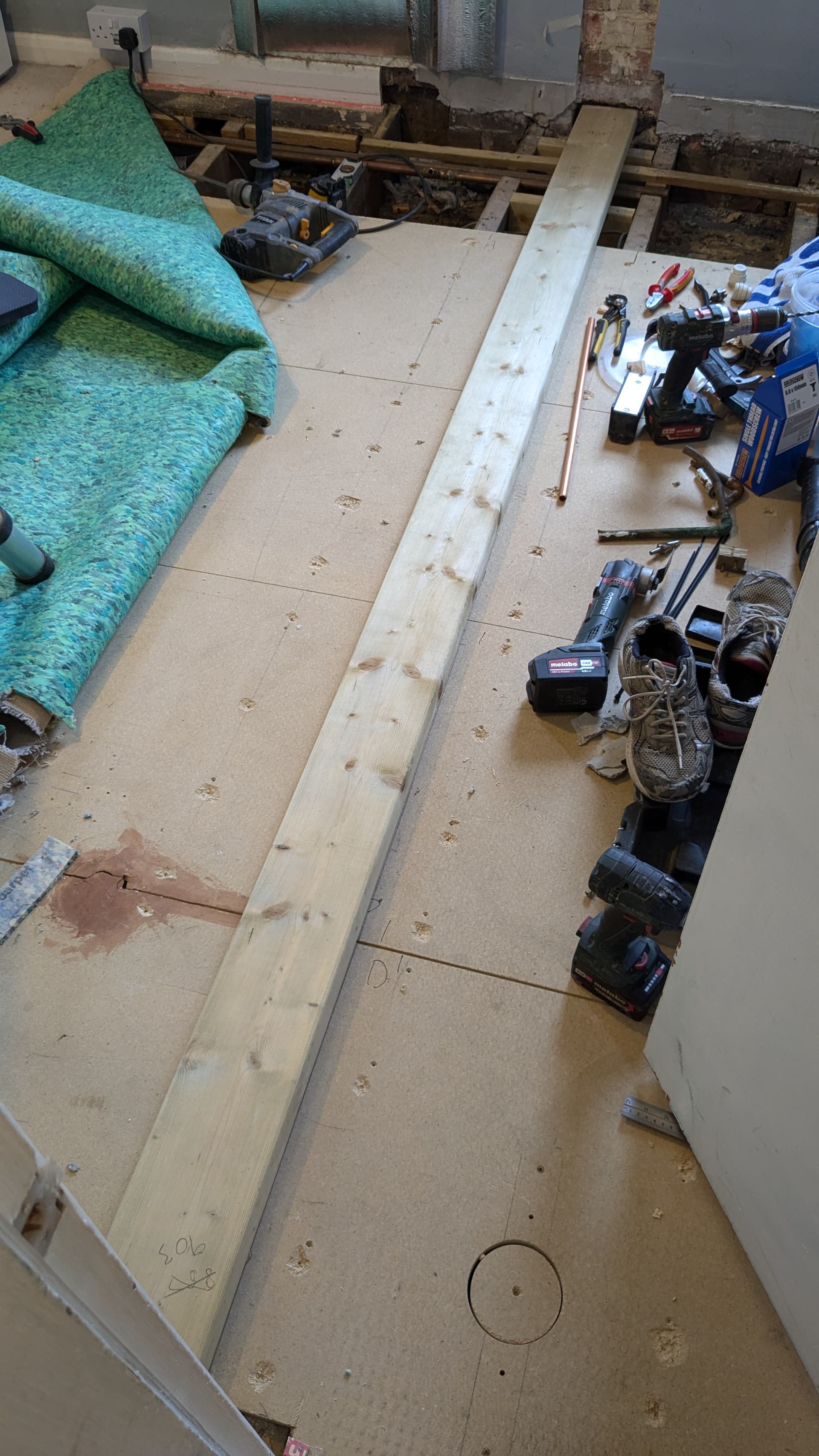

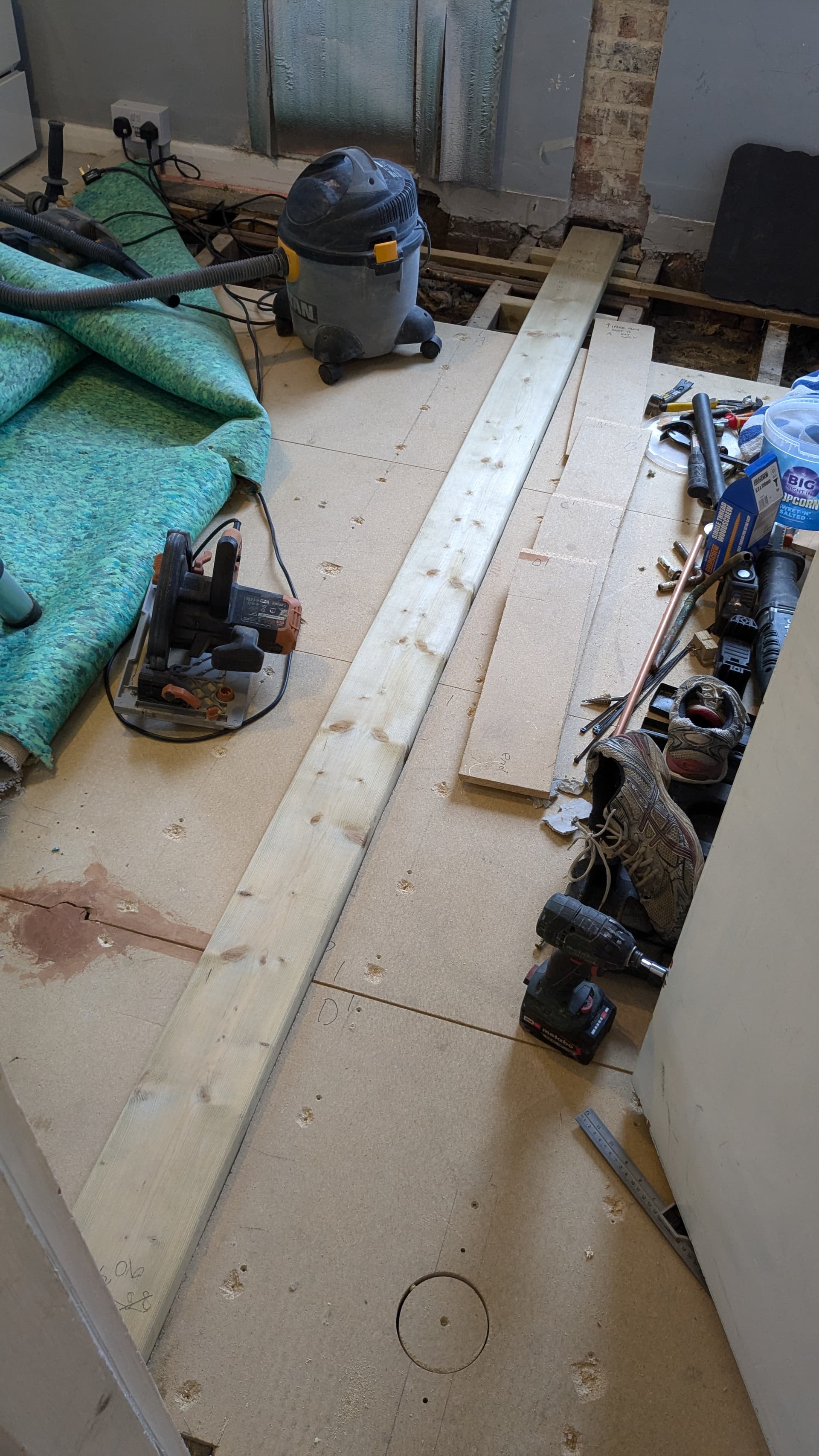

Cleared out for the 6" ceiling plate

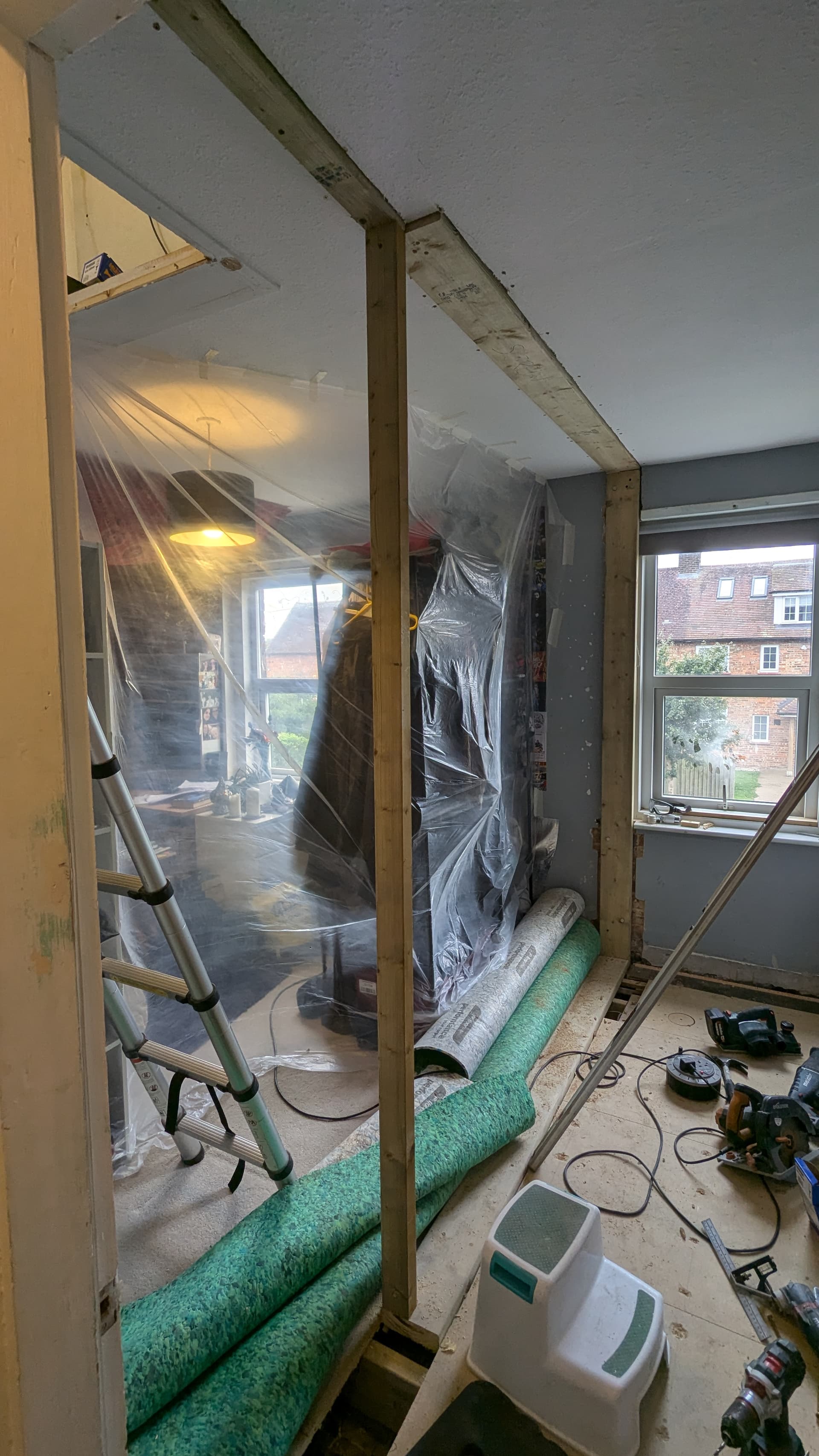

All the prep is finally done,now to make a wall looking thing
Patrick Bateman would be proud of the dust covers, btw…

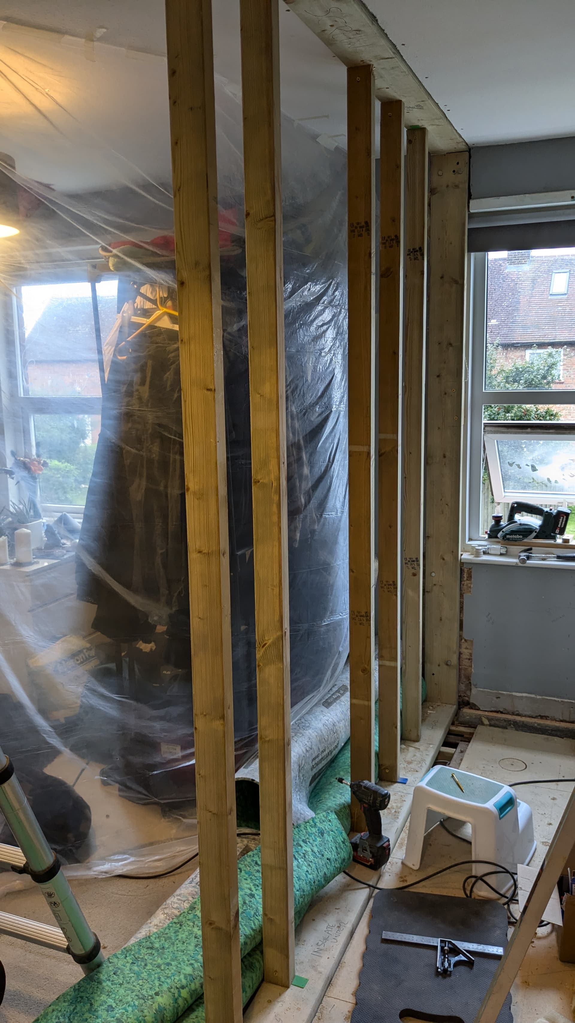

Had to do other things, so not much progress (stepdaughters driving lesson), but more sticks are up

August 31, 2024, 3:28pm
20
I tried to do some video Troop, but I can’t hold the phone and screw
