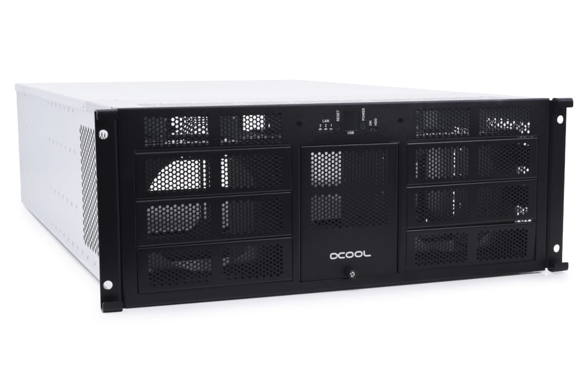

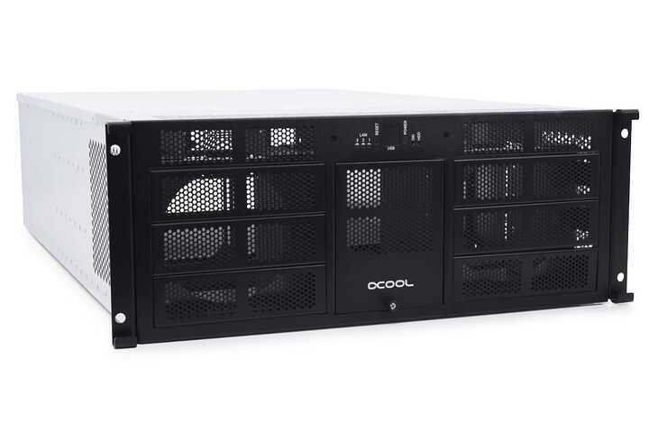

If I can also add one further point to the thread, I can also highly recommend AlphaCool’s 4U server case. It is marketed as for water-cooling, but has all the variability to also be operated as an Airflow-only case:
