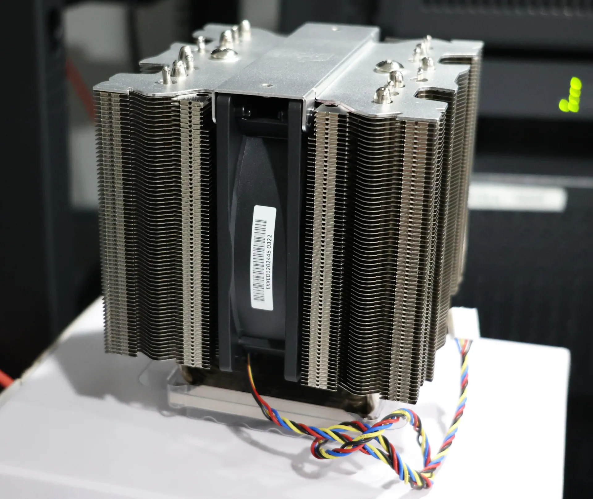

Wouldn’t something like a XED120 WS be a good TR air cooler? Phoronix has it performing within 1 deg C of the WE360-SP5 AIO in their testing:
Also it can hold 30mm thick 120mm fans so it can be outfitted with a T30 fan which is basically the pinnacle of quiet fans that can still perform.
fwiw, i found this list of coolers on an older l1 thread that are supposed to meet specs for the tr 7000 series:
the Noctua NH-U14S TR5-SP6, NH-D9 TR5-SP6 4U, Arctic Freezer 4U-M and abee FUNCTION 4844 are listed as compatible for this application
