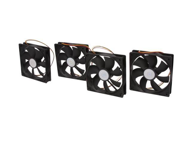

Also I don't generally see noctua fans as worth it when something like
http://www.newegg.com/Product/Product.aspx?Item=N82E16835103052
Spec wise performs about the same at a fraction of the cost. Though they won't be PWM naturally.
