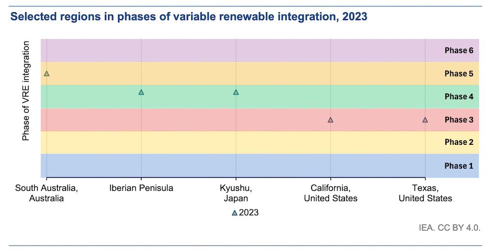

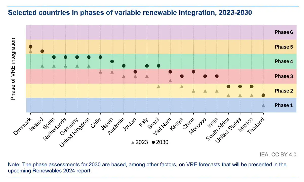

I actually live in South Australia. All of the concerns that are brought up here on a regular basis have either already been solved, or are currently being solved (as in infrastructure is literally being built this very second). Grid-scale storage projects are going up all the time, and now we’re building additional interconnects. The grid hasn’t been this stable in decades. Our biggest problem right now is establishment players (fossil fuel generators) manipulating the national energy market and artificially inflating prices — ripping off the consumers as much as they can before their legacy assets are stranded.
So yeah, from where I sit, it’s almost comical to listen to the objections.

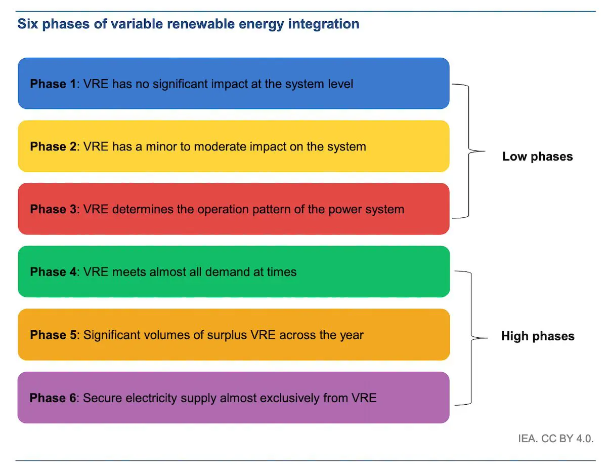

It’s all solved, people. Variable Renewable Energy (VRE) is not a problem. All we’re doing in South Australia now is ramping up.
From The IEA report Integrating Solar and Wind
