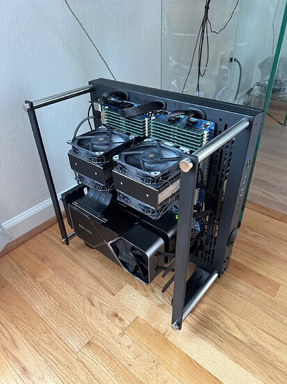

I can appreciate those parameters. I’ve tried both of those scenarios / builds in the past.
But I do mind dust…. But dust has not been an issue in these past few builds.
My enemy is heat and noise, so quiet and cool were the goal

ThermalTake is not what they used to be but they still put out some solid products. I’m assuming you have the white version of the GT given the 4 white mouses. Back in the day enthusiasts chose the Level 10 GT as a favourite for modding because there was so much to work with. In my case (ar-ar) the mods are mild, comprising of an extra internal RAID cage, an extra fan in the top right side panel (dampened with of all things, pink rubber erasers) and some LEDs inserted in the handle under the red transparent racing stripe. The effect is reminiscent of the tail lights of vehicles at night on a highway over a distance and I find it in keeping with the original theme of the GT.
As for the argument of risking dust in your build I can only say that unless you’re in an extremely dust laden area you’re fine. I’m going to state something that may not be all that popular, but in my well over two decades of PC building it has been my experience that open case cooling beats positive pressure. In fact, even with positive pressure, a closed case will become an enclosure that keeps dust trapped in the components over time. An open enclosure such as yours actually maximizes circulation and helps to keep dust contamination down to a minimum. I can only say to those who disagree that they should get a P3 and test it for themselves. (I got mine for less than the price of a decent test bench and these units also make for terrific test benches.) I’m not suggesting that positive pressure is a bad thing but even with positive pressure intake is required and over time dust will get drawn into the case and the sticky dust will find a new home regardless of how many filters are employed. Environment is also a huge factor.
I would like to add that the presence of a high qualify ceiling fan make open cases work much better.

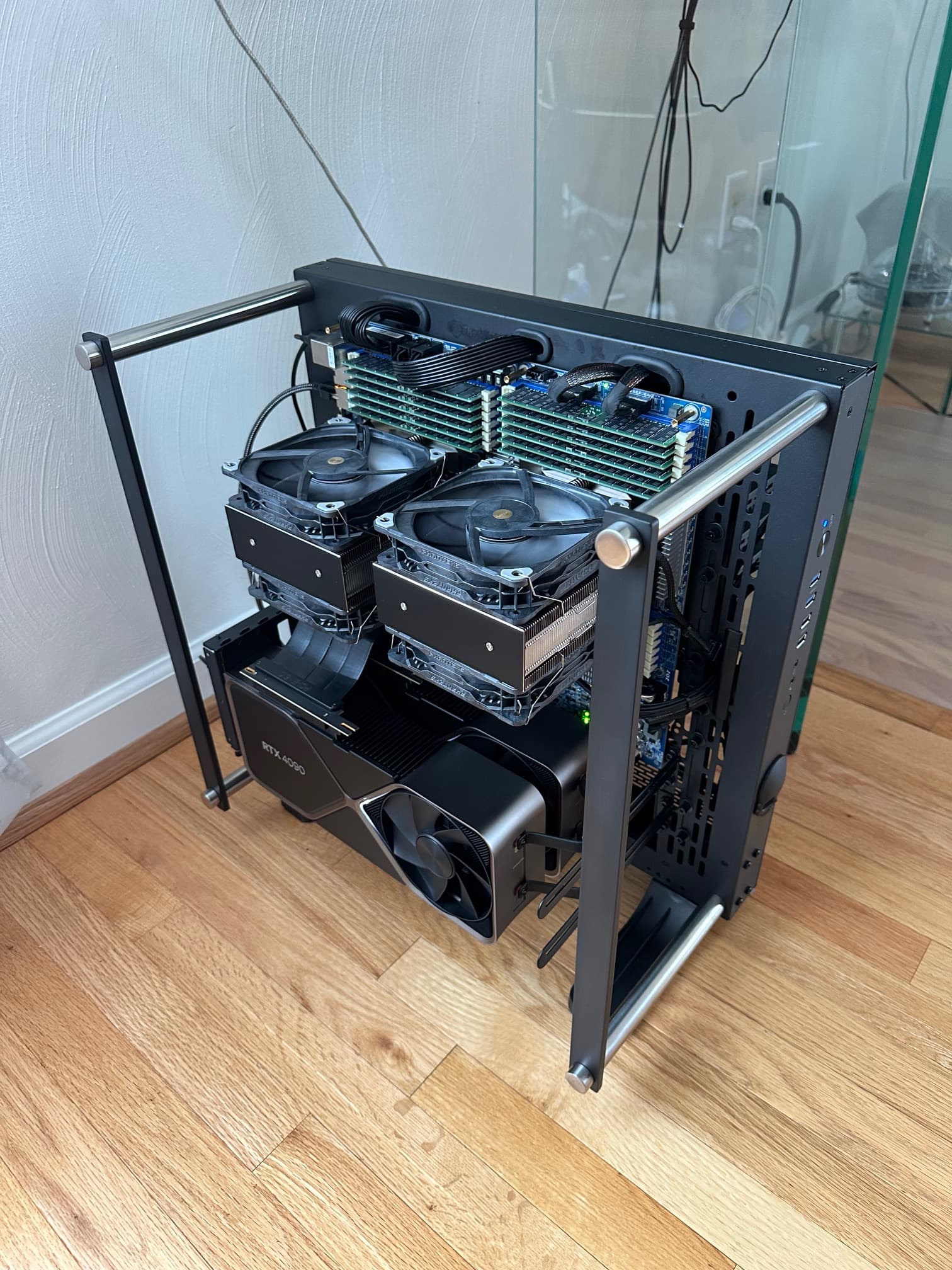

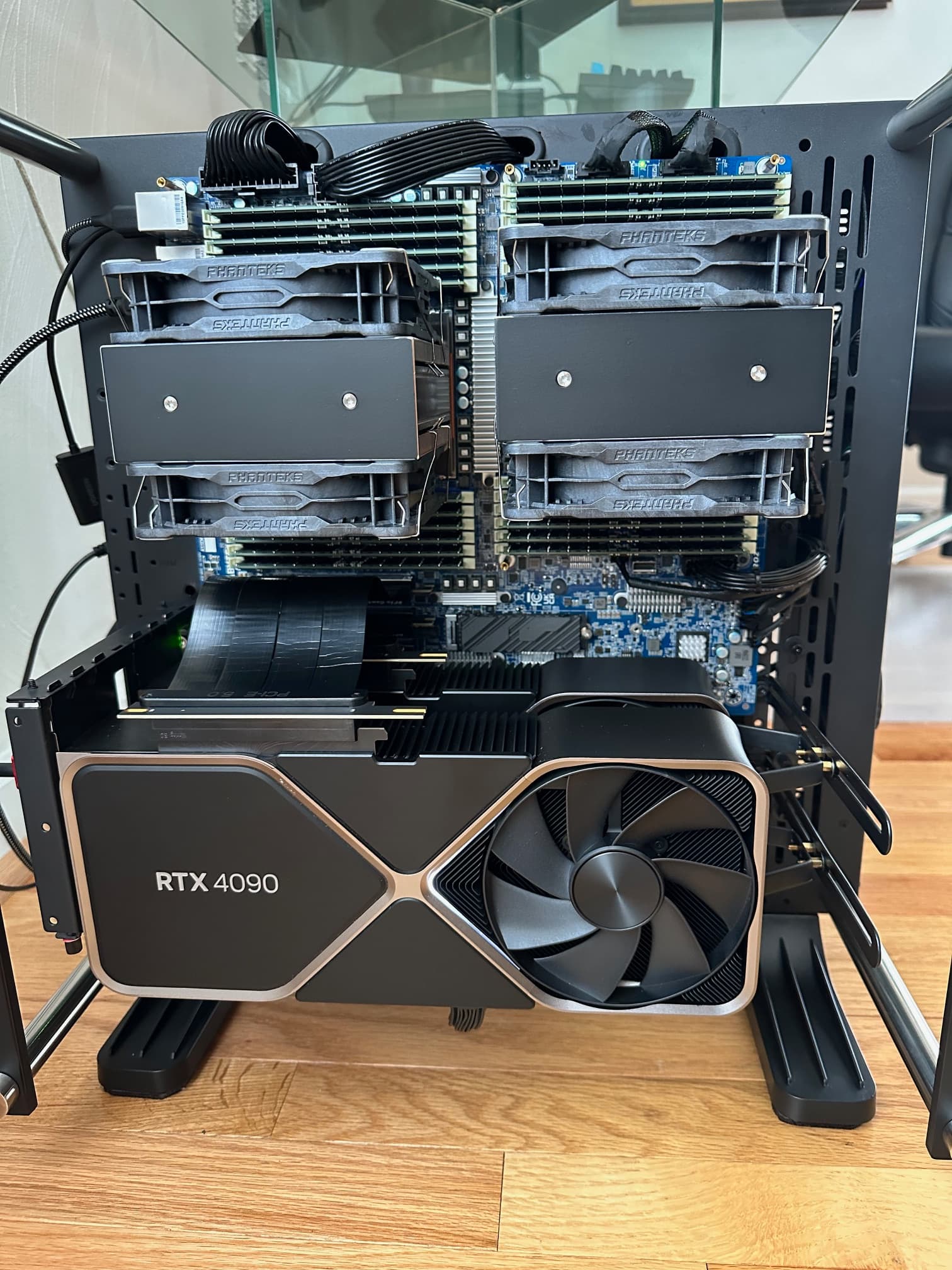

All things considered, I think the current build meets exceeds what I was trying to achieve in quiet and cool.
I don’t think I will be able to effectively air cool the next iteration, this latest build required a lot of configuration and planning

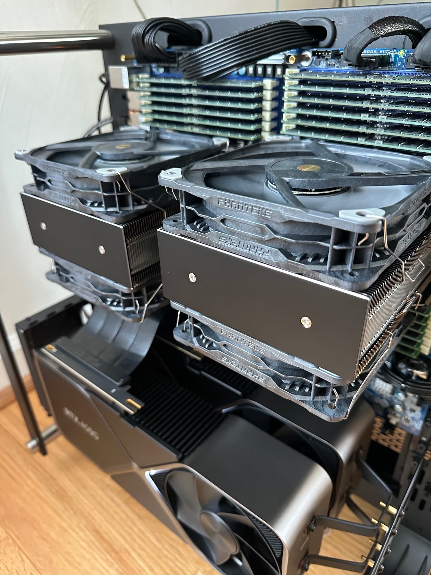

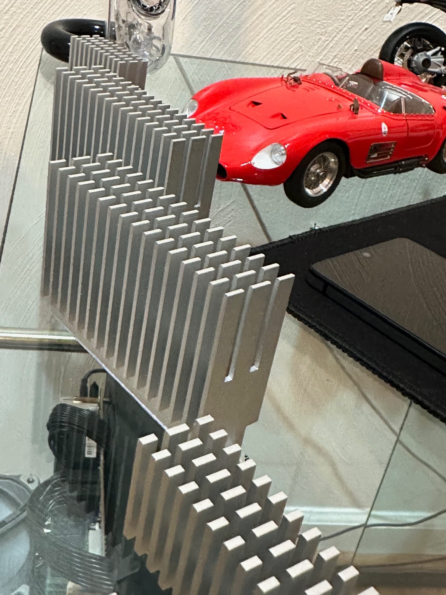

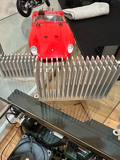

Completed prototyping the heatsink, they performed
as intended, reducing temps a further 2-3C from prior design changes and tweaks
and put in place
Happy PC
So next on the to do list is to replace the other cheesy lightweight short small heatsinks for the Mosfet / voltage regulators etc that came with the board. This time I was able to find them halfway across the globe and specific to this board:
@JayVenturi, Did you create the new heatsinks, or did you purchase them? Why are you replacing the lightweight short heatsinks?

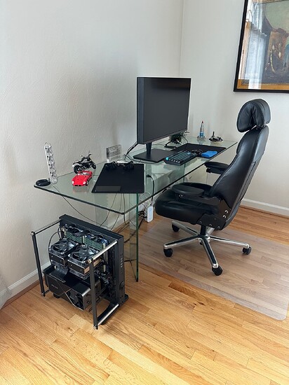

That desk gives me anxiety
