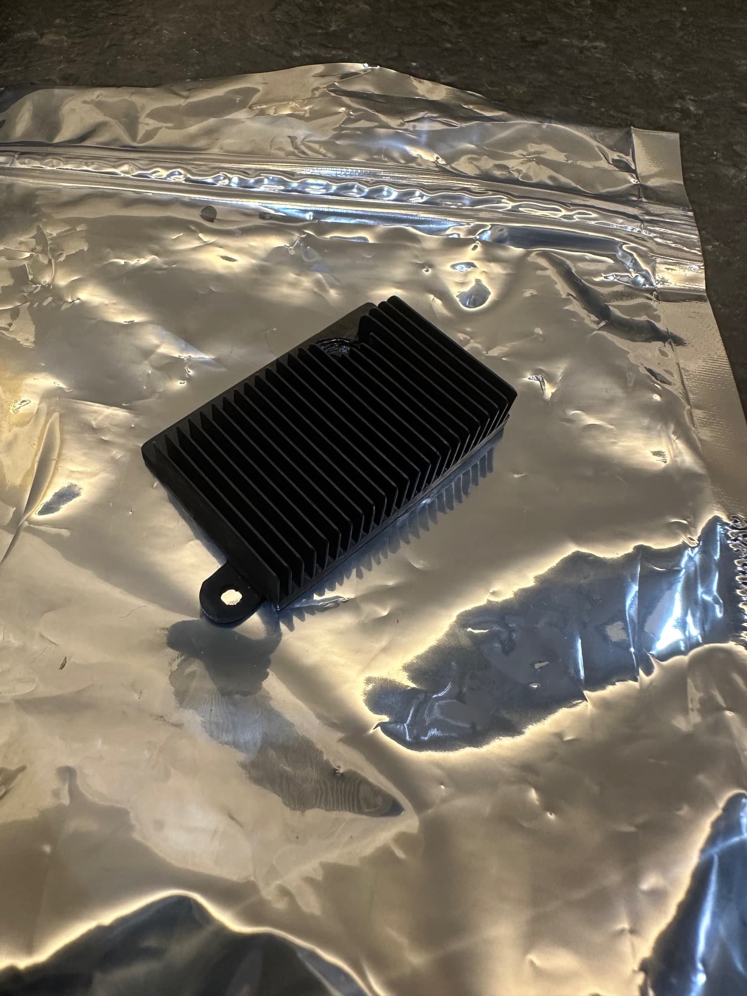

the original looked like this and the next thread will show how a copper dremmeled replacement was made and oxidized black

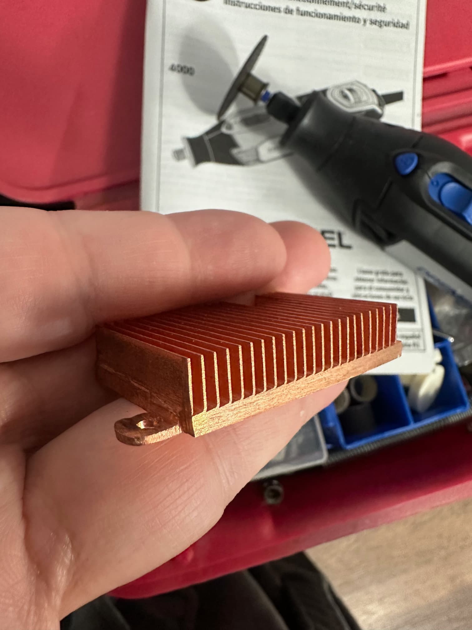

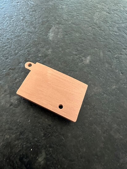

Final product was solid copper, shaved fins, reduced temps 22C on average.
Chip-side copper is polished copper, the other visible side is black, porous pitted to increase surface area.
Pitting was done using wheel brake cleaner (HCL) and vinigar to arrest the process, followed by the brass/copper black oxidizer
original thin aluminium
replacement in pure copper, more fins and increased surface area:
