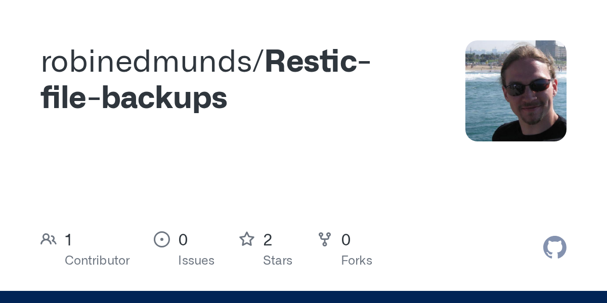

Restic > local repo > OneDrive
I had never heard of Restic but last week I had a play with it and it has won me over.
It is somewhat analogous to git with it’s snapshots and tagging workflow. It includes simple encryption too. I like it!
I have deleted my Bitlocker VHDs and have switched to Restic using a local repository. That local repo is in a folder that OneDrive watches.
OneDrive is still crappy and I will switch to an object storage providers such as Wasabi at a later date as it’s clear from the Restic docs that this is the recommended setup.
Here are some simple PowerShell scripts I wrote to automate backups.
