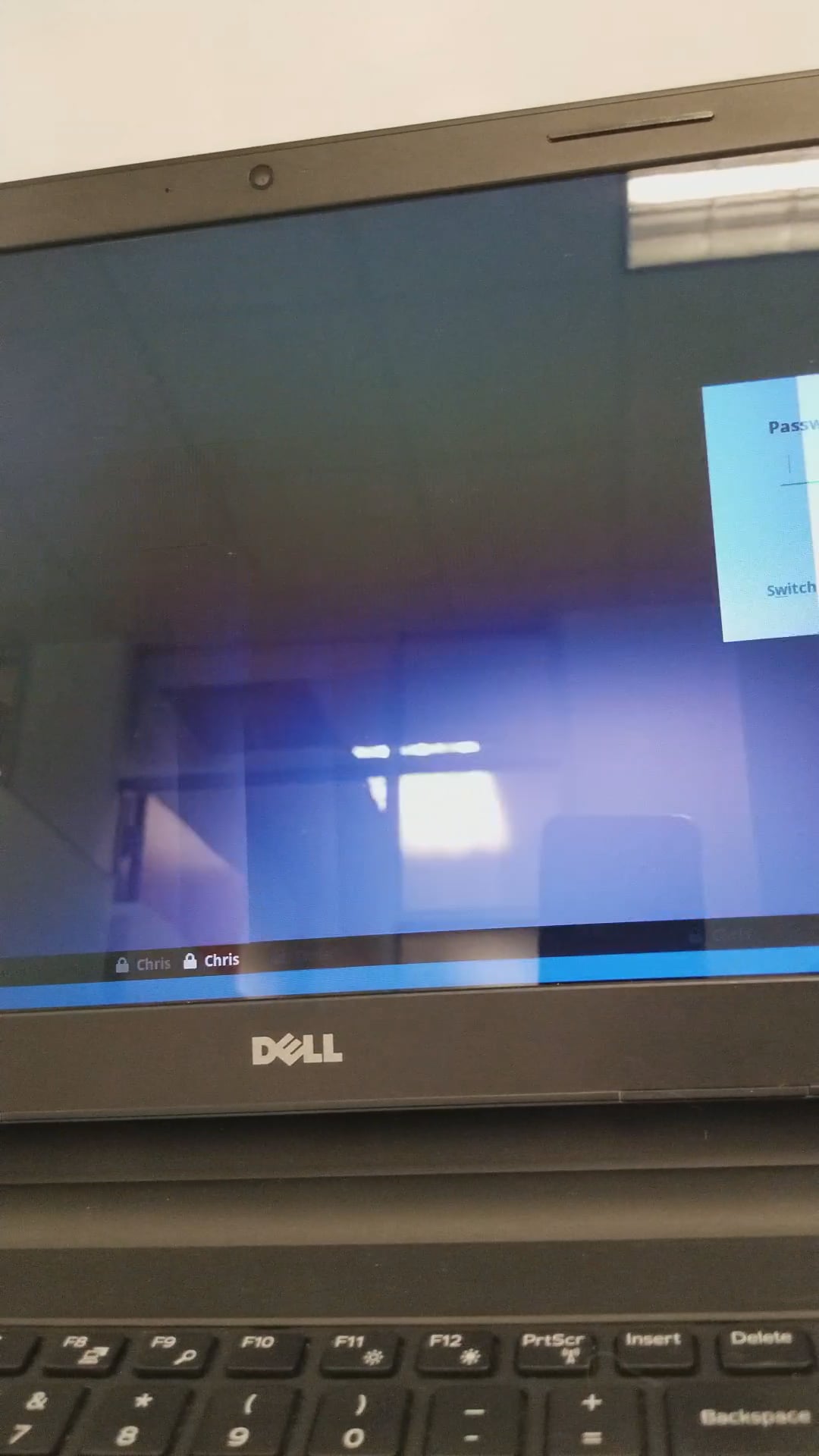

After a couple of screen locks, the behavior in the video occurs upon waking the screen. This is fairly mild compared to other distros, but I thought Iā€™d document it nonetheless.
This happens on every distro, much less frequently on Ubuntu 18.04 and it has only happened twice so far on Solus, which is as infrequent as it has ever been.
So with Solus and Ubuntu 18.04, Iā€™d say it happens every 20 - 50 unlocks. With Debian, Arch, Fedora, Ubuntu 16.04, this happens all the time. In Debian, it happens when I connect to WiFi and open Terminal too quickly. Have to close the laptop to get it to stop, even then it doesnā€™t always stop until I reboot.
I can duplicate it pretty regularly by locking the screen and waiting a few seconds. As you can see above, once I log into Solus it stops.
But, why does it happen, and why does it happen on every Linux distro I use?
Does not happen on Windows 8.1 or Windows 10, Iā€™ve tested to verify itā€™s not the screen or iGPU.
Any suggestions?
Looks like itā€™s failing to sync the stride.
What laptop?
Dell Inspiron 3543.
Itā€™s very random as to when it occurs, but I can definitely duplicate after doing a series of locks and unlocks.
Like I said, in Debian (sadly), this happens so often that I canā€™t use it on that laptop. :frowning:
Since youā€™ve tried many distros, itā€™s unlikely itā€™s related to a kernel version.
Iā€™m not really knowledgeable about these sort of problems.
Inspiron 3543
No hybrid graphics, correct? If itā€™s hybrid, you might be in for a world of hurt. If itā€™s just an iGPU, itā€™s probably fixable.
Have you updated to the latest bios version?
Nah, just Intel HD5000 graphics.
Iā€™ll check the BIOS.
Does NOT happen in FreeBSD either, with Gnome and GDM. Weird.
Thatā€™s odd. Seems to be a Linux (kernel) problem then.
have you tried building a 4.15 kernel?
Iā€™ve not, I will give that a go as well.
Just so you know, these are shots in the dark. Also, if you can find any errors in wayland/xorg/dmesg, that can definitely help arrive at a solution.
I would point the finger at wayland/X. What version of X does FreeBSD have?

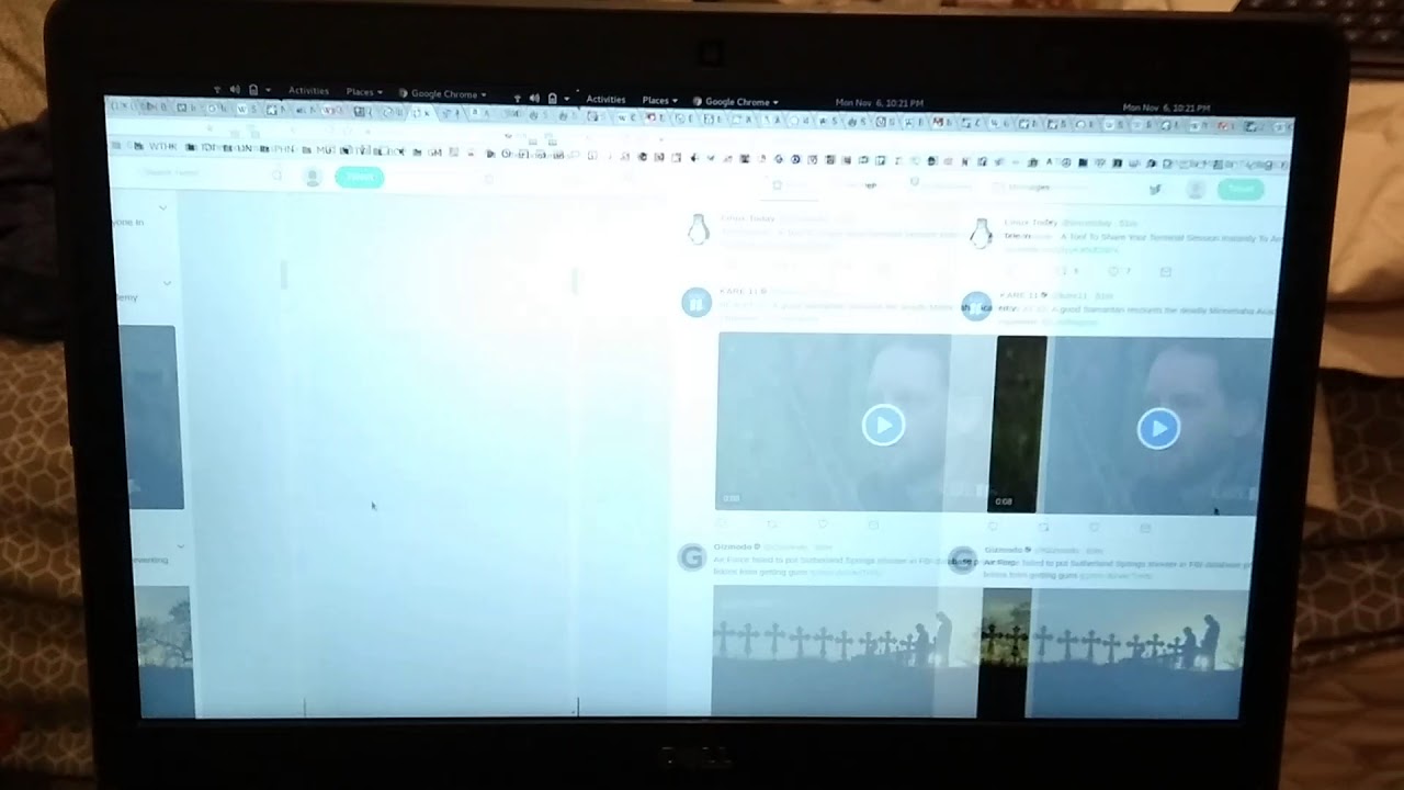

Iā€™ve got a somewhat similar-ish issue with Fedora. System is a Latitude E7440. Happens very sporadically. Been a couple weeks since it happened last. Only way to get it to stop is to put the computer to sleep, and that doesnā€™t always stop it.
WARNING: This is very probably a seizure-inducing video.
Yup, exact same thing happens here. Distro doesnā€™t matter, although it is significantly worse on some than others.
