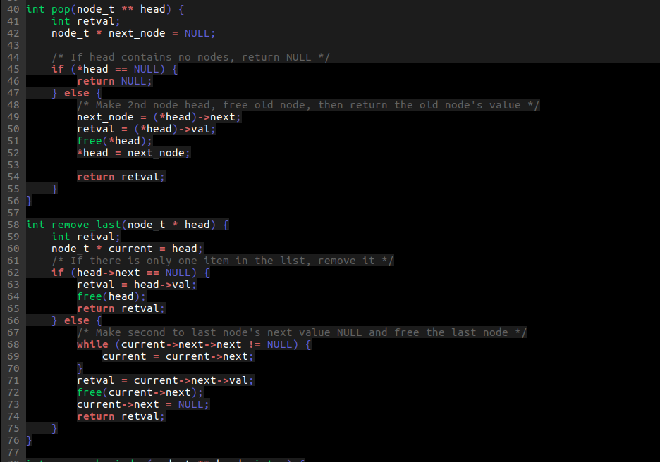

I’m revamping my vim completely and now that i’m trying colorschemes, it doing this no matter what the theme is (if the background isnt black). Anyone has a clue as to what is happening or what line i should add to my .vimrc, i really cant seem to find anyoen running into the same problem online, maybe i’m just too retarded and not searching the right thing tho…

without seeing what you have done to your vimrc its really anyone’s guess. have you posted it on github or something? either way if you are using a Color scheme that theme may do something to the background color of the vim window, or will highlight any white spaces in your code. begin checking there.
Ended up switching from ubuntu gnome to antergos, and rxvt unicode seems to handle colors better, and i dont have the problem anymore.
