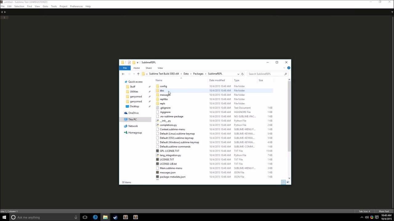

Okay, as mentioned here SublimeText does not support the feature, but there are workarounds. It blows my mind why this is not a standard feature, but anyway. Your suggestion works and I thank you, sir :slight_smile:
I will check the videos to make sure I didnt miss anything.
BTW, If anyone is searching for a IDE to use, here is a nice comparison:
Just get SublimeREPL from the sublime package manager. Just like you did with the linter.
