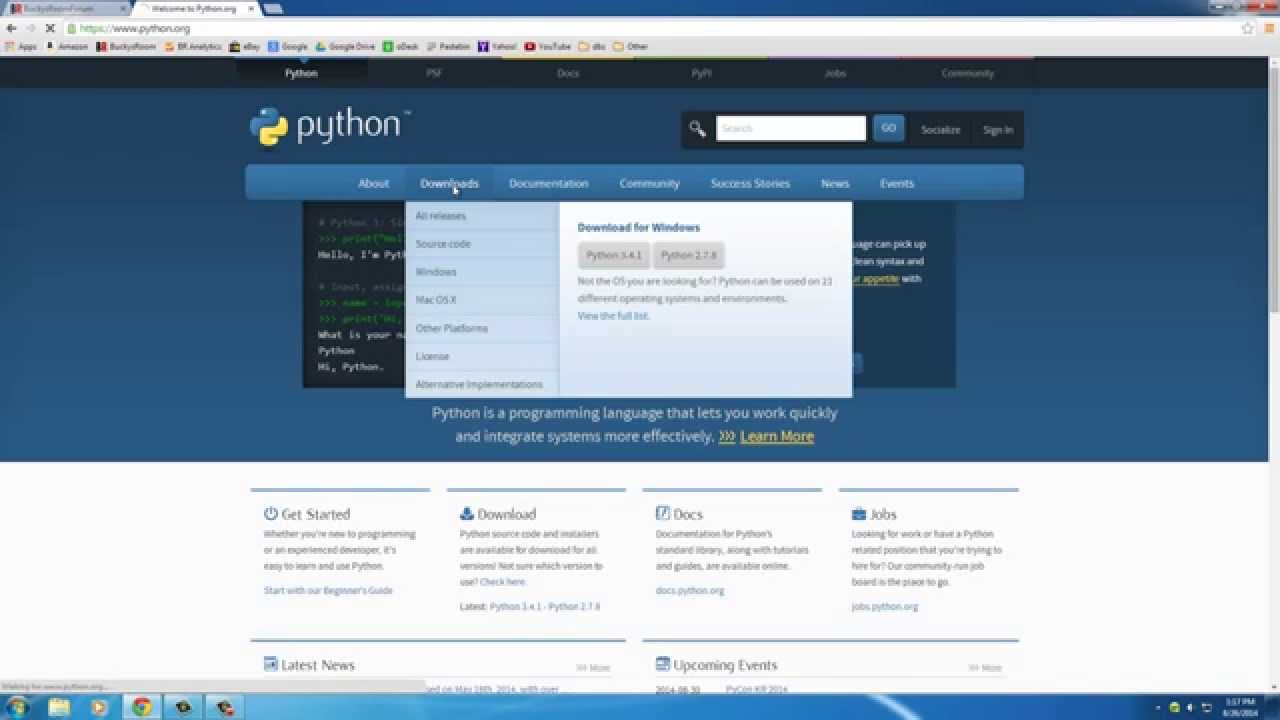

Hello fellow coders,
let me ask for help. I wanted to follow your tutorial and got so far as installing Python 3.5, SublimeText3 with Python linters, copied the first example code, hit Build.
The program runs without errors inside SublimeText3, writes Hello, asks for my name, but then Im not able to input my response. I can write it, but hitting enter does not do anything.
Google suggests to install konsole, which is no good for me since Im doing this on Windows 7.
Also Im quite confused with SublimeText autocompletion function…when I write “tim” it suggests “time”, but when I hit tab to confirm and add “.” it does not bring any further suggestions of functions available. Again, I have to type at least “time.s” for “sleep” to show up. I guess its level1 noob mistake, but how do I fix this?
Thanks for help.
Sounds like you have a couple issues. Let’s start with the Python 3.5 problem first. Here is a video on Intalling Python 3.x on Windows.
for running your code in the mean time you can use idle3.5 which comes packaged with python on install.
Simply open it and, go to : File > New File , here you should be able to paste your code and whe you are ready you can run it as well. to run your code click on Run > Run Module or F5 and it will run your code in the shell.
You can use the cmd prompt to run your python programs, like a Terminal.
As for sublime… That is a bit tricky because it depends on what you want/need to get your workflow going. There are many things you can do with it including having a console integrated… Once you get your code going, post your issue with sublime [ screenshot if possible ] and we’ll see what we can do.
