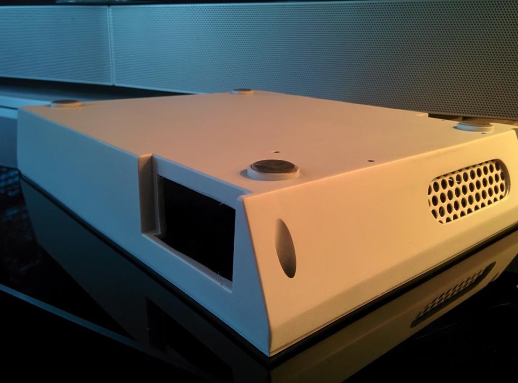

Obviously the most challenging aspect of a NES build is the space constraints. If you want to be able to fit in a decent GPU and cooling, you either need to use a pico PSU or move the power supply outside of the case. It sounds like you are planning to cut out all the standoffs, remove the channels on the bottom and then level the bottom with a lexan sheet like in the 3.0 build. This should provide you with enough space to fit in a small GPU and use a pico PSU if you want to house all of the components within the case.

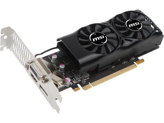

I think imma go FM4 not sure yet still debating I am gonna get a GTX 1050 ti thosince that's the only low profile card I can find
That would be a pretty dope project the NES o ordered the front cover that Hinds the carterage was broken off so imma just turn that into a large vent hole with some mesh haha
yeah, 1050ti is the go to for low profile at the moment

The gigabyte one is the one I'm actually gonna go with it's the smallest one that will fit vertically in the NES. I still need to figure out how imma mount it in tho haha. Right now I'm focusing on prep and everything else later. One step at a time I think I'll start a build log
