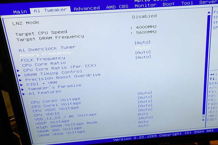

I’d set it manually to 4800MHz. The high capacity RDIMMs are hard to run for the CPU and I’m worried the auto setting might set it to 5600MHz or 5200MHz which might be too much.

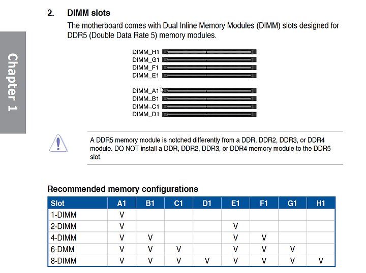

If only one DRAM, please install to DIMM_A2 slot
two DRAMs, please install to DIMM_A2 and DIMM_B2 slots
If four DRAMs, please install to DIMM_A1,DIMM_A2 ,DIMM_B1 and DIMM_B2 slots

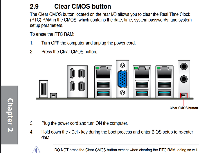

CMOS RESET:

It works fine with 1 DIMM in any of the 8 sockets - I’ve done it before to troubleshoot issues with my own board.
so - should i clear CMOS and then install a second ram stick? I dont understand what clearing CMOS is meant to do here.
It resets everything to defaults and forces memory retraining. If you end up having to RMA the board, Asus support will ask you to do clear CMOS anyway as part of their troubleshooting script.
i understand - but should i add a second dimm to after CMOS?
not immediately
i didnt see EXPO in the AI overclocking
yeah, it’s a binary switch:
If AI overclocking is enabled, then you cannot EXPO as well.
So disable all overclocking you can find,
reboot to UEFI and disable any overclocking,
then reboot to make sure it’s posting again with overclocking disabled
then begin by adding 1 DIMM
ok i dont see any ability to turn ai oc off… just auto → manual
manual
switched to manual. I added a stick of ram and it booted but it looked like it was maybe not recongized? Still said 64gigs in the bios

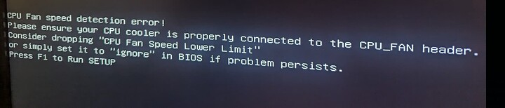

so i noticed this on boot: cpu fans are spinning but dont see rpm in bios. Idle temps seem fine. 48ish. Around 50c.
noctua fans?
