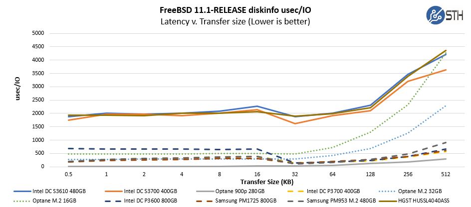

The log drives (or slog as some call them) are dedicated drives for the ZFS Intent Log (or ZIL). These drives are only ever written to in normal operation. They speed up disk writes by committing write intents to NVRAM and reporting this back to the writing process, so it can continue writing. The log drives are never read from unless something goes wrong. Data is instead committed directly from RAM to the main pool. Thge only time they are ever read from is during boot/import of a pool that has suffered an unclean shutdown. ZFS will then read the ZFS intent log and re-assemble the final writes where they belong before finishing the import.
In this application, low latency is king, thus the Optanes. They only ever hold the last few seconds worth of writes, so they can be very small. Smaller, and older Gen3 optanes work very well in this application, and these can still be found relatively inexpensively.
A slog drive isn’t necessarily required. They just speed up sync writes. Without them you may find that some writes are very slow as they go to a ZIL inside the main data pool instead. You can speed this up by configuring your pools to disable sync writes, which makes writes really fast, but now if something happens (server crash or power failure) you lose your in-flight data that is in RAM but not yet written to NVRAM.

Over the years (as SSD’s have become more affordable) I have used the following for log devices:
  • none at all
  • two 128GB sata SSD’s
  • two 512GB SATA SSD’s
  • two 1TB SATA SSD’s; and finally
  • two 4TB NVMe SSD’s.
In all but the last configuration, in my use case, the cache hit percentages were absolutely atrocious. I kept increasing the size hoping I would get to the point where finally a reasonable enough proportion of my random pool reads would be cached in the log, such that it sped up reads overall. This did not happen (for me, with my use) until the log hit 8TB.

The justification for using logbias=throughput is that NVMe devices write fast enough that you no longer need a ZIL for sync writes as they will complete fast anyway. In my testing this just hasn’t been the case.
I have tested normal NVMe devices and found that sync writes are still very disappointing on most of them. The fact that your data pool is on NVMe does not seem to negate the benefits of a proper SLOG device. I’d argue that this belief is mostly a myth, and if you want fast sync writes - regardless of what devices your main data pool is on, a good SLOG is the way to achieve that.
Optanes are one awesome way to accomplish this, but they are no longer being manufactured, and the existing supply out there is quickly drying up. Another way to do it is with battery backed RAM drives (like ZeusRAM) which work very well because SLOG’s don’t need to be large.
That said, the question is “do you really have enough sync writes to warrant spending money on a SLOG device?”, and that is really going to be dependent on workload.
These days that I have a good slog device in the Optanes I set sync=always on my vm data pool to err on the safe side and avoid drive image corruption. Though admittedly, I do take this approach mostly because the Optane SLOG makes it essentially free from a performance cost perspective. If I didn’t have the Optane SLOG, I’d probably be using sync=standard to try to minimize the performance cost.
Essentially, it is a bit of a luxury which I can afford because I pounced on my Optanes when I saw a good deal. It is far from something I would suggest to anyone is a hard requirement.

The practical realities for SLOG’s - however - is that with a few notable exceptions (like ZeusRAM devices) they aren’t available in sizes that would be suitable for SLOG’s. This is especially true when you limit yourself to only devices that make for good SLOG devices.
Most SSD’s (even enterprise NVMe drives) are utterly horrible as SLOG’s. They simply do not have low enough latency to be good in that role.
Servethehome did a good writeup on this a few years back:
The lowest latency possible is key here, and as you can see, Optane drive absolutely trounce everything else. This particular test is a bit old, but nothing much has changed here. Even the most fantastically expensive Solidigm NVMe drives are still much higher latency than Optane and will perform worse as SLOG.
So you might be able to find smaller drives, but they are unlikely to be drives that are good for SLOG duty.
An exception there can be the 16, 32 and 66 GB Optane M series drives Intel used for cache back in the day. They are significantly better in this regard than any non-Optane SSD I have seen, but the fact that they are only 2x Gen3 holds them back quite a lot compared to their bigger brothers.
I used to use dual 280GB Optane 900p’s, I chose the 280GB models because they were the smallest models. I now use dual 375GB Optane DC p4800x drives. Again, these are the smallest drives in that product family.
