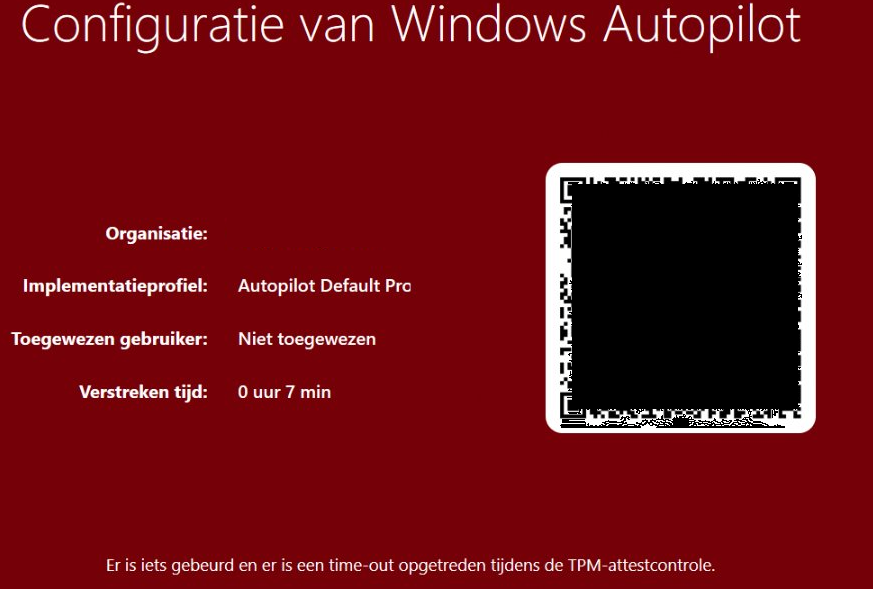

Unrelated to the performance, but related to SCEP Cert error in the Event Viewer… looks like this might be related to Windows && TPM based on some info here (although I think this link was related to issues in Windows 11, not 10):
