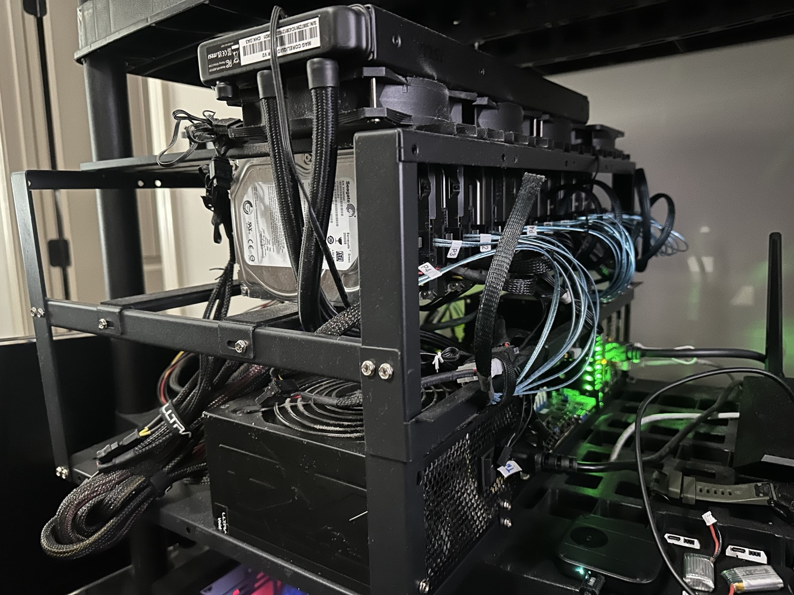

Silverstone CS383. Do my eyes deceive me or is it my dream case?!
Everyone is sharing why not. 24x 3.5 hdd, 40x 2.5 hdd/ssd open airframe case $90 USD at the time with 120x360 aio water cooling with 120mm, 140mm cooling fans. It’s really easy to dust off :rofl:
you could use a cs383 silver stone case :wink:

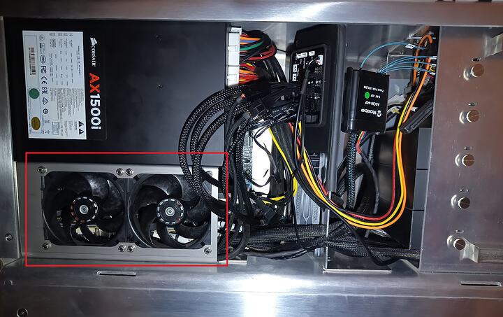

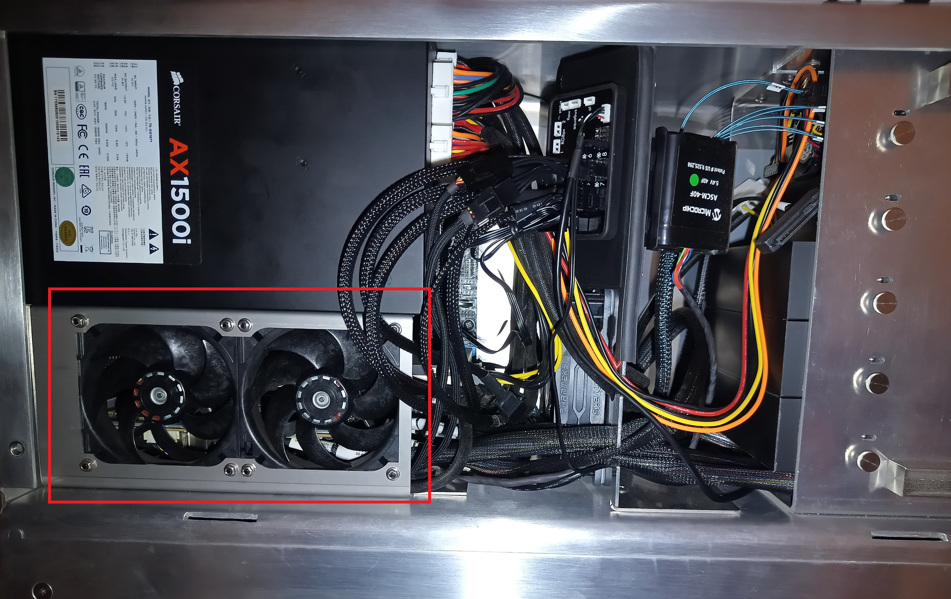

Yes, a Sanyo Denki 9RA0912P4G001 or 9RA0912P4G0011. It’ll do 7.36mm aq at only 37dBA compared to the Noctua’s 43.5dBA, and the noise it produces is more pleasant than the harsh noise of the Noctua PPC. The only downside to them is you need to add your own 4 pin connector to them as they arrive from the factory.
I’ve been using them to cool my PCIe card area and they are very quiet even while moving large amounts of air:
