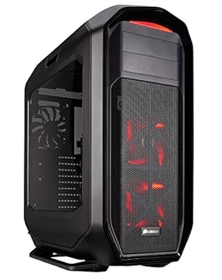

Behold! The Dual E5-25670 stuffed in a Corsair 780T. Did you fall for the meme and build one?

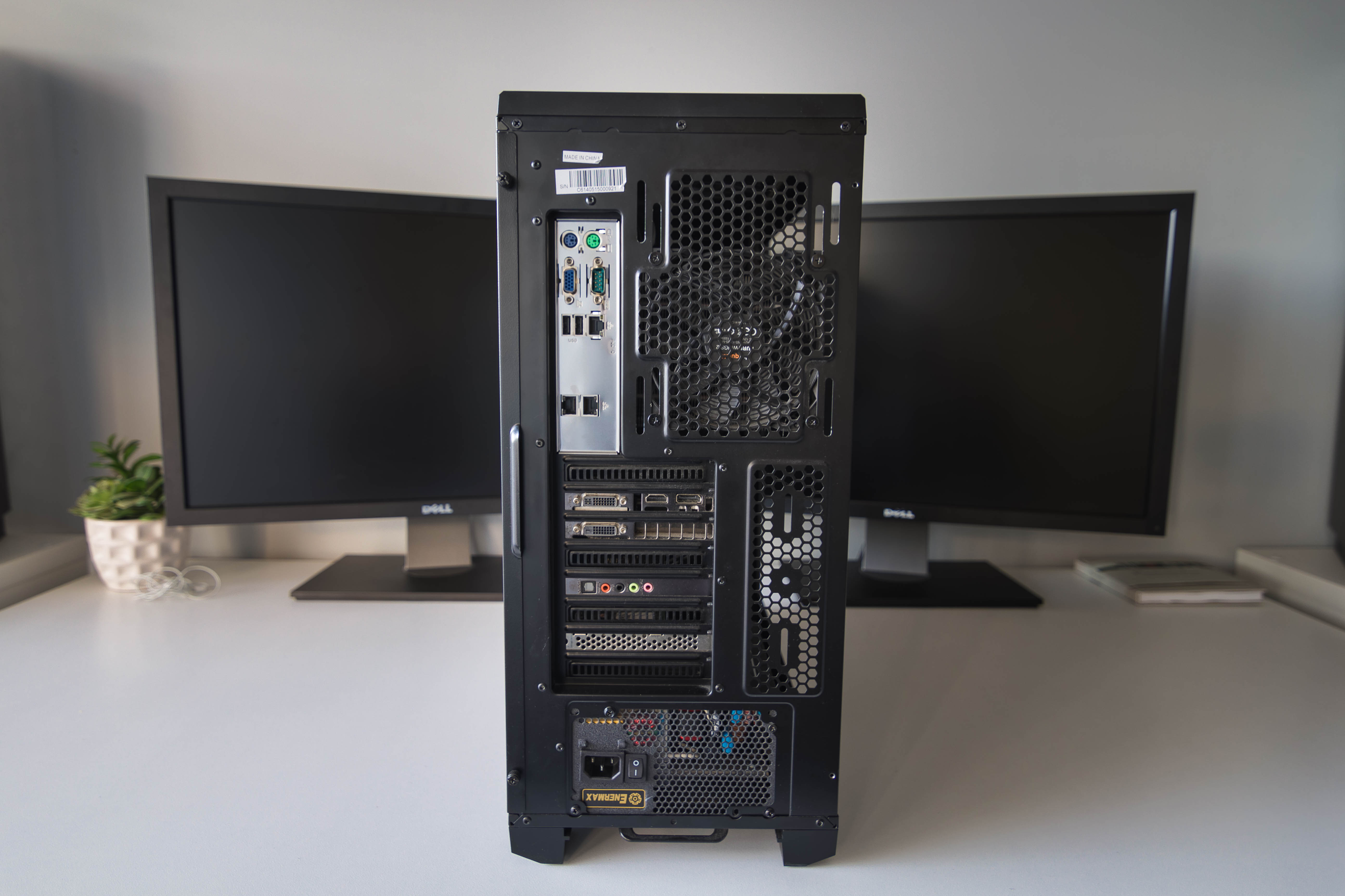

This was my project back in March, and has since received my GTX 780, but she's a beaut! I really suggest taking a read on Overclockers Australia, which is where I originally read up about the E5 2670. http://forums.overclockers.com.au/showthread.php?t=1188021
A good outlook for those in the US wanting to do this kind of a project, use http://www.natex.us/category-s/1865.htm to get your hardware. There is no IO shield included, but you can easily order one from Amazon. This hardware is so much fun! I had a blast putting it all together, I can tell you that after many years of desktop builds, it was well weird to have to insert two CPU's and 8 ram dimms!!
