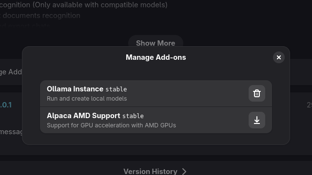

I also tested with Ollama again and it is working without any issues as well, verified it is using the GPU as well. It is also working with Alpaca.
