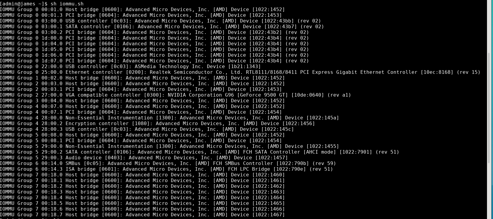

Hey. I have a b350 motherboard w/ R7 1700. Here are the iommu grouping from the machine with only 1 graphics card installed:
Seems to me that if I install a second card into the x4 slot, the machine should keep the two separate as one is running on the 3.0x16 from the mobo, and the other is running in the 2.0x4 from the chipset.
I don't have a second card handy that can fit in the x4 slot, but will update you guys on how it goes once i do
You can install anything in the x4 just to see what it does.
Problem will be no way to boot from the x4 first and leave the x16 uninitialized.
And the x,4 will be put into group 0 I'd guess
