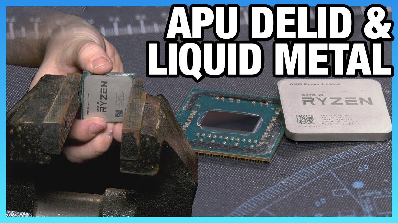

So of course, Gamers Nexus delidded it.
However, this puts more sense that the 11CU 2400G would run hotter with TIM with the stock Wraith cooler. Paul’s Hardware reported high temperatures when running in an open bench with the 2400G.

With a stock cooler though, Paul’s Hardware with stock TIM was hitting 80+C. Wraith Cooler plus a delid and a delid die guard to allow direct contact between the die and the cooler will help for getting those temps down.
I bet any towercooler would fix that without having to delid.
It appears der8auer’s delid tool for coffeelake works on AMD apus if you put the APU in upside down

The LM fix for it gives only 25mhz speed, but what it really give is better temps, and who’s going to fix it?

Again, delidding could be worth it for ultra small SFF PC’s, like the one I want to mount to the back of my TV. Dropping ~10°C could absolutely be worth it in a system with exactly one fan (the CPU cooler) in it and a PicoPSU.
It’s not required of course, but is nice to have the option.
