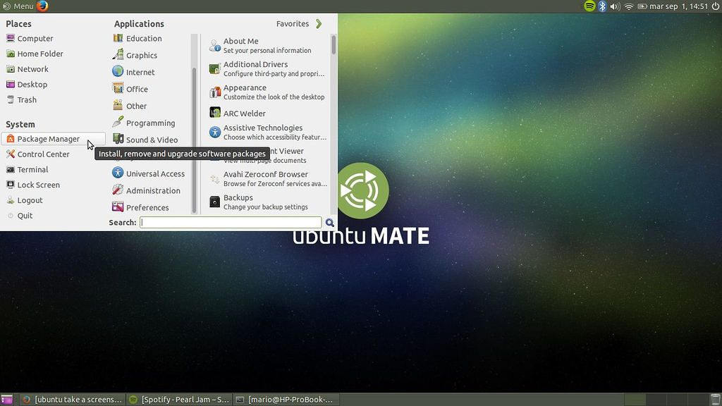

My requirements : A start menu with using the Super Key aka Win log key on the keyboard and functions the same, a single taskbar at the button with reasonably ease of pinning anything to it with autohide and auto re-appear functionality, the rest…I’ll have to see when I tip my toes in that particular pool/distro. Thank you for the fast responses everyone
