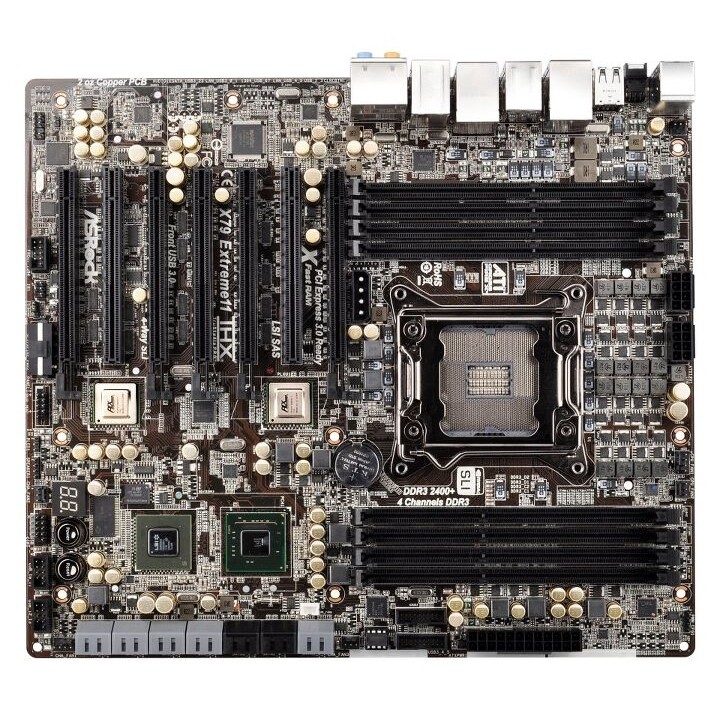

other issues is when hot air blows on ports (some of coolers like msi's gaming one) over prolonged time can melt the plastic port. (happened a lot with lga 2011 mobo's since ram slots were really close to pci-e bus - but it wasn't fault of gpu... just poor design of mobo)
those type kind of mobos had this problem
as you can see pci-e port is pretty much beside 4 memory slots... well easy to melt pci-e port or memory slots... but rx480 is too easy ... you'd need something that uses at least 400W
