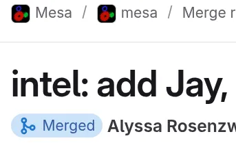

Thanks, I have the PR for Jay as part of the PR I’m using. I couldn’t find any help on how to enable it, but I found this:
https://gitlab.freedesktop.org/mesa/mesa/-/merge_requests/40835/diffs#e4da400ad60b1d7690d71fb29048f4e71edb67ee_305_313
This line of code leads me to think it’s not enabled unless you do something like export ANV_DEBUG=”INTEL_JAY=fs,vs,cs”?
Good catch. Yes, looks like it.
Also might depend on certain hardware/firmware version?
devinfo->ver == 20

The issue is I have no idea what to actually type… INTEL_JAY seems more like a meson flag than a ANV_DEBUG option? My advice is to just rewrite intel_use_jay and the other one so they always return true.
