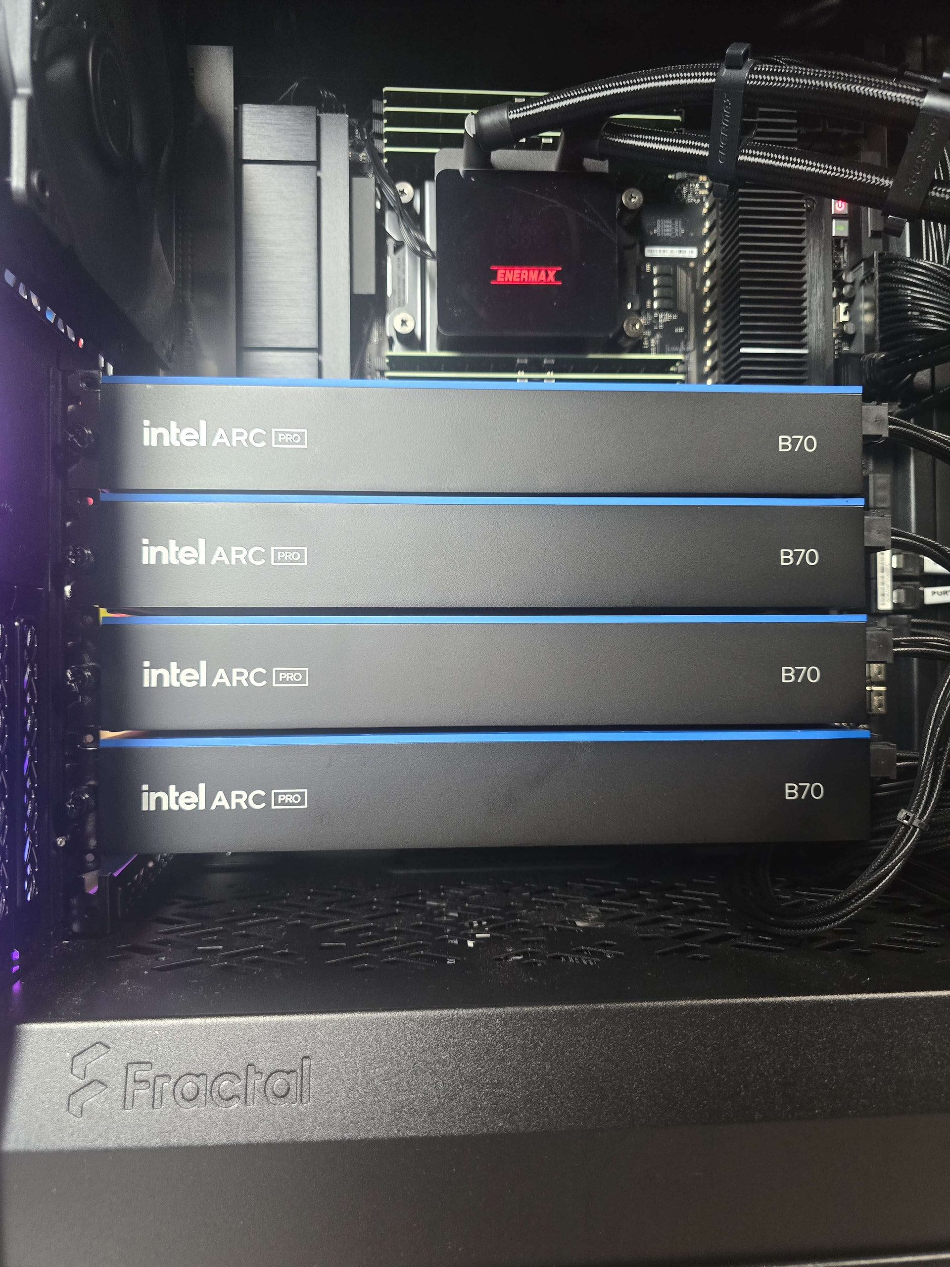

A B70?!? In this economy? And yet this may be the “best” path to 128gb vram for around/less than the cost of DGX spark. Assuming you have a machine to plug them into.
B70 32gb AI llm-scaler (vLLM) testing
 vllm serve /llm/models/hub/models--Qwen--Qwen3.5-27B/snapshots/b7ca741b86de18df552fd2cc952861e04621a4bd   --served-model-name Qwen/Qwen3.5-27B   --port 8000 --no-enable-prefix-caching --enable-chunked-prefill --max-num-seqs 128 --block-size 64 --enforce-eager  --dtype bfloat16 --disable-custom-all-reduce --tensor-parallel-size 4
Avg generation throughput: 540.0 tokens/s, Running: 50 reqs,
DANG!

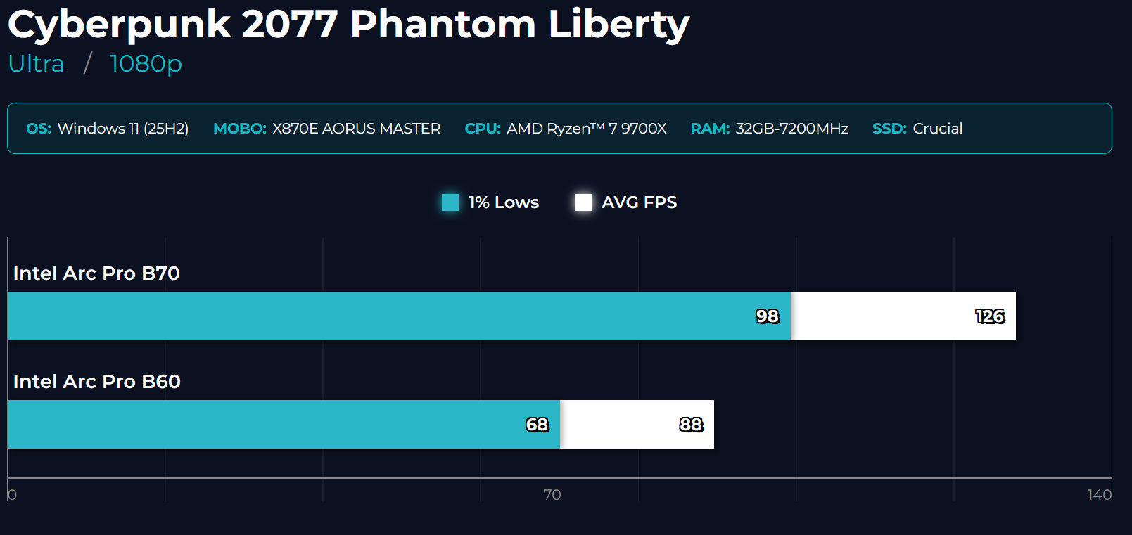

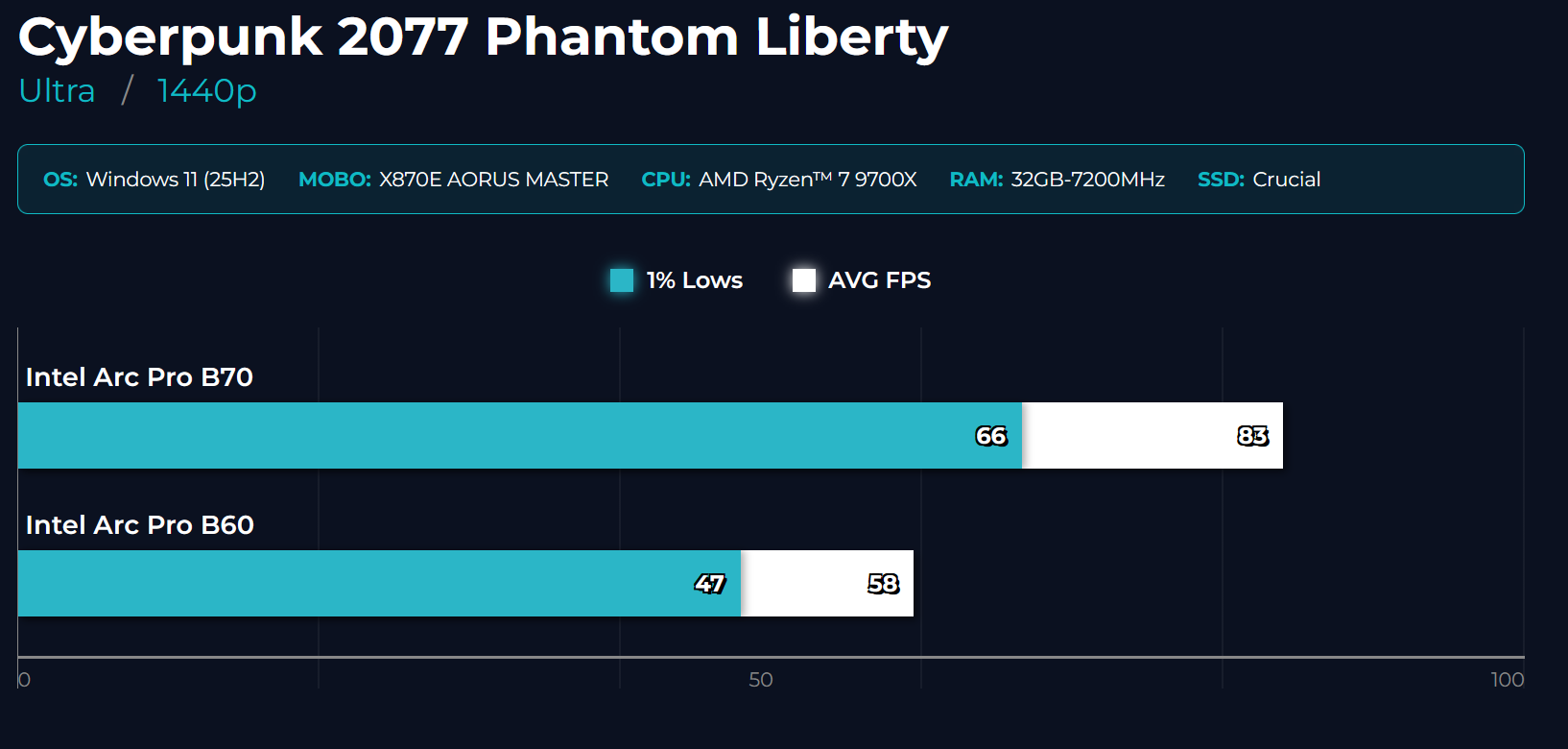

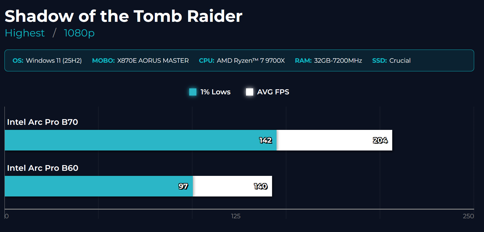

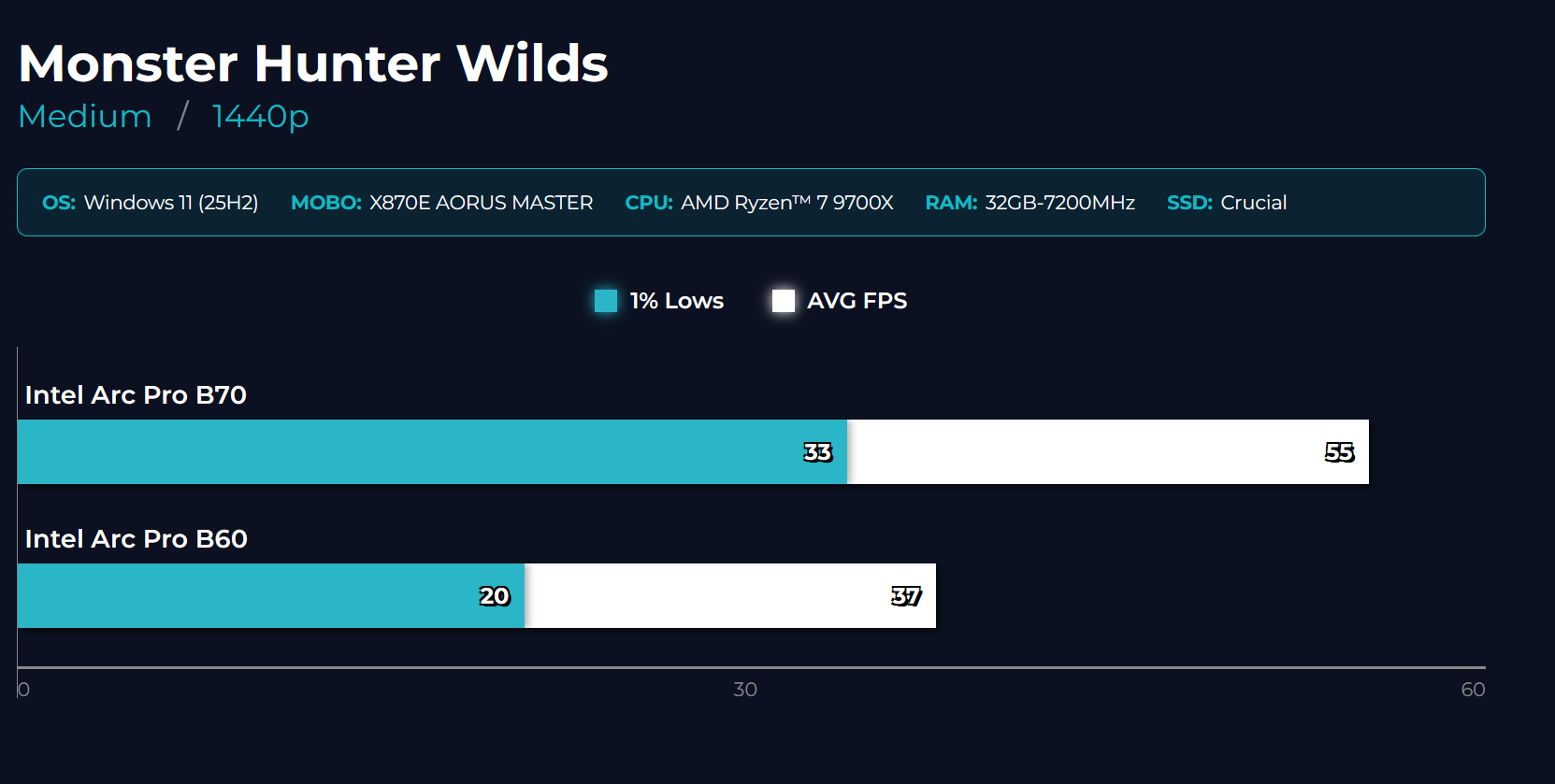

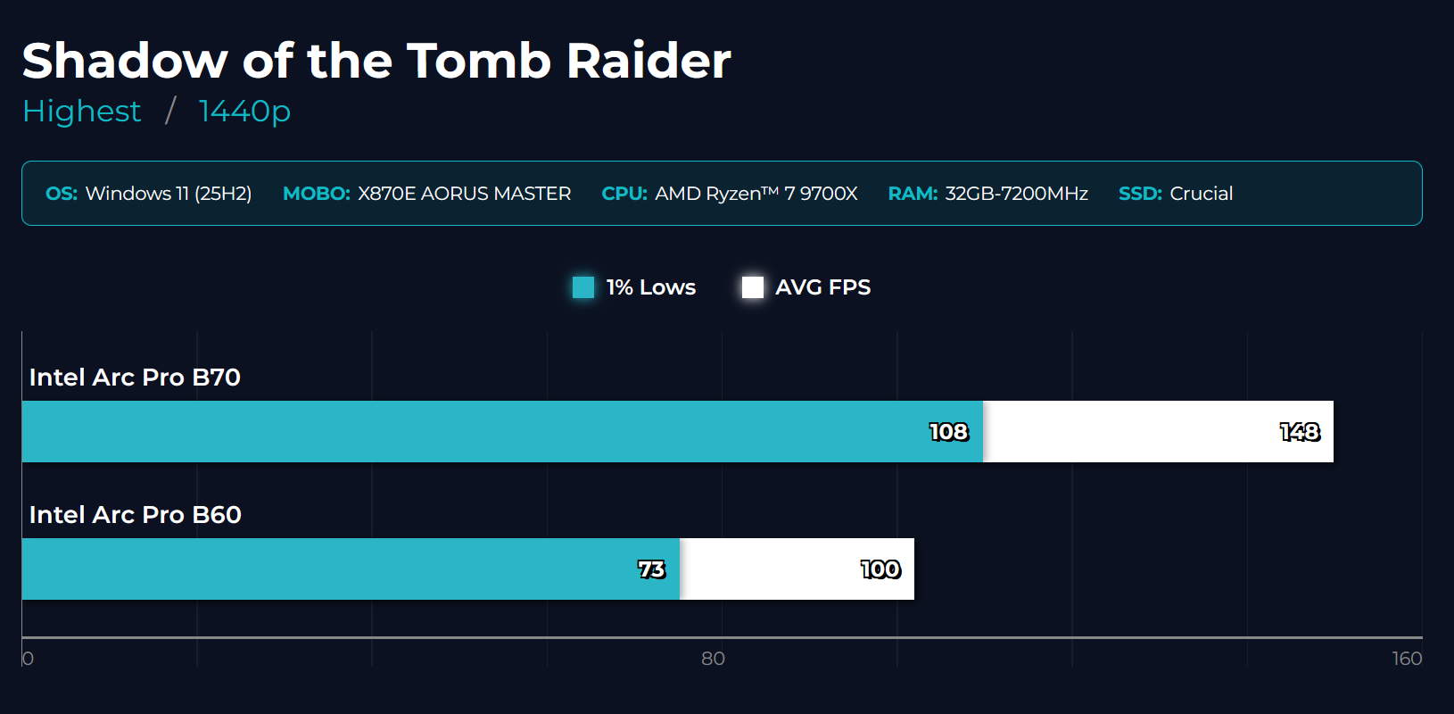

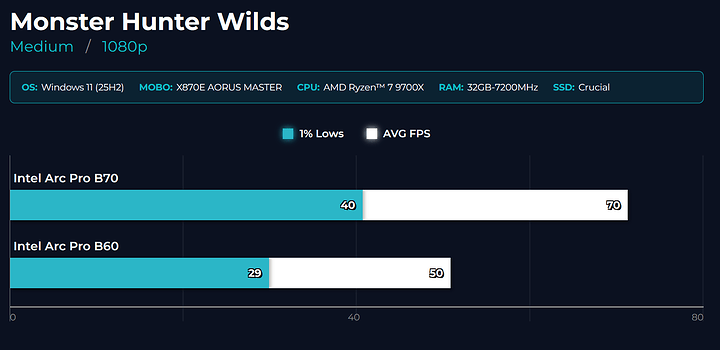

Gaming?

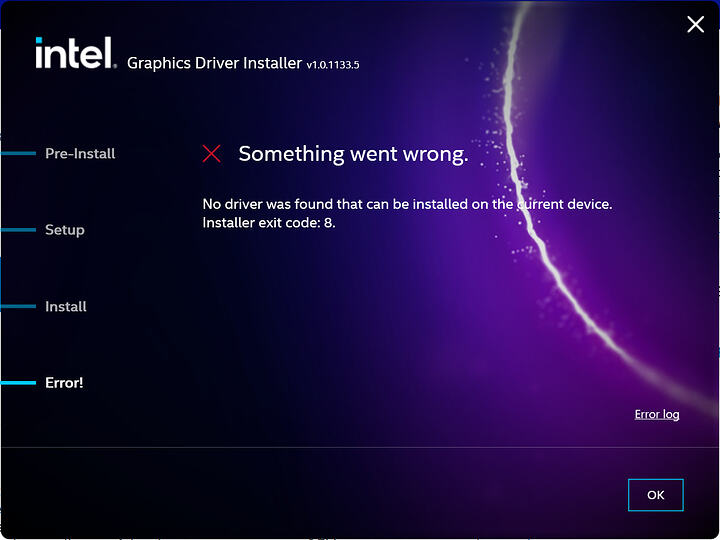

Watch this space. Currently (3/25) we have
UPDATE 3/26: yay driver works now! Here are the results
Cyberpunk 2077: Phantom Liberty - Ultra
Shadow of the Tomb Raider - Highest
Monster Hunter Wilds - Medium
