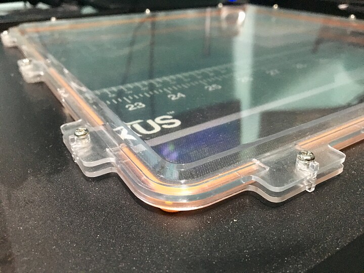

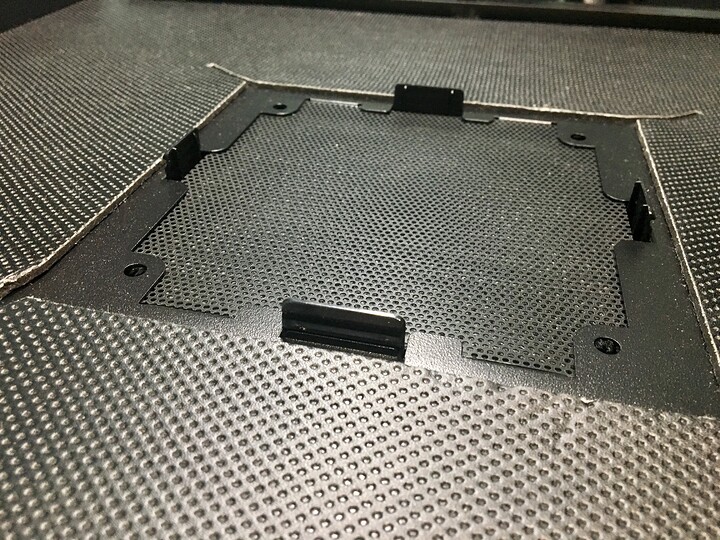

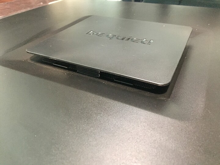

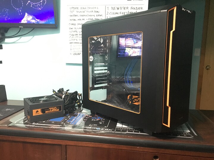

The only BeQuiet! case that I’ve ever owned is from 2009 and has a double layered acrylic side panel and tons of sound deadening materials everywhere. Even the back side panel is vented but has a sound baffle!

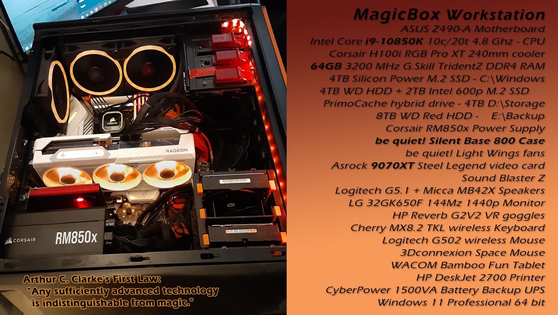

I love my be quiet! Silent Base 800 case.
Yeah it’s quiet and all that, but what no one mentioned is build quality. This baby is built like a tank designed by German engineers. Solid as a rock made of steel. It should last me until the universe dies from heat entropy.
I did compromise the silence by not getting the double pane be quiet! window. I removed the rubber lined steel side panel and got a custom side panel made from thick tempered glass. Not perfectly silent, but it looks way better than a plastic window. Initially I used a ThermalRight Macho Bravo passive CPU cooler and just used case fans for airflow. Later I went with a Corasir AIO. I did replace all the fans with either be quiet! Light Wings RGB units and Silent Wings where I didn’t need lighting. I would say that the be quiet! fans are just as good as Noctua, but Noctua fans may be a little quieter. Hard to say without a dB meter test. I don’t really hear the fans until I do a CAD rendering and the CPU gets hot for a minute. I had a mix of be quiet!, Corsair and Noctua fans, before I made all of them be quiet!

Bottom line: It’s a pretty nice quiet case. Not perfect but darn good.
I can hear it when the AIO fans go full speed, but 90% of the time it is silent. The rubber coated steel panel is quieter than 5mm glass. The Insulation, baffles and muffler stuff work and it still has good airflow with 6 be quiet! fans. 3x SilentWings 140 intake and 3x LightWings 120 exhaust.
