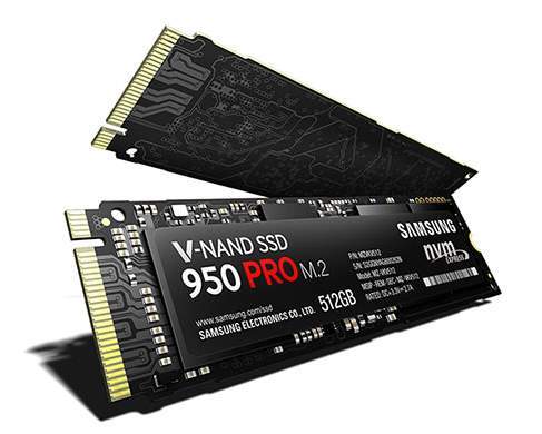

I hadn't considered PCI-e SSD, but that seems like a good idea for use as a working drive, if not for boot. Can you recommend anything? I started looking into Samsung 950 PRO M.2, but the Z10PE-D16 WS motherboard seems to only have PCIe x2 on the M.2 slot, so I'd need to use an adapter into a PCI slot -- I guess that could work. My current plan is to boot from SATA SSD (Samsung 850 PRO). The NVMe boot story for that motherboard seems a bit sketchy. No official Windows 10 support either. [EDIT: latest ASUS drivers apparently support Windows 10 and NVMe boot.]

Probably the intel 750 stuff maybe, nvme drives seem to need fairly substantial heatsinks, M.2 might not be the best move

Yes, it looks like M.2 950 Pro can get hot in heavy benchmark workloads. Not sure what real-world performance is like. A heat sink adapter exists, which supposedly resolves the heat issue. It's not cheap: Angelbird Wings PX1 ($110)
All of the options are beyond what I was going to spend on SSD, but I will consider them.
  • Intel 750 Series 400GB PCIe ($558 AU)
  • Samsung 950 Pro M.2 512GB PCIE Internal SSD + cheap PCIe 4x adapter ($418 + $22 = $440 AU)
  • Samsung 950 Pro M.2 512GB PCIE Internal SSD + PX1 ($418 + $110 = $528 AU)

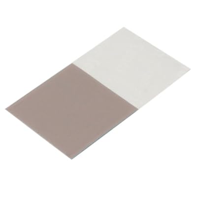

You could just like buy a small heatsink and slap it on with a thermal pad, and I don't know how well the cheap adapter would work out, best to do things directly if at all possible
something like this I think

Some kind of M.2 to PCIe x4 adapter is required because the M.2 socket on that motherboard only has PCIe x2.

For reference, here are my known options for M.2. PCIe adapter with heatsink:
https://www.ramcity.com.au/buy/bplus-m.2-pcie-ssd-to-pcie-2.0-x4-adapter/M2P4A
https://www.ramcity.com.au/buy/angelbird-px1-pcie-x4-adapter-for-pcie-m.2-s/WIPX1-FWKF
These guys recommend a heatsink with the PRO 950, as it thermal throttles during sustained file copying:
Going to want the x4 adapter naturally, and ya heatsink's good, but I guess it depends on weather you want general read/write speed or random speed vs the 750 SSDs.
