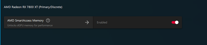

Update: Fixed.
It was a HugePages issue. I have no idea why but when I configured HugePages on the host. Everything went smooth and the crashing stopped. So far.
This is usually caused by enabling ReBar but the guest is not aware of it and as such the GPU is in a badly configured state by the guest drivers.
See: The state of AMD RX 7000 Series VFIO Passthrough (April 2024)
It’s showing that it’s enabled, the error seems to go away by enabling HugePages. I’ve been playing consistently without any crashes.
Thanks for the update, this is another useful data point
