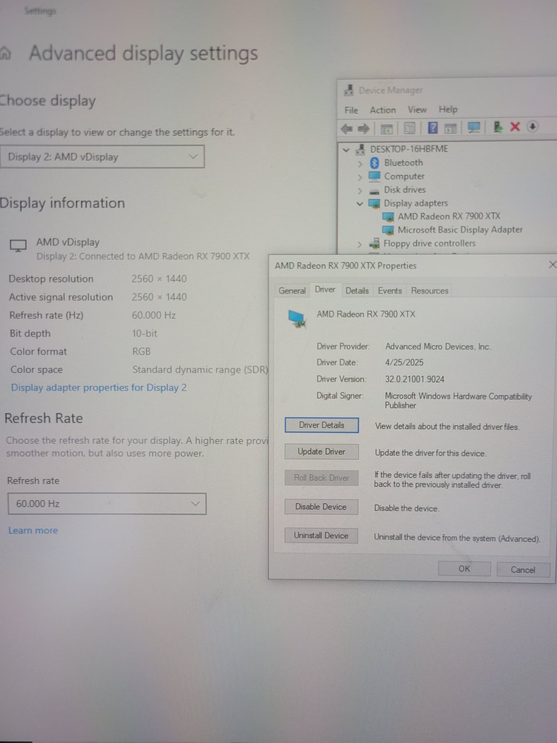

Glad to hear it has been fixed for some time time. Please tell my computer that:

FWIW I was able to reproduce the vendor_id override not working with my 7900 xtx by enabling hyper-v in the windows vm. When hyper-v is disabled all works as expected.
