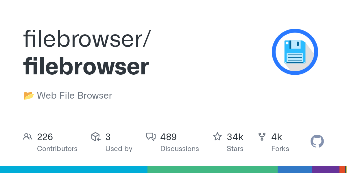

I am also running OMV, and ran into a similar problem, as SMB has terrible performance outside of a LAN due to latency.
I setup a program called filebrowser, and it seems like it could do what you want.
