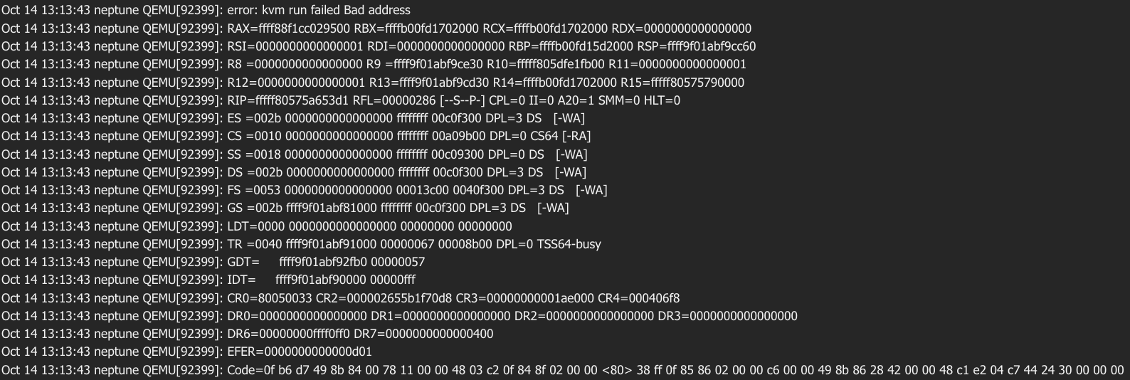

So i am currently having issue with. Everything works like it should until the start of the VM. Then vf’s are being just removed on VM start.
VM Log:
Use of uninitialized value $name in concatenation (.) or string at /usr/share/perl5/PVE/SysFSTools.pm line 324.
failed to reset PCI device '0000:03:00.1', but trying to continue as not all devices need a reset
kvm: -device vfio-pci,host=0000:03:00.1,id=hostpci1,bus=ich9-pcie-port-2,addr=0x0: vfio /sys/bus/pci/devices/0000:03:00.1: no such host device: No such file or directory
PCI device mapping invalid (hardware probably changed): pci device '0000:03:00.1' not found
TASK ERROR: start failed: QEMU exited with code 1

I have been trying to figure it out since yesterday but i had no luck. I am running latest proxmox with opt in kernel 6.17.
Are you trying to pass “All Functions” through to the VM? If you accidentally specify that in the PCIE device settings for the guest, it will do exactly this.
