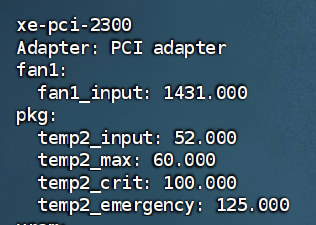

In addition, I noticed that newer firmware introduces a 60°C temperature limit.
When the temperature reaches 60°C, the GPU immediately throttles down.
After running sensors -u, an additional entry appears:pkg: temp2_max: 60.000
This is not caused by the “hybrid firmware”. Flashing the latest firmware still results in the same 60°C temperature limit. Downgrading back to firmware version 6979 removes this limitation.
I have seen someone mention a similar issue on the Intel forum, but I’m not sure whether anyone here has encountered it.
