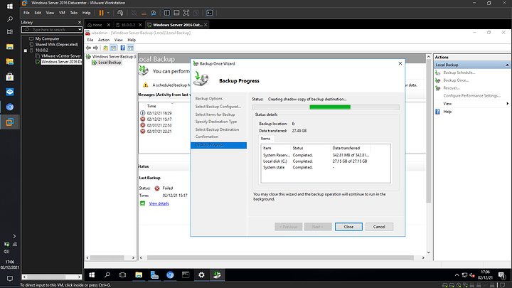

Backup Complete!

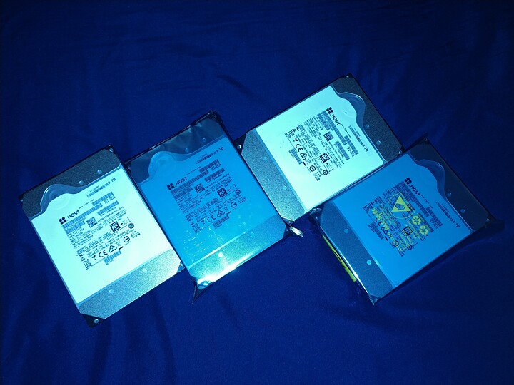

Just bought four of these:
HITACHI Ultrastar HUH728080AL4205 (HGST)
32TB upgrade, here I come…
I’ve bought many of those HGST drives…seems like a lot of companies are liquidating 8TB SAS drives as of late. As long as power consumption isn’t a factor, it is really hard to beat the price per TB.

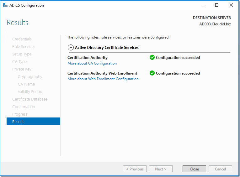

MariaDB works well with hMailServer so far, and now I’m trying to add a CA to the project, for future security considerations:
Once the CA is ready, it’ll be time to get crackin’ on the Artix Linux VM.
vCenter certificate replacement, with an MS AD CA:
