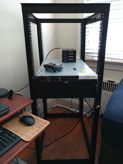

Just attached the rail kit to the server, in preparation for the rack that’s coming in the mail this week. Can’t wait to take photos of the finished result…
