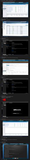

The test with the 2nd drive cage installed didn’t go too well tow nights ago. When connected, the drives in the 2nd cage did not appear in ESXi. In addition to this, only 3 of the HDDs from the original/first cage showed up. One of the 3 from that cage showed up intermittently. I think I may have encountered a power issue. While the activity indicators on both cages did light up, they weren’t indicative of the true status of the drives. I also checked the ESXi kernel logs (Alt+F12) during runtime, and saw some interesting errors. I tried rebooting the server, to see if it needed some time to get acquainted with the new hardware. But, two reboots did nothing. Everything appears to be working as expected after removing the 2nd drive cage. If it has been a bad data cable on the 2nd drive cage, I would expect the issue to not affect the drives from the 1st cage. But perhaps I’ve overlooked something. Now I’m stuck at trying to figure out how to power the second drive cage, since internal power appears to be off the table for this. Perhaps an external SATA-only PSU or DC power supply?
On a different note, I also can’t seem to get the WiFi NIC to show up in ESXi - which leaves me with 3 conclusions:
  • the card needs drivers
  • the card needs to be re-seated (for the 7th time)
  • the card is DOA and needs to be replaced
The first one seems most likely, seeing that ESXi may need drivers for anything that wouldn’t be in a normal enterprise environment. The second one seems unlikely because of how many times that I’ve already attempted that solution. The third one is the worst case scenario, and would be one that incurs the most up-front monetary cost to me. If I do have to install drivers for the wireless NIC in ESXi, a backup of the host config needs to be made first. Otherwise, I’ll be in hot water if the installation fails. I’ll be attempting to use a 3rd party Linux driver in ESXi, with no way to know if it’ll work in advance.
On a side note, the second drive cage was the only real way I was ever going to get to play with ZFS in Linux. That would have been a pool of four SAS HDDs that I could have experimented with, using ZFS’s RAIDz options. Since that’s not in the cards at the moment, the extra 16TB of SAS storage is back to sitting without a use.

Unsure if you’re wanting ESXi to use a Wifi card, or if you mean the card isn’t being recognized as inside the system at all.
You can check the hardware list by heading to Manage > Hardware > PCI Devices. If its there but not in ESXi’s network devices, you’ll need a 3rd party VIB to get it to show up in ESXi (similar to how you’d get Aquantia NICs to show up in ESXi). If it doesn’t show up in the PCI Devices list, there may be some hardware grouping settings you need to adjust in BIOS or the card itself is bunk
I’ll need to re-check the server in a few hours. But iirc, it didn’t show up in PCI Devices listing at all. BTW, thanks for the suggestion. I’ll see if I can test that in a bit :slight_smile:
