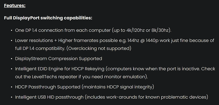

  1. The worst is that when switching between PCs the OS thinks that the monitors have completely disconnected from it. This happens on both Windows and Linux. The FAQ page ([Official] L1Techs KVM FAQ -- Ultimate Guide & Help!) says:
    If you have a need to have a game open, but want to prevent the game from detecting the monitor has changed when the input has changed, then this KVM will also work for that scenario. We had several game developers using the DP1.4 KVM that has asked specifically for this feature to aid in game development.
    however this doesn’t seem to actually happen on my KVM.

What you’re referring to here is a different KVM than what you’ve bought, unfortunately. This is under the “EDID (Monitor Emulation) KVMs - DisplayPort 1.2” section of the FAQ. The particular KVM this quote is from, and our HDMI 2.1 KVMs, are the only L1Techs KVMs that have monitor emulation. If this is what you’re wanting, you can achieve monitor emulation in software (linked/explained in the FAQ), or, via hardware like this:
While that’s true it also clearly references DP1.4 KVMs. I hope you can see how it can by confusing, I just interpreted it as the DP1.4 KVMs that are on the store having this feature.

Hm, if you’re referencing that paragraph specifically, the DP 1.4 KVM incompatibility is mentioned as a reason we created the DP 1.2 monitor emulation version. People who had DP 1.4 KVMs requested a KVM with monitor emulation.
There’s a few places it’s pretty verbose
From the product listing you linked:
anyway,
That’s possible they could be powered via the KVM. The best fix for monitor emulation is in software, though. I’d have to ask Wendell about Linux, but in Windows 11 there’s a toggle in the display settings and in windows 10 there’s the “persistant windows” repository on github.

It’s clear that I misinterpreted the FAQ page, it is what it is. Maybe it’s worth trying to trim down some of the “fluff” in there, there are enough details to keep track of without all of the “embellishments”.
