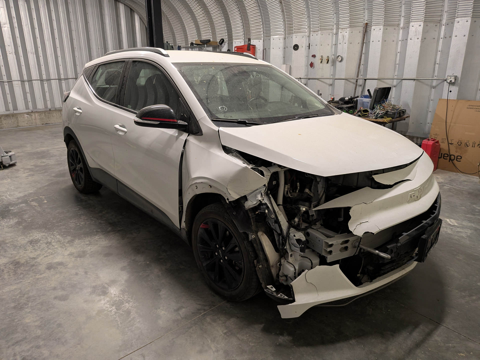

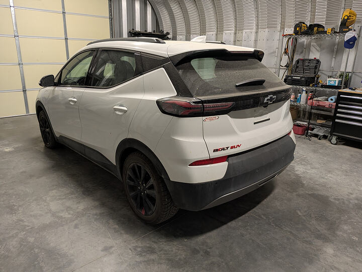

Well, due to my concerns about getting diesel for my Bimmer, I’ve picked up a wrecked 2023 Bolt EUV for $6K.

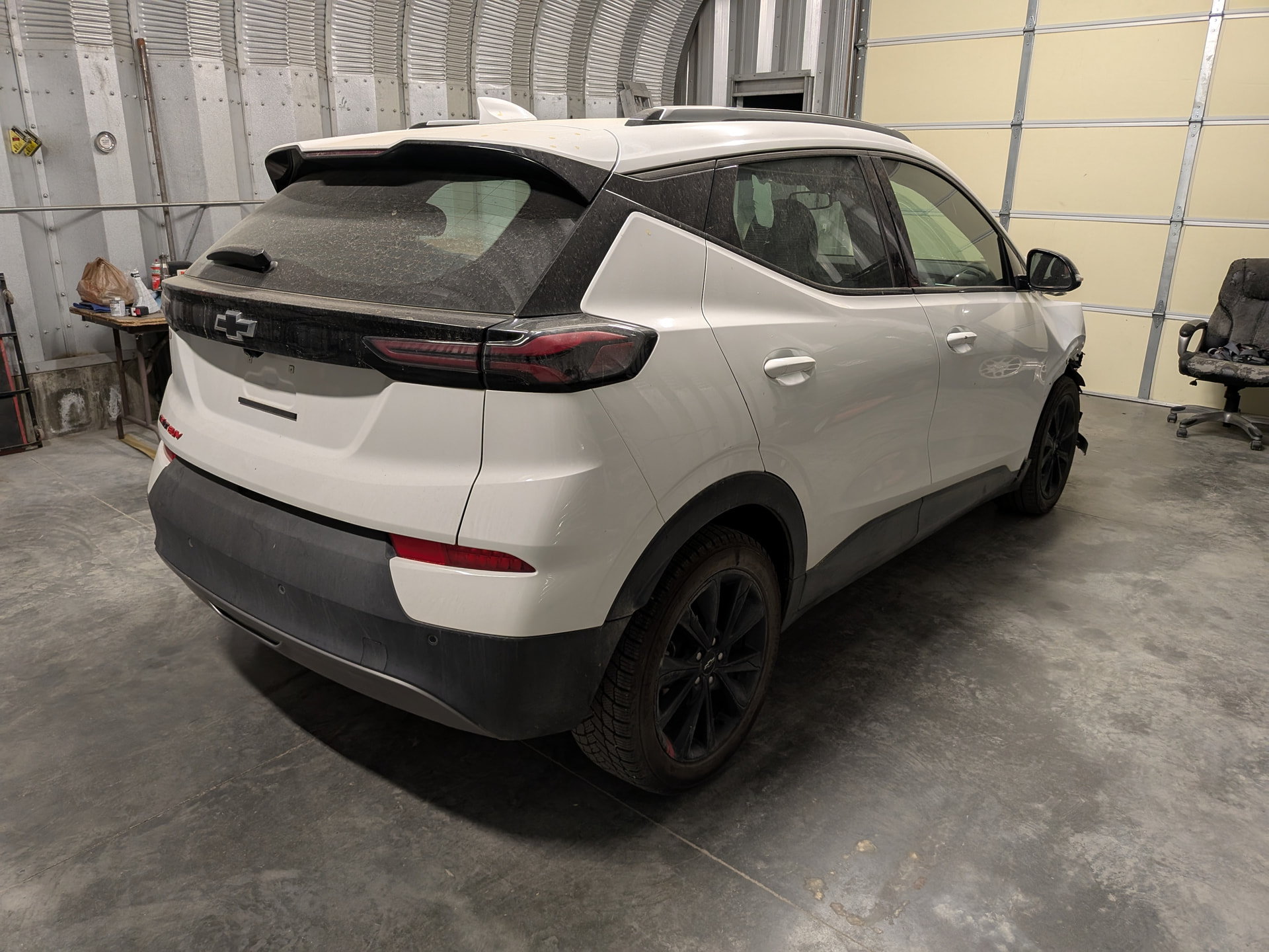

Pictures before work starts
Exterior:

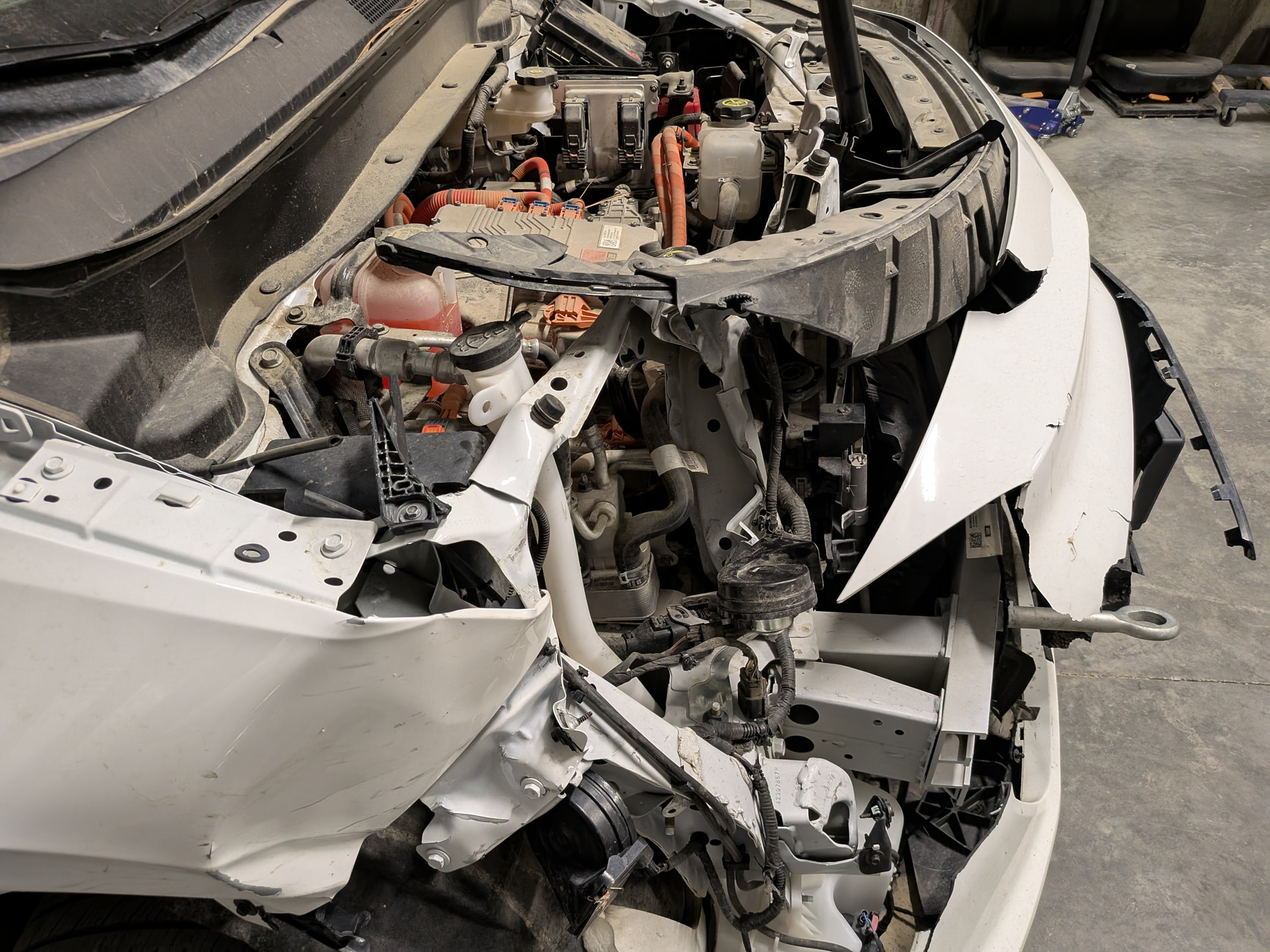

Damage:

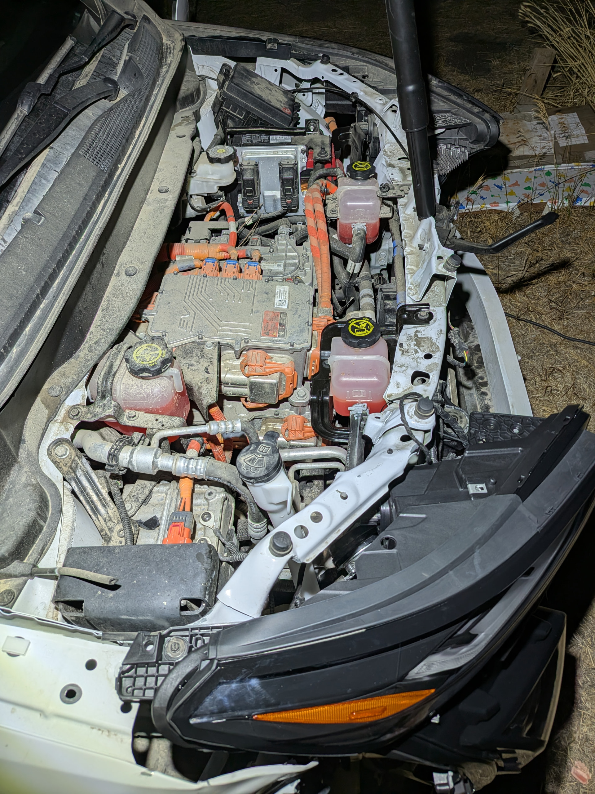

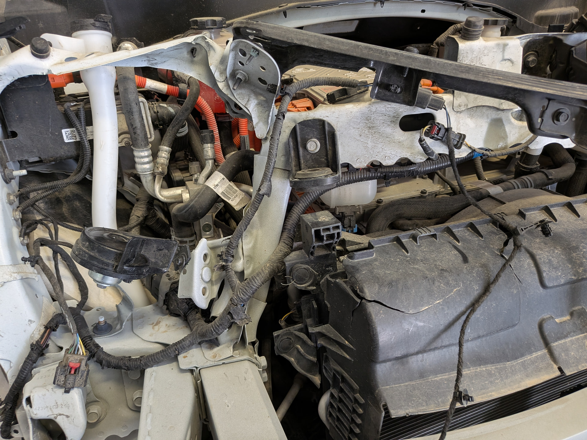

No frame damage, but the radiator core support did get damaged

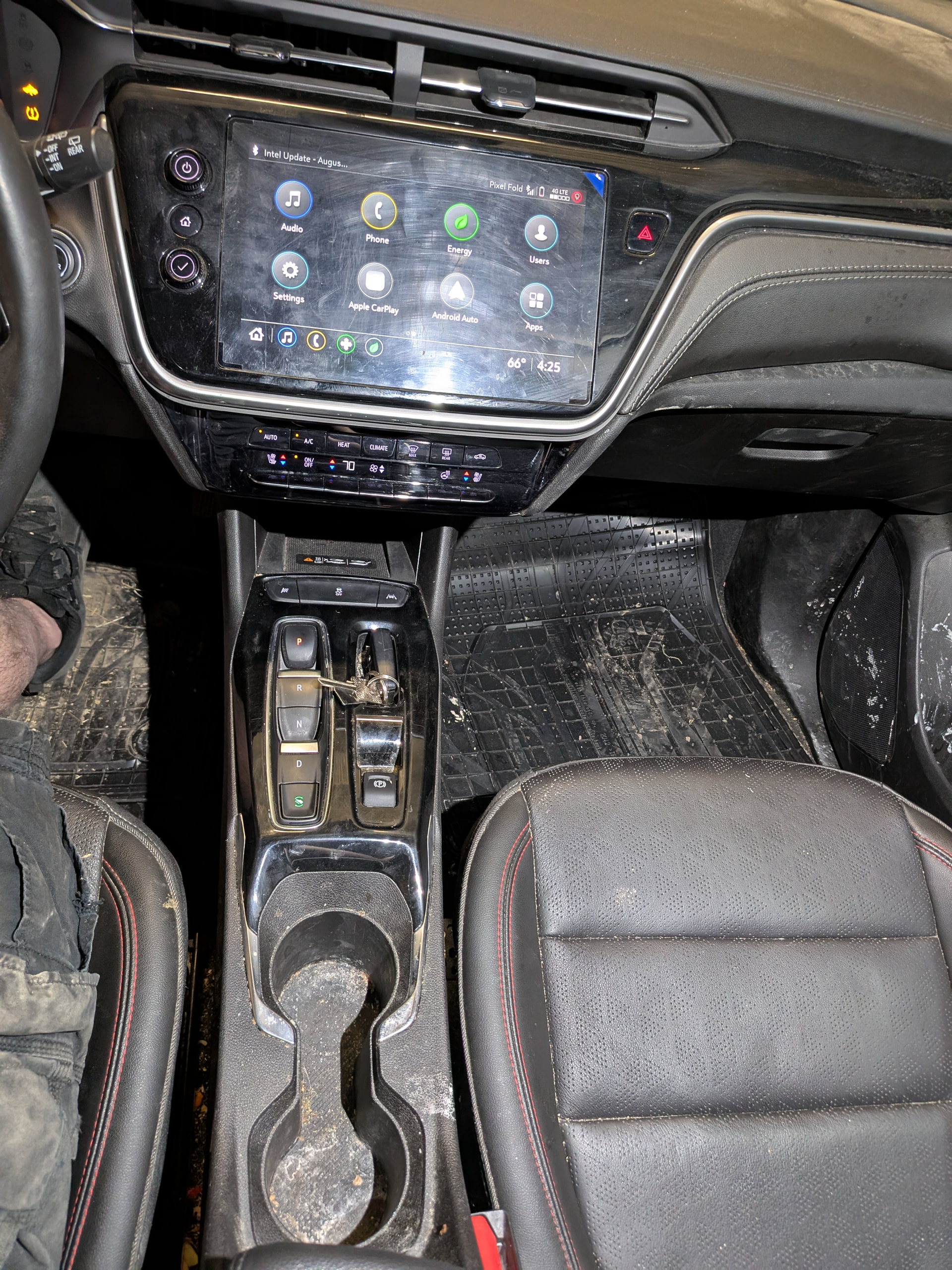

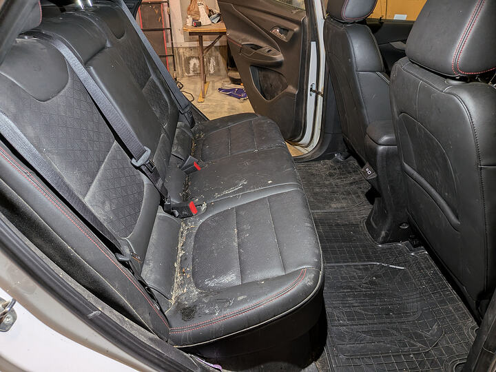

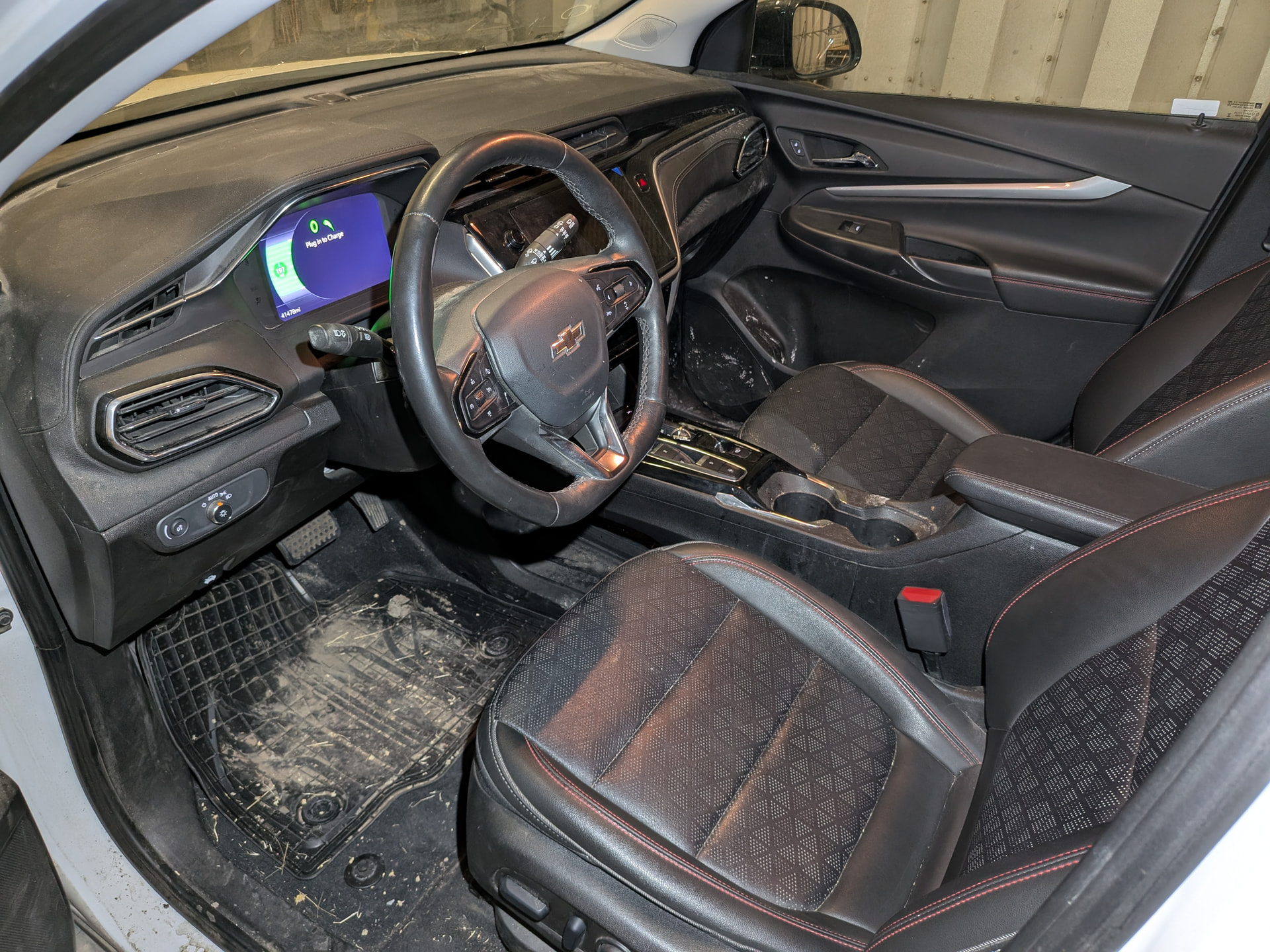

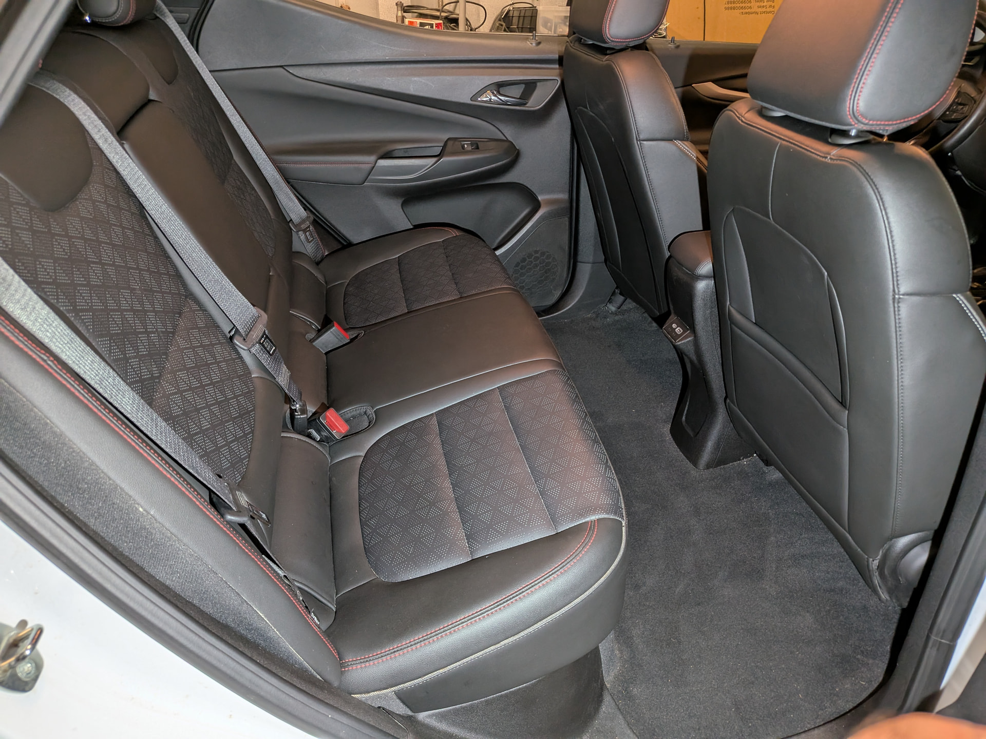

Interior:
Never had a car come with a window sticker

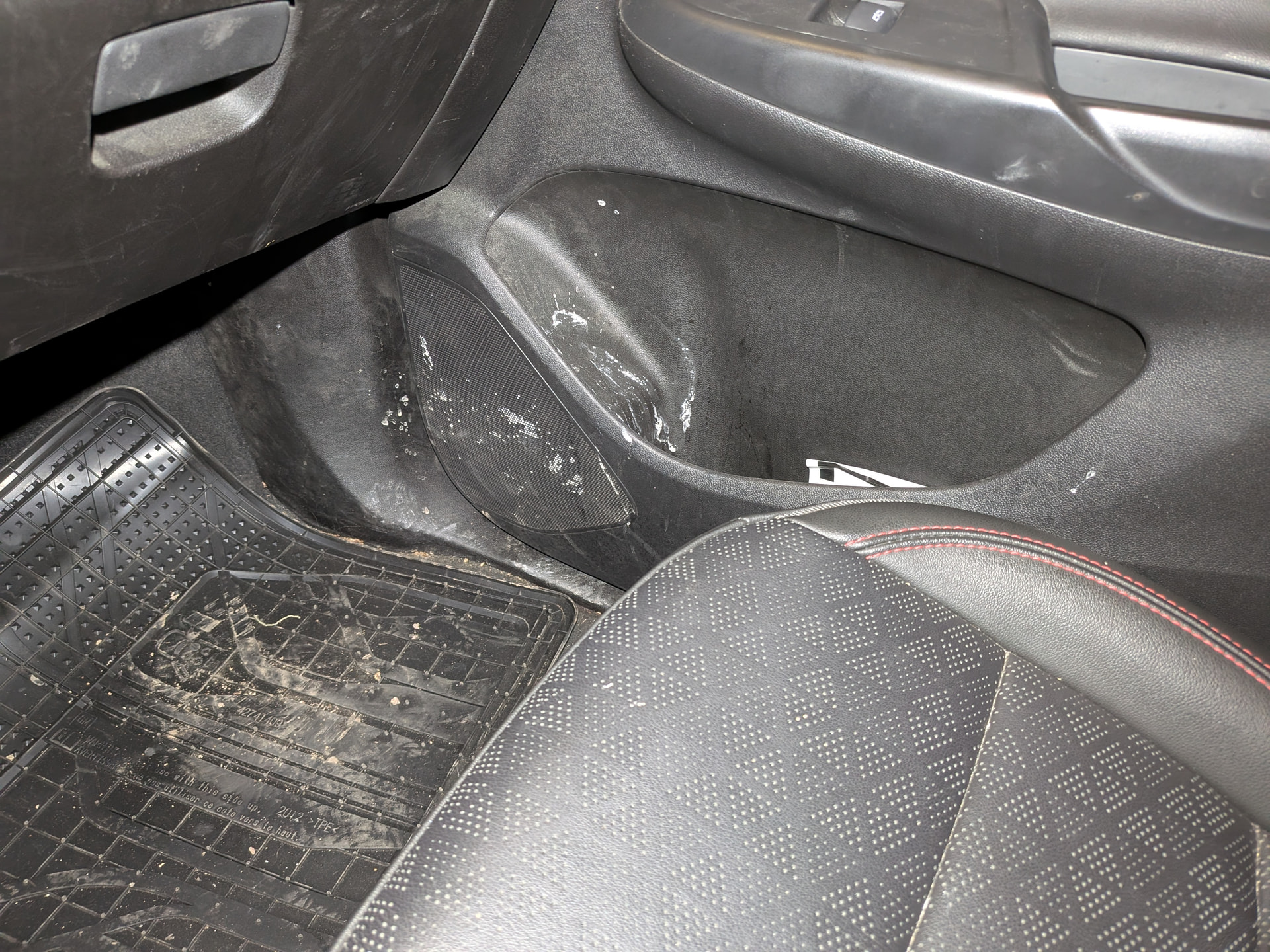

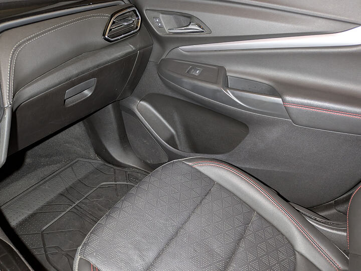

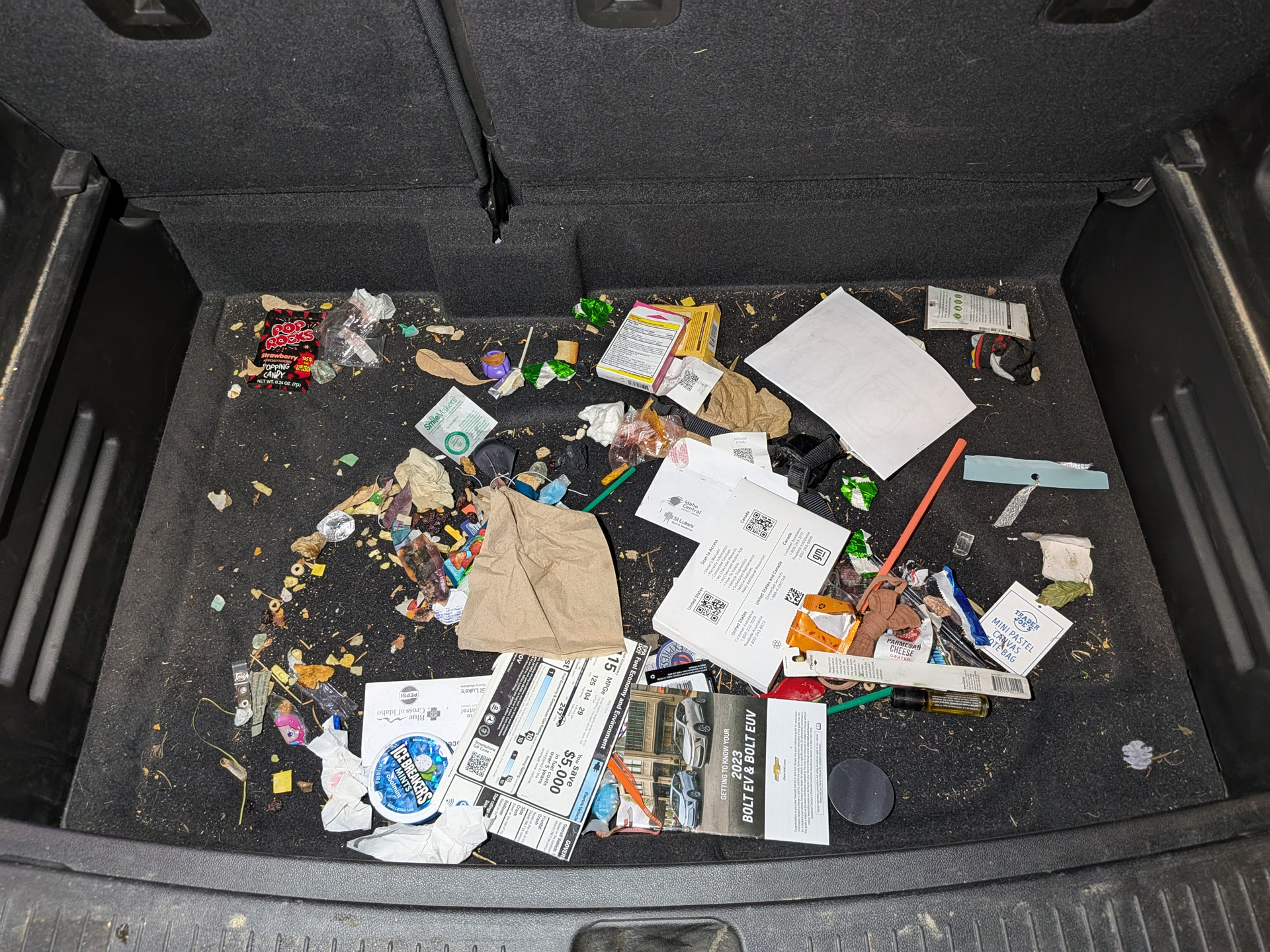

Cleaning… lots & lots of cleaning

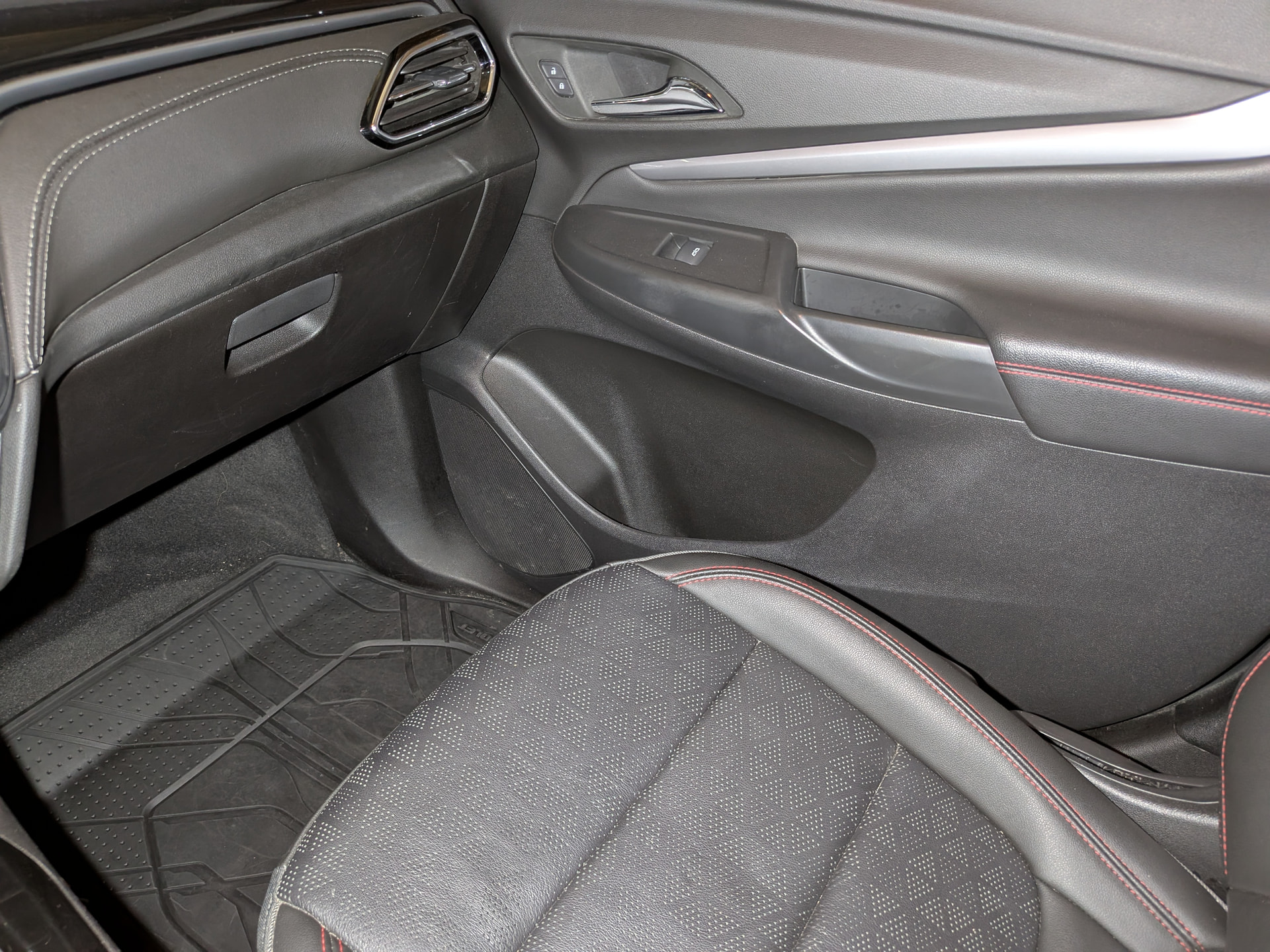

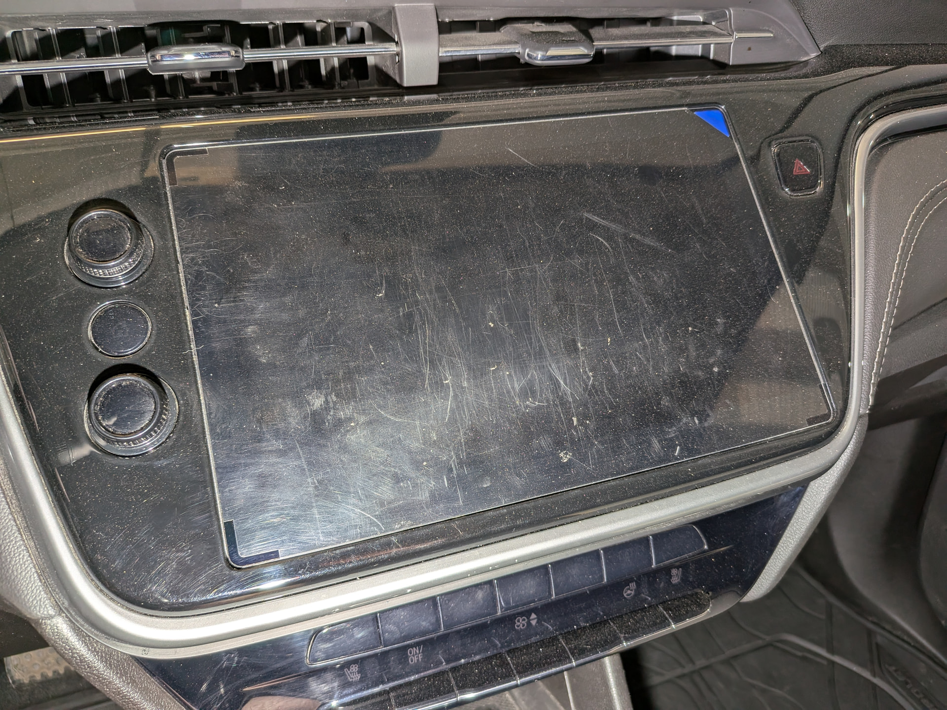

Still had factory applied screen protector, so I ordered a glass screen protector and swapped it out

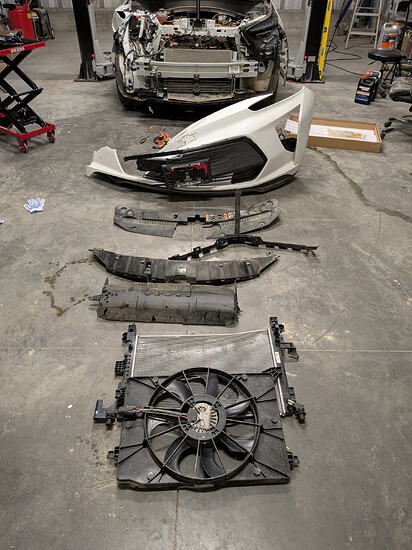

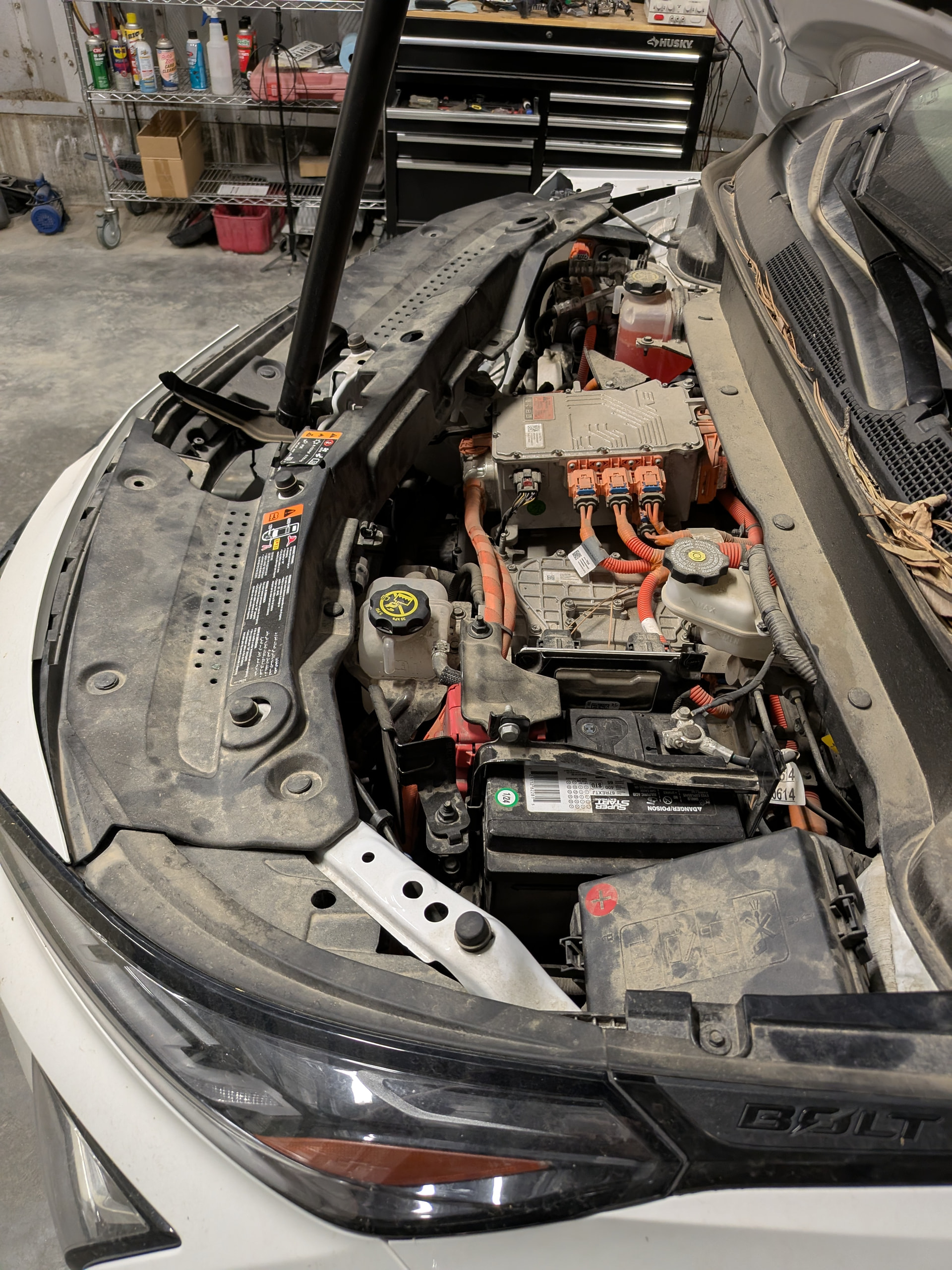

Repairs start

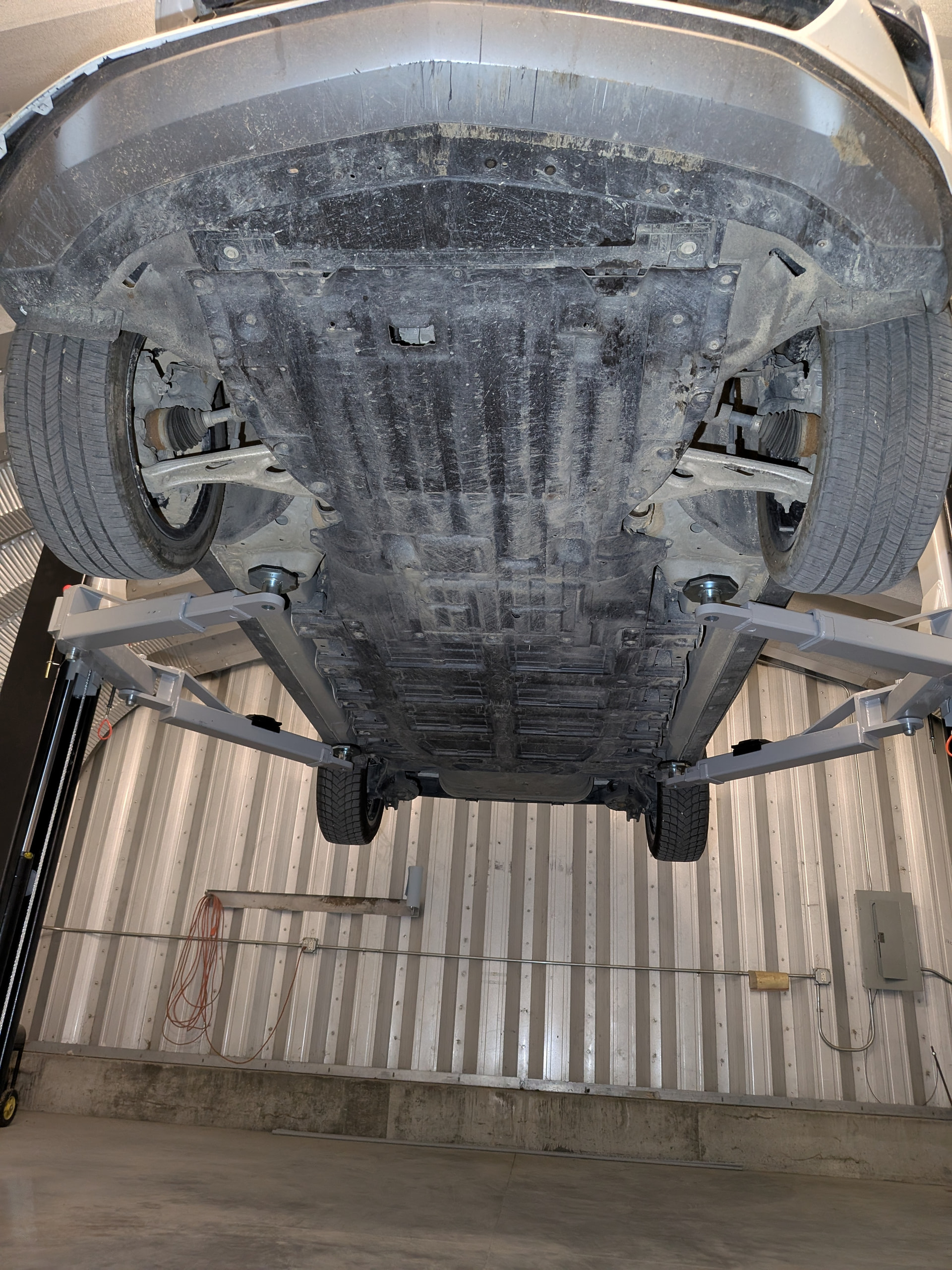

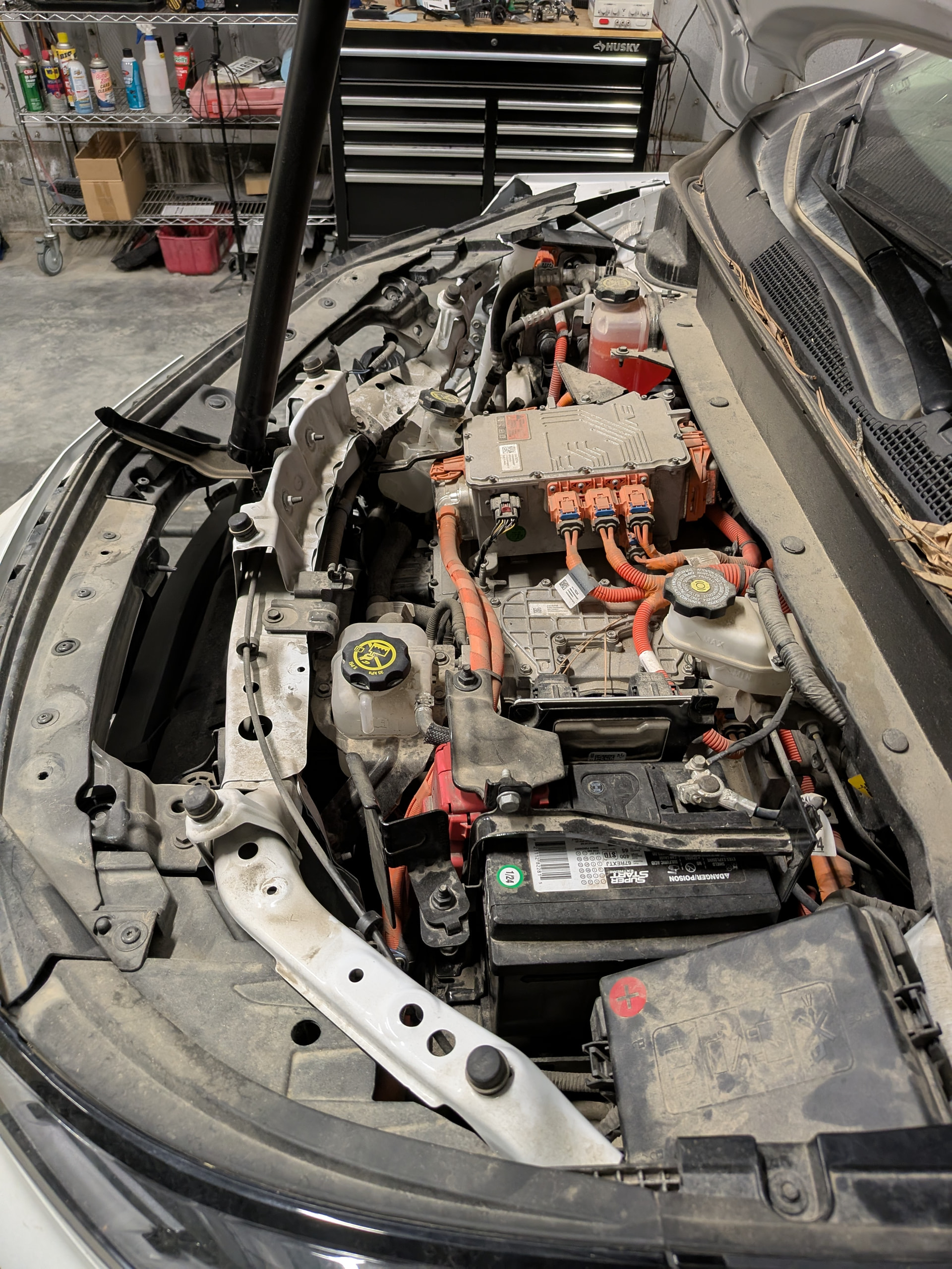

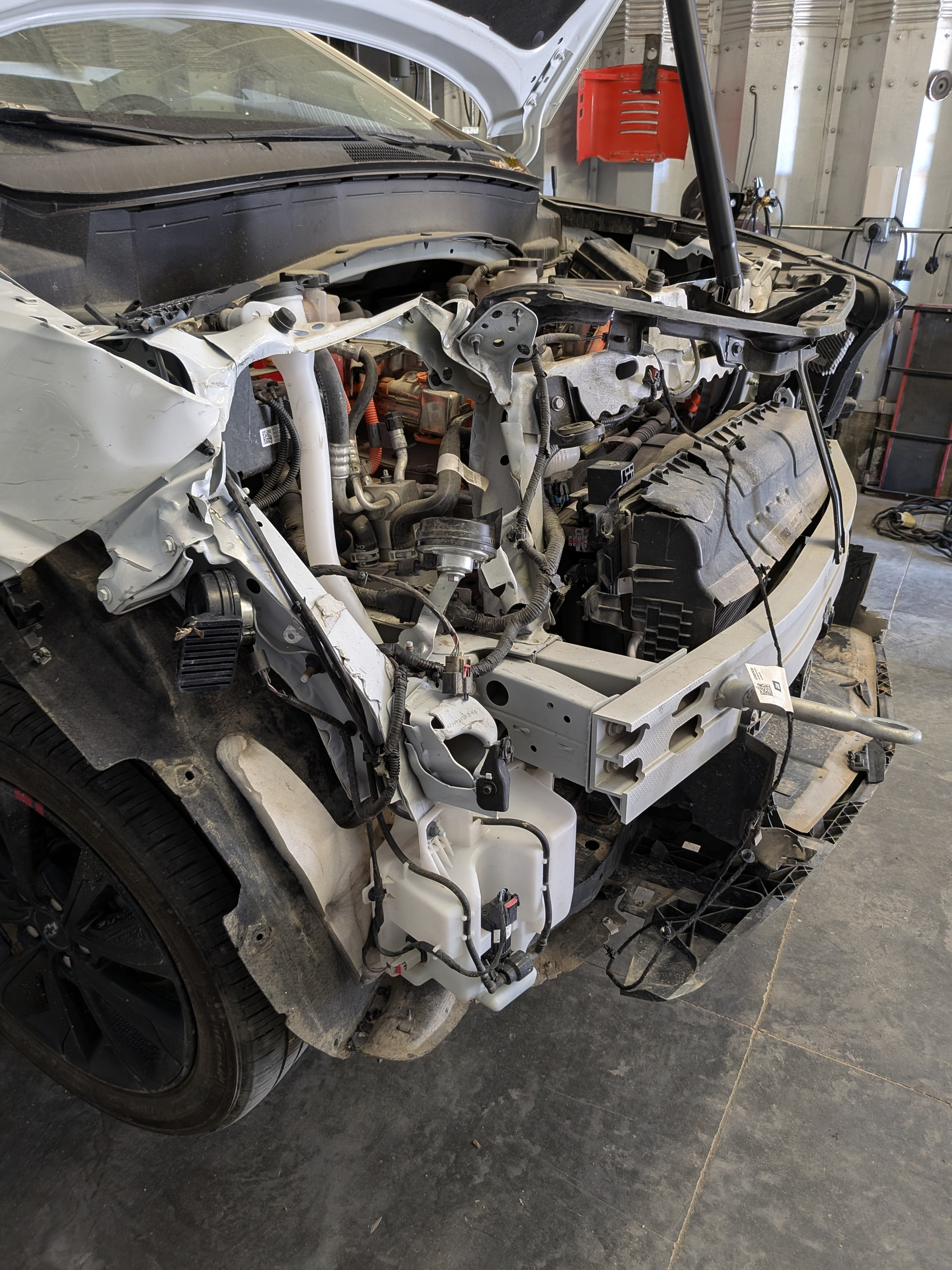

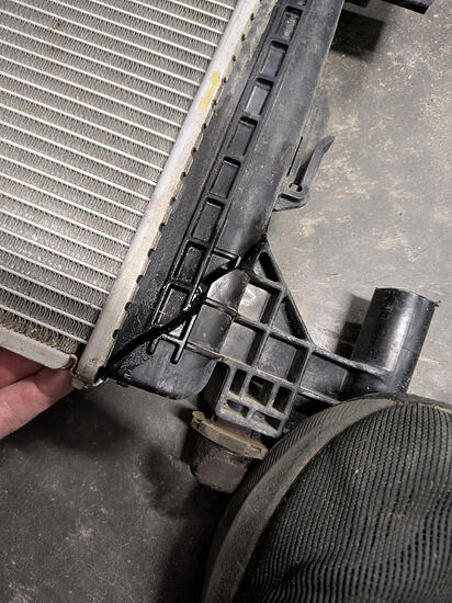

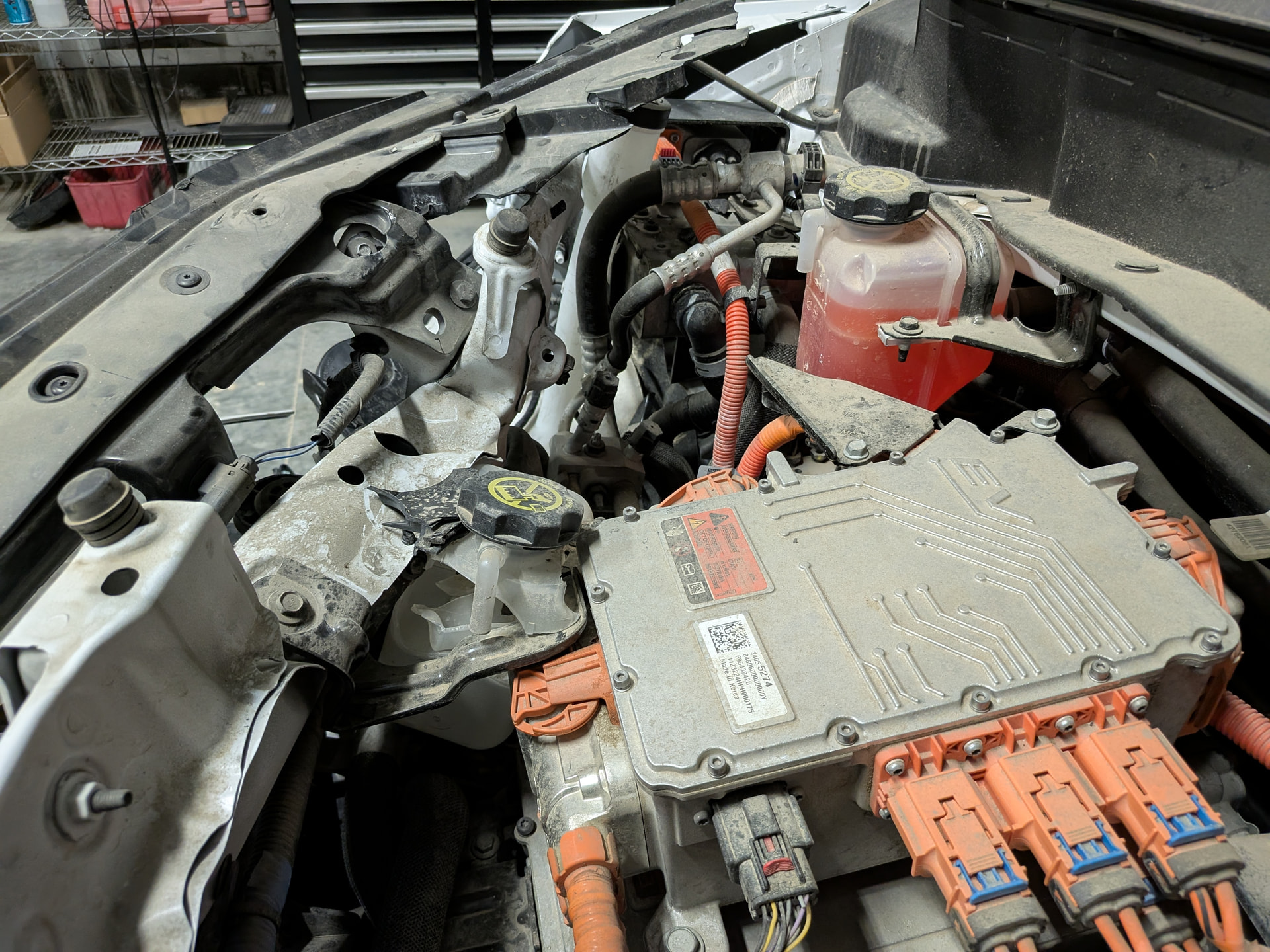

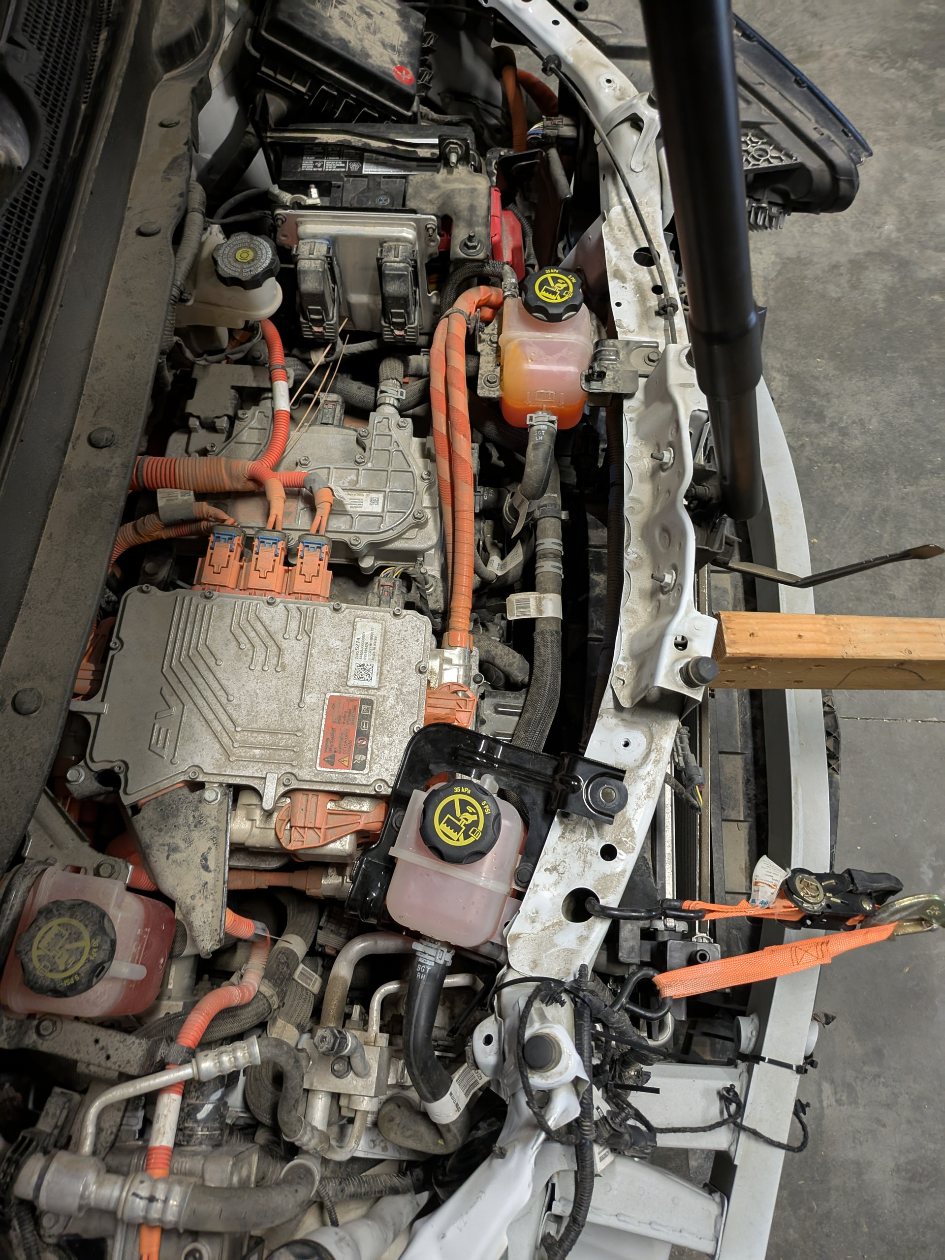

Assessing damage

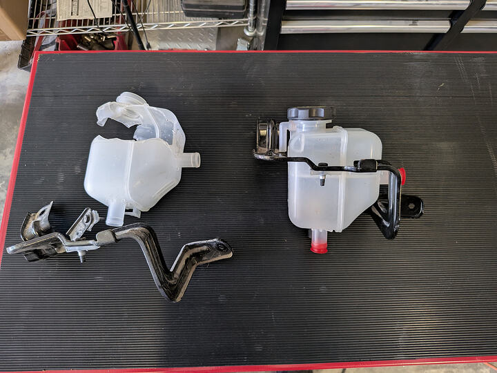

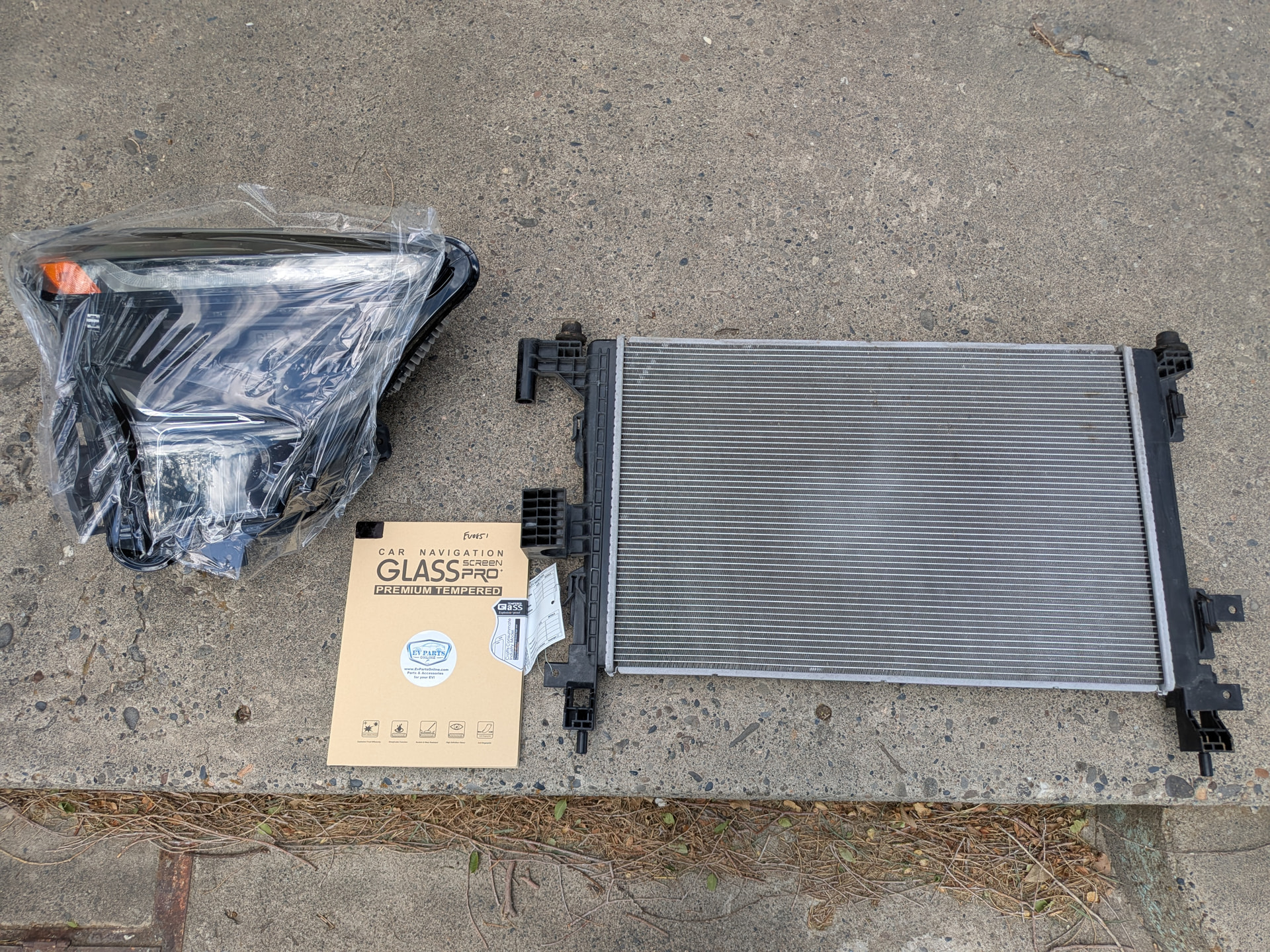

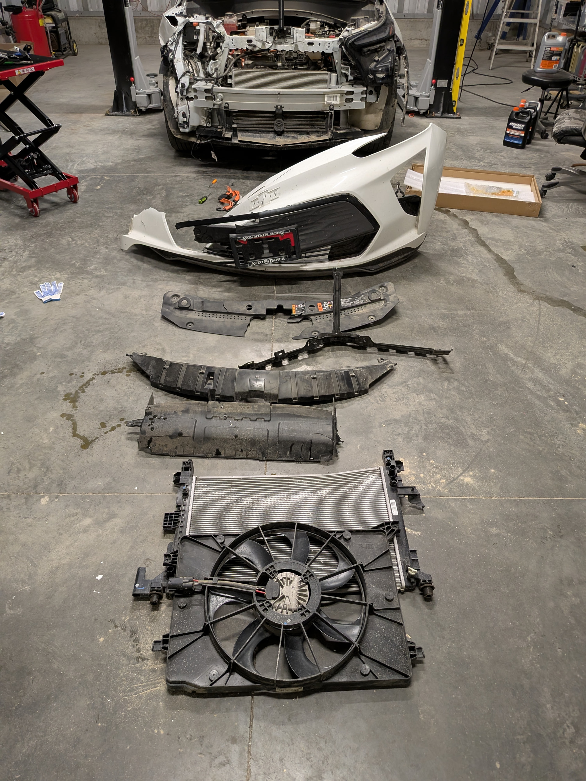

Essentials ordered (aside from the screen protector:P)

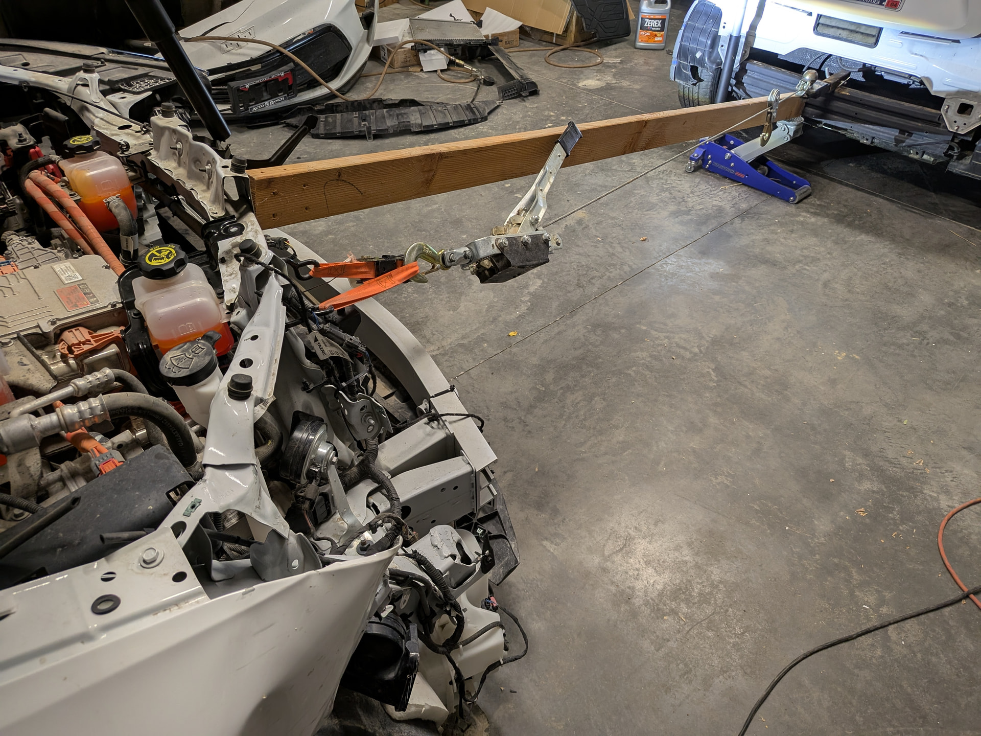

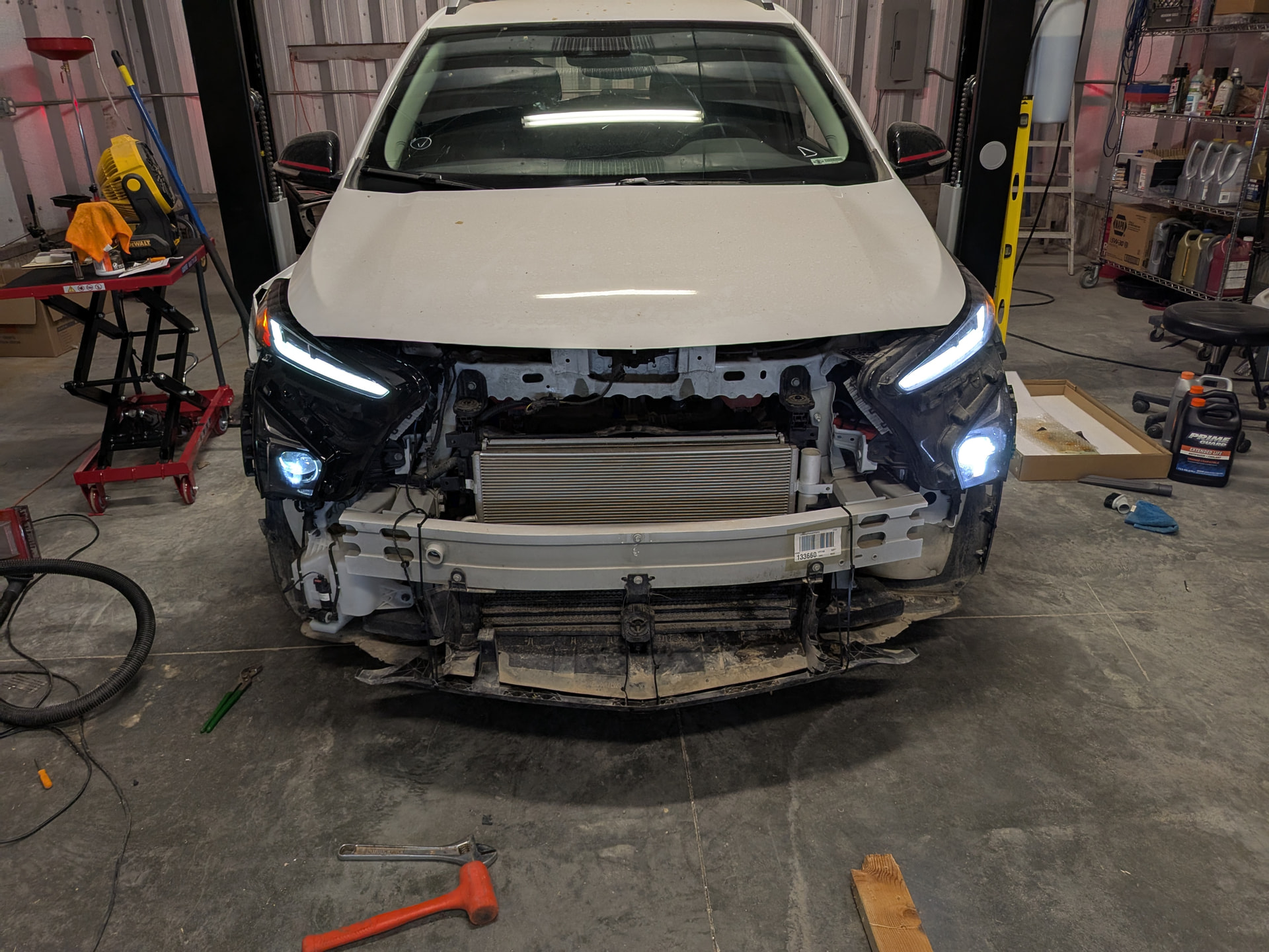

Put the car on my frame straightener & used the headlight to bend stuff back into place:P
Got the mounting points lined up dang near perfect for the headlight, but I can tell it will need more tweaking after I get a fender & bumper.

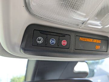

Killing OnStar:

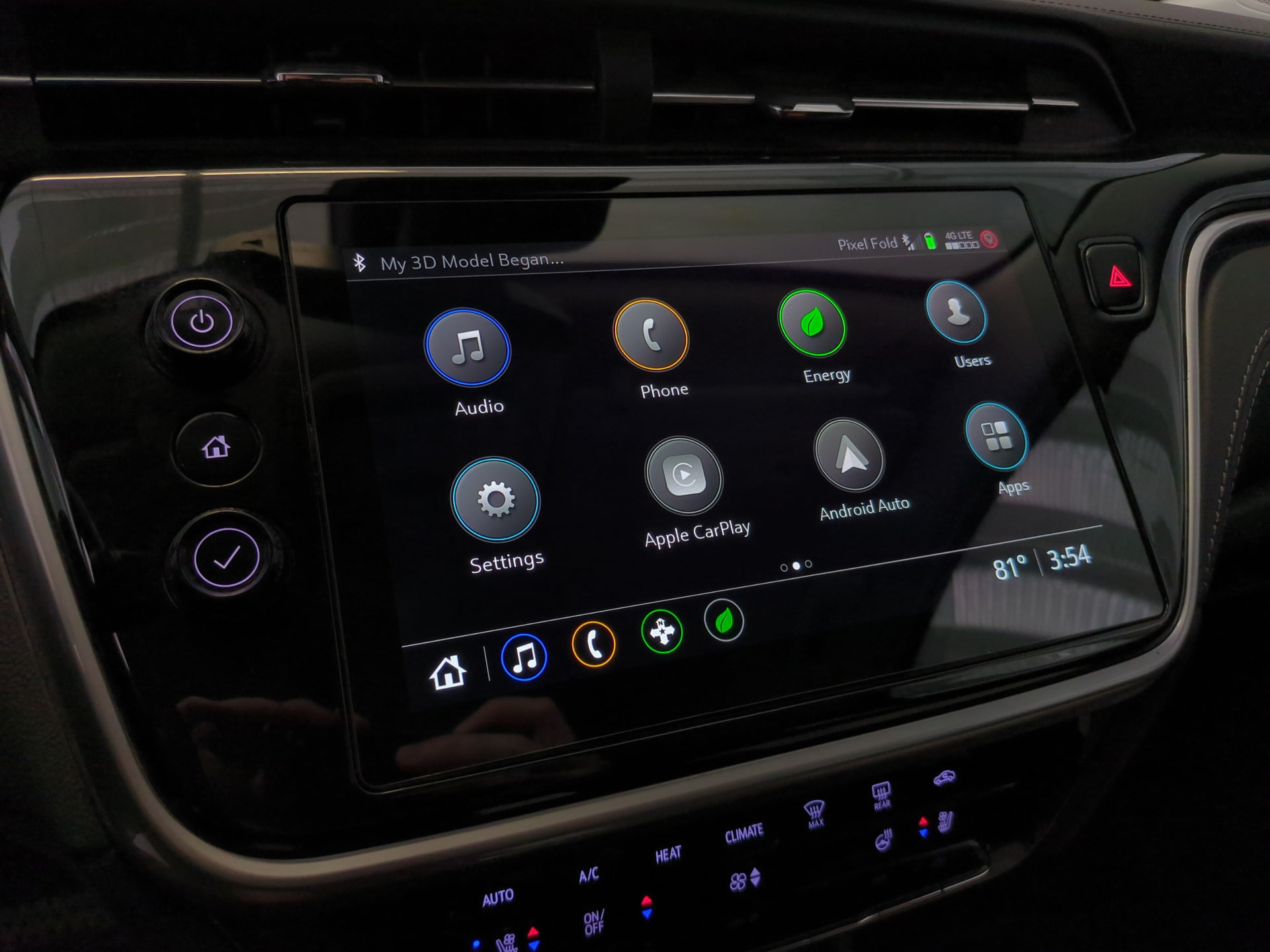

Pulled the onstar fuse because fuk that noise, and shockingly the car doesn’t complain about it at all, the only way I can tell is the missing LTE bars on the screen & no light above the onstar button.
No LTE bar

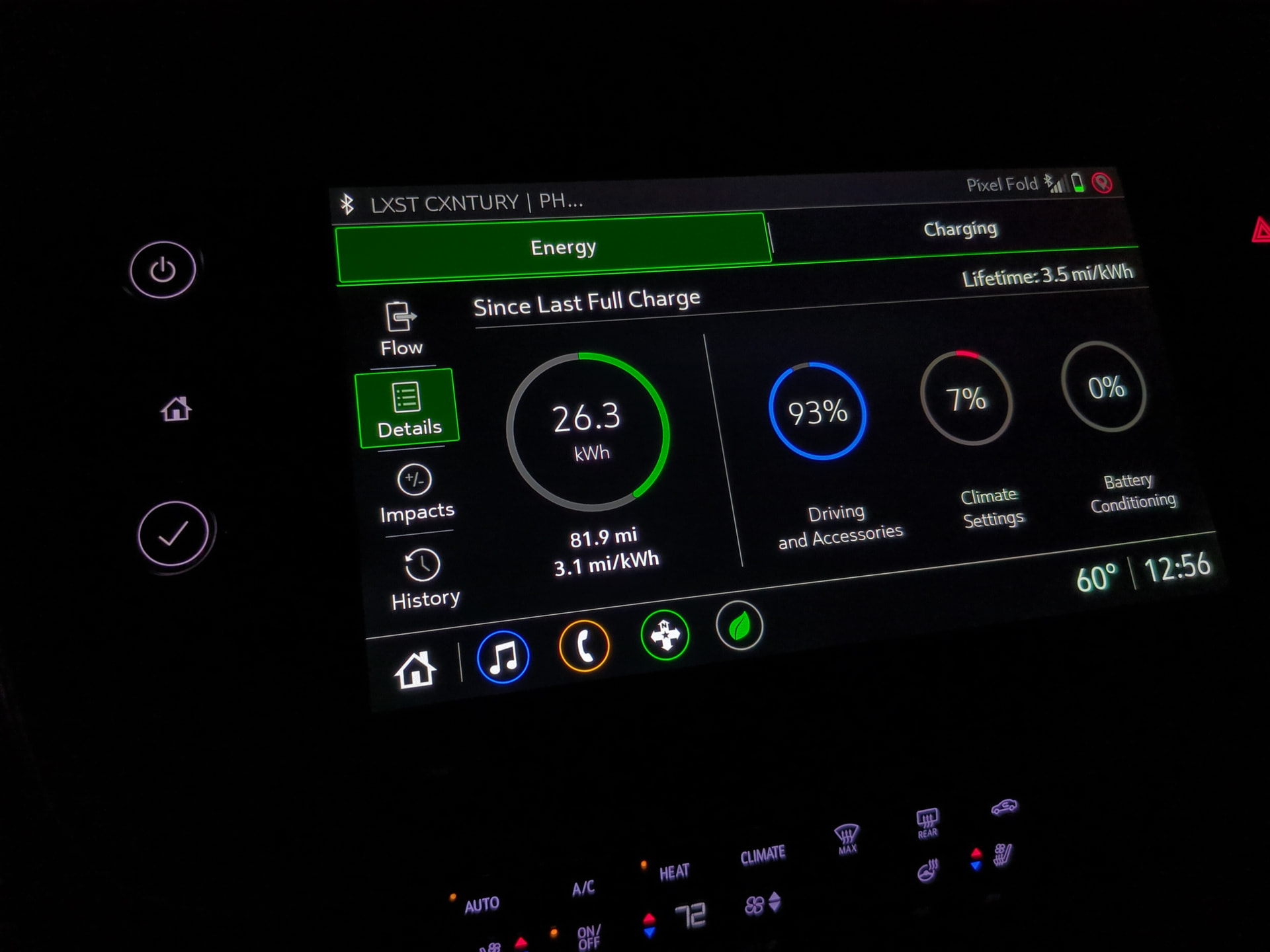

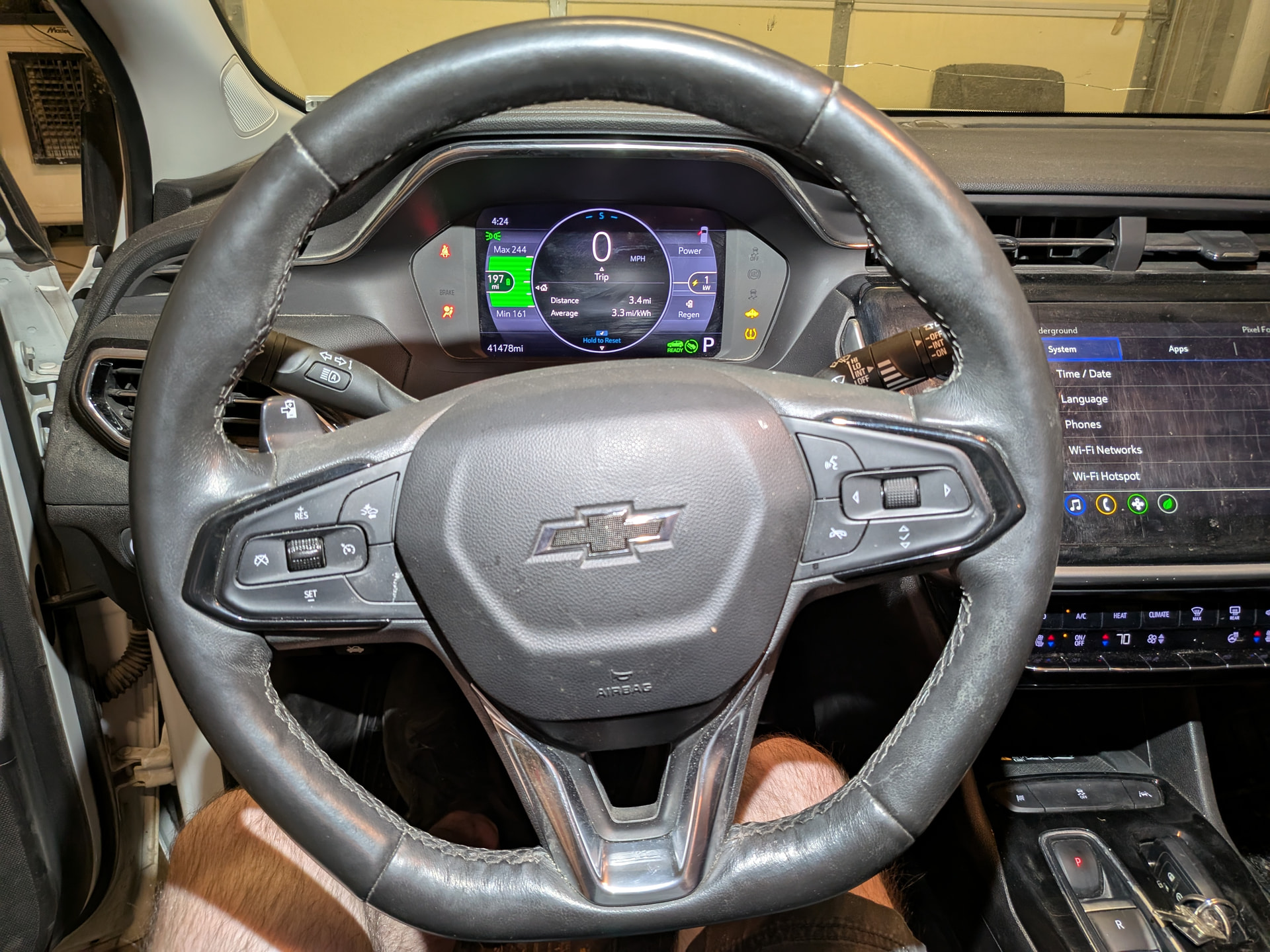

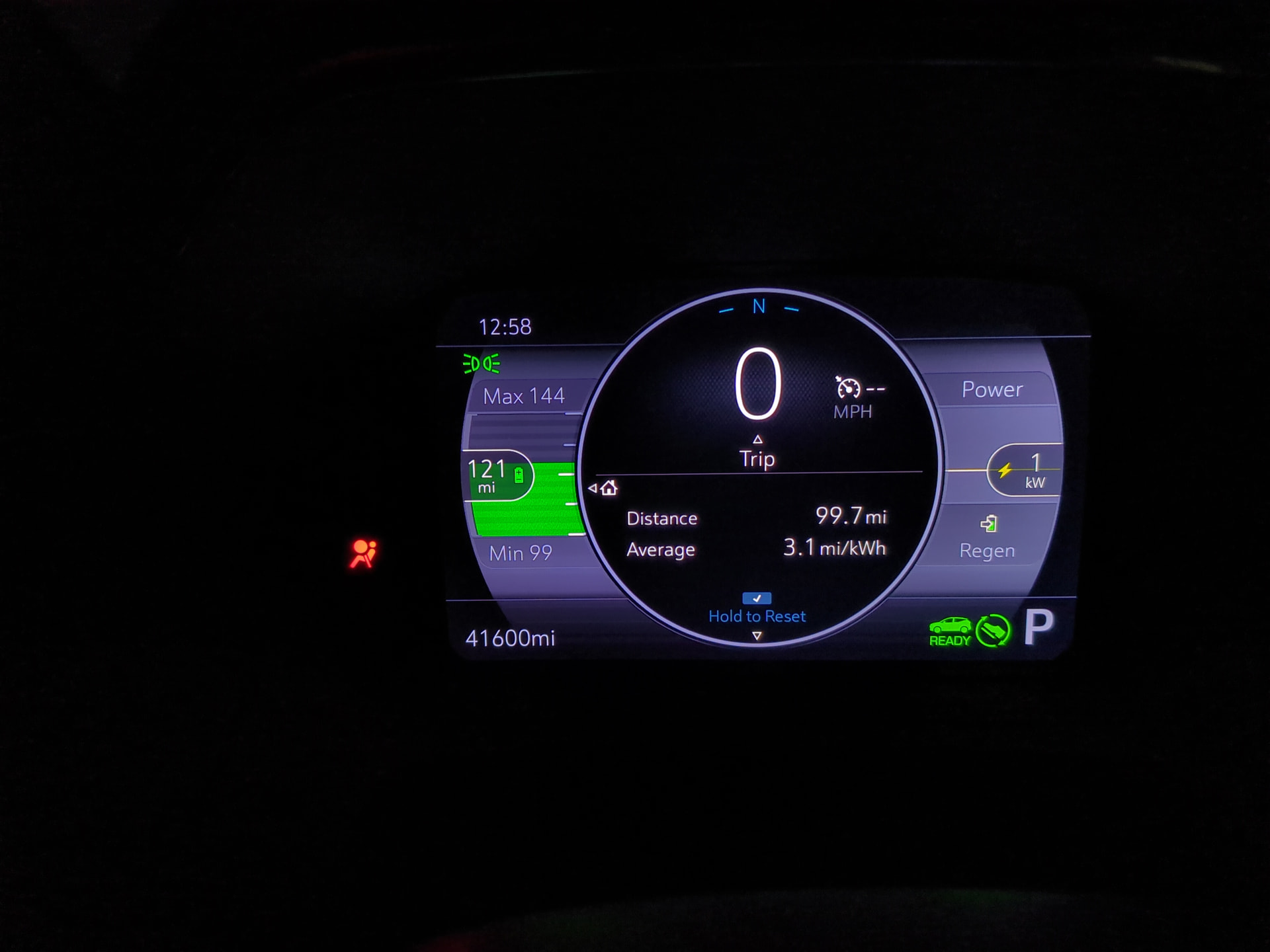

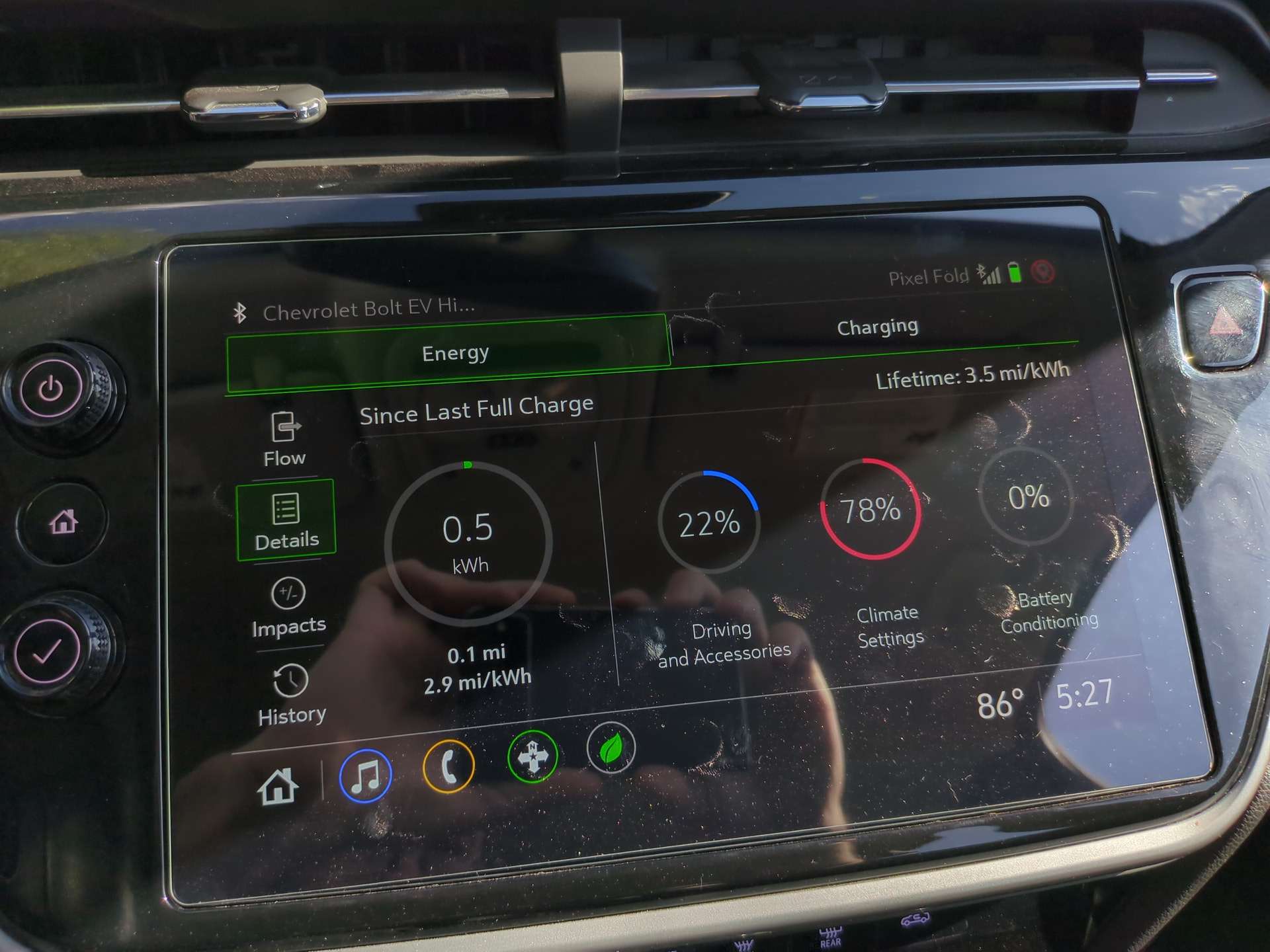

First real test drive:
I took it all the way to town & ran a bunch of errands. Put 82 miles on it that day and didn’t even use half the battery, this range is crazy compared to my prier EVs.
This was the gauges when I got back home “since last full charge” as the correct info for that trip, but gauge cluster has good range est & can kinda see the %.

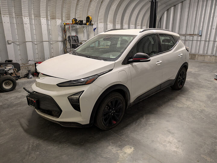

I’ve been driving it like this for a couple weeks now. Unfortunately due to the car being newer I’m struggling to find a white bumper for it, I did find 2 option for the fender, but they’re both asking too much IMO and at this point I can take my time.

$57.23 Coolant reservoir
$205.64 Radiator
$376.15 Passenger headlight assembly
$26.49 Screen protector

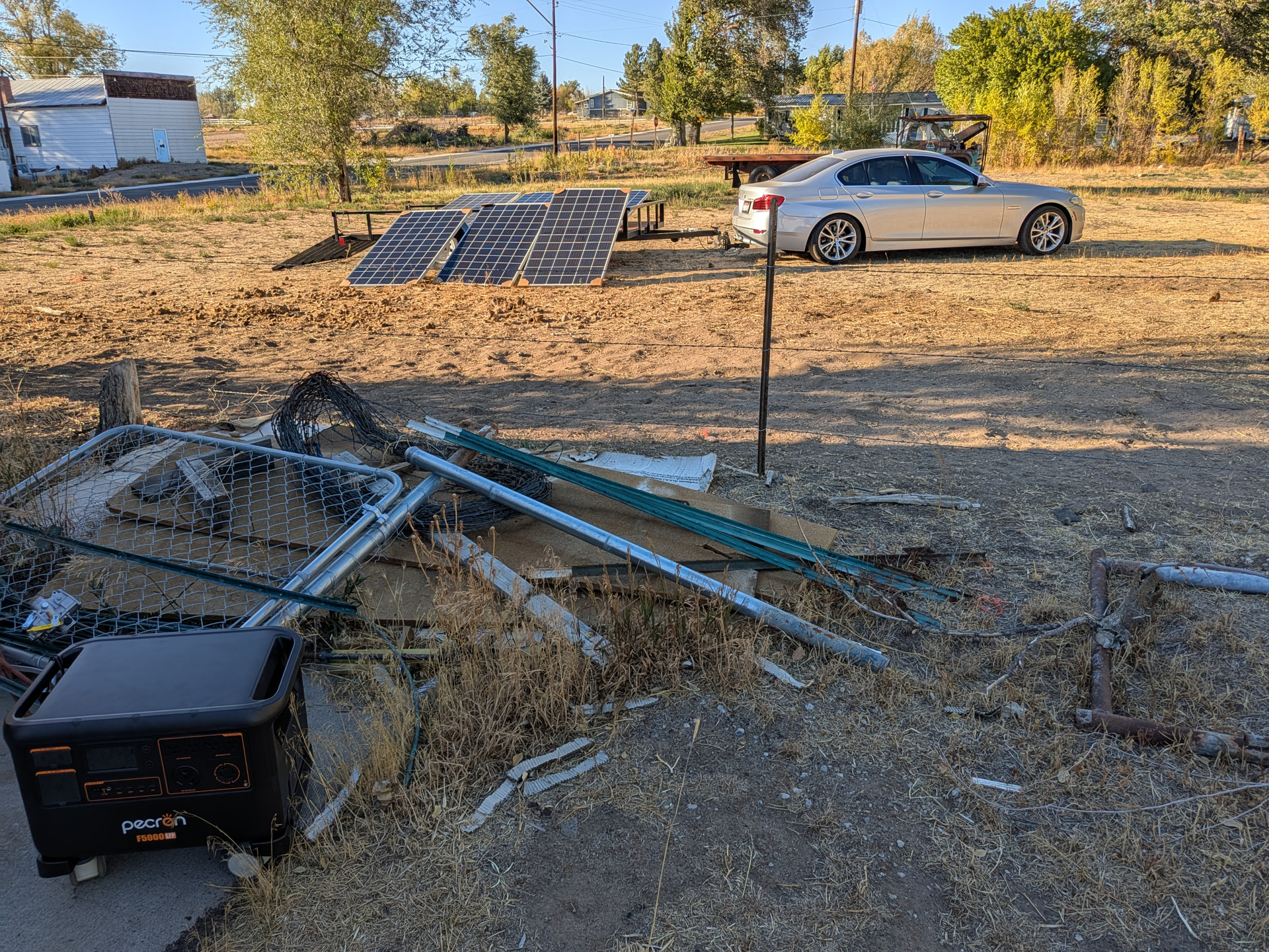

I’m currently playing with charging it via solar. I have a power station capable of 7kw of solar input & I have the solar to do it, but for now I’ll start with 2kw of solar & see how that goes.
I ran out of sun by the time I got it wired up so I’ll have to start this experiment later o7

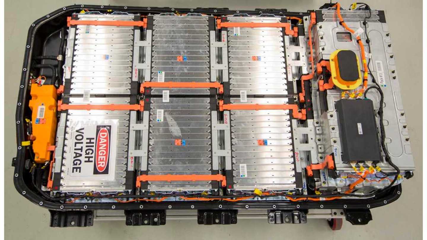

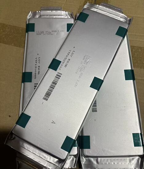

On another kinda fun note, inside these batteries packs are littreally just giant phone cells or 18650 cells (3.7ish nominal voltage), and those don’t have much for brains so even if the pack is locked to the car you could just replace the cells.
With all this said, I certainly CAN NOT recommend anyone crack one of these batteries packs open. Most are 400v & that’s spells death if you make a mistake.
There are SOP for working with these batteries safely though.
Bolt battery packs have a bunch of these in them
Each one of those long skinny metal rectangles have (iirc) 3 of these cells in them.

Im surprised the car hasnt yelled at you for removing the radiator. I owned a volt years ago and that car refused to charge because the coolant level sensor went bad and had to be reprogrammed by the dealership(simply swapping a $15 sensor did not clear the code)

And like I mentioned the car doesn’t even cry about the OnStar fuse being pulled. Very surprised by that one.

30% off msrp is common practice fwiw. They’ll give that out to anyone working in collision(or a heartbeat). all the trim pieces are extra, which is why these new bumpers usually run $700+. Looking at the damage I can see why they would total it; my old shop would call that hit the money shot because of all the components that would need to be replaced through insurance(my shop would have written up the inverter, high voltage lines, harness, refrigerant lines and plenum; nevermind the parking sensors, recalibrating automatic cruise control, etc). You’d easily be looking at 9k of work and parts if written up for insurance.
Oh that’s extremely interesting. I’m sure this is one reason repairs cost so much these days, none of the high voltage lines, modules, or A/C lines have damage.
There was some damage on the sheathing for a low voltage harness but not to the wires themselves.
Also had a broken locking clip for a low voltage plug.
The bumpers are $1,800 on ebay with trim, I would consider this if they were in really good condition & white, but I would certainly reach out to a dealer first.
Hopefully I can use your inside scoop to insure I don’t get shafted. Thx.
I’m just going to go out on a limb here, but I think the bumper does infact need replaced:P
3d print a bunch of bumper sections and glue them together :grin:
Genuinely considering this for the grill insert & some trim pieces. Lol
This will depend on the estimates I get from the dealer.
I’m ready to print with TPU & ASA. Might be a good excuse to play with GF or CF reinforced TPU which I recently learned about.

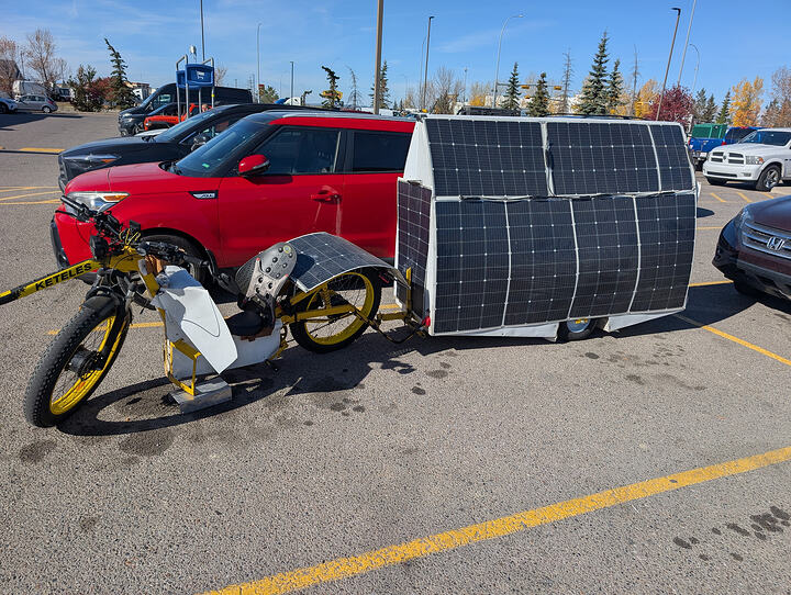

I ran across this EV in the parking lot of Princess Auto in Calgary, Alberta. I wish I would have had time to talk to the owner but at least i grabbed a couple pics…
