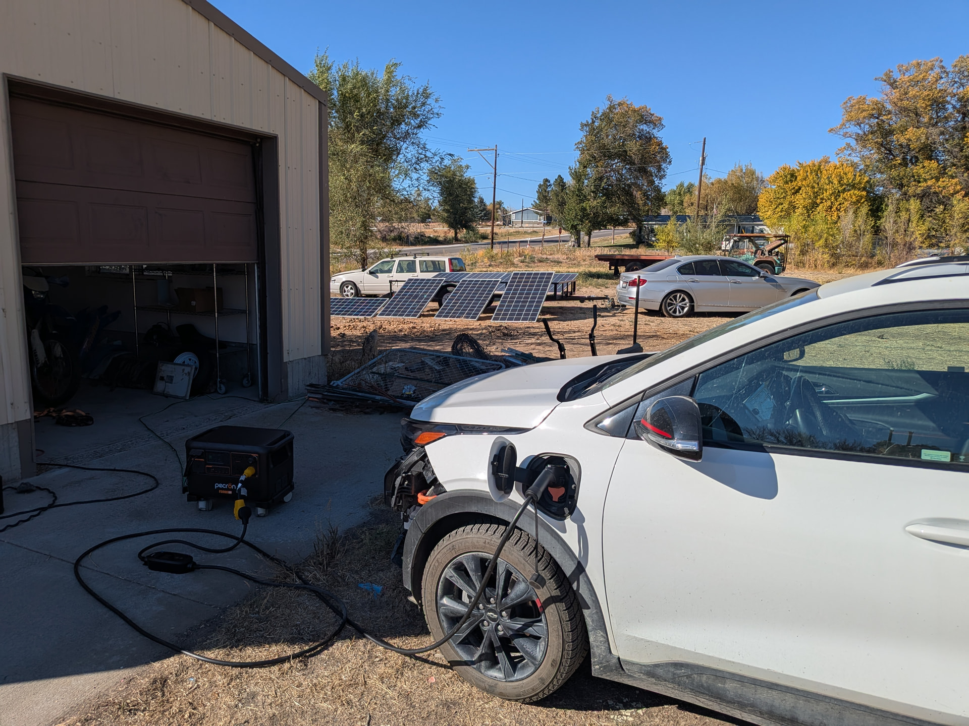

On my solar front, I’m still working out the details. So far I haven’t gone a week without charging from the grid at work, but I feel like I’m close.
I’ve added 2 more panels bring the system spec to 2.6kw, but it feels more like 2kw looking at the power curve.
I also screwed up my power station’s arguments yesterday. I put in “if over 80% then AC power on” then I set the battery to stop charging at 80%… 80% is not more than 80%, so it didn’t turn AC power on, thus no charging for me today.
Averaging 2.7-2.8 miles per kw on my drive to & from work which is about 60miles all at 70mph with my missing bumper. Little research suggests I should get over 3.5 m/kw @ 70 mph, so this missing bumper seems to really hamper efficiency.

Your efficiency will definitely improve with the proper aero. Also the tires really matter for these cars. With the right tires you can get 3.7-4mi/kWh. Also there is a huge delta between 60mph and 70mph if you can stomach it and it’s safe/legal to do so, 60mph is way more efficient. Especially behind an 18 wheeler, lol.

Bolt is going to be charged off solar so even that small power cost goes away.
