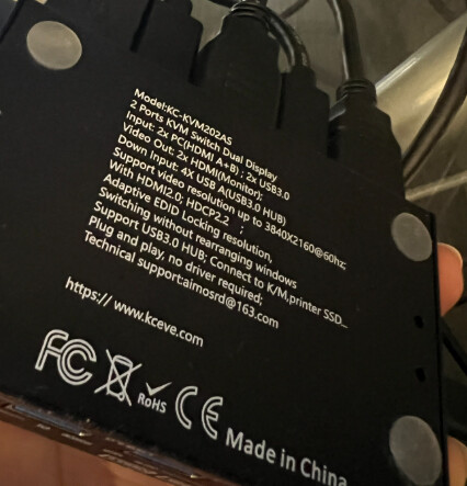

Hi, none of these work for me. I have KVM model 202AS
How can I disable the CTRL hotkey without plugging in the keyboard to the USB port because that doesn’t work either. Please advise because the CTRL hotkey is so annoying I’m considering to stop using the KVM altogether
This is not a model# of anything we sell. What’s your order#? I can look it up.

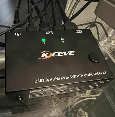

Hi, thank you for the prompt response. This is the item I have
I’m not sure where it’s from because it was provided by work for work. If it’s not your item I may as well just stop using it because I can’t find any information about disabling the hotkeys other than this forum here :slight_smile:
Ah gotcha since this is not our KVM I doubt the hotkeys would be the same. Have you tried their support email?
Otherwise, wanna buy a KVM? :rofl:
Strangely the hotkeys are the same, that’s how I ended up on this forum - double tapping control switches my PC but not the screen, only the keyboard and mouse. Anyway, I guess that’s my problem :smiley:
