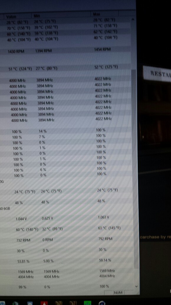

i have tried a hole new psu and a new power plug real temp is showing ok temps the cpu does not get over 60 and the gpu levels out at 85
it happens at least every other match in playerunknow's battlegrounds and happens very quickly in gta i have also got it to happen in the witcher but much less offter so we know its not the psu or temps

-Stress tested extensively (can not narrow down the issue and have not been able to repeat in synthetic benchmarks)
-ran in high performance mode
-there looks to be no over heating issues or I would be able to repeat the issue more consistently
So far I can repeat the issue with in a couple games of player unknown's battlegrounds, gta, and a couple times in the witcher, was unable to repeat in Aida, prim95 unreal valley, superposition, or fire strike.
